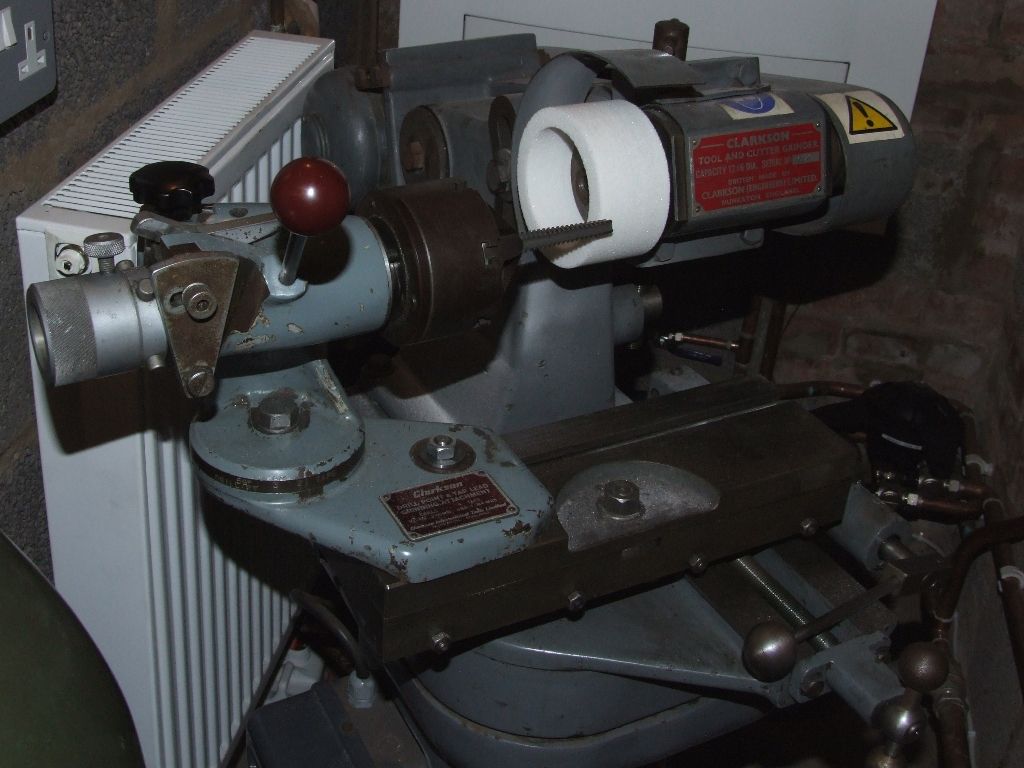

                Made a t-bolt and washer so that I can attach the drill and tap grinding accessory to my T&C grinder, ready to grind the reliefs on the square thread taps I am making. The taps have also been hardened and tempered today, in between gardening.
                Andrew

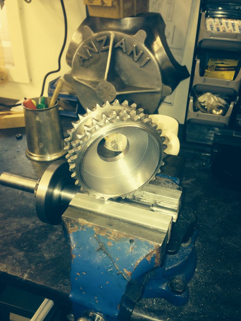

                            Dialled in the camshaft on the Anzani after four year rebuild! This included making replacement mag drive bearing from cast Babett,making replacement rollers for the tappets and making vernier ( well adjustable) cam drive sprocket.
                            The crank case in the back ground is mis leading, it is a replica of the Bleriot engine that crossed the channel.

                              In reality this took place yesterday; I have ground the reliefs on my hardened and tempered square thread taps, using this set up:
                              The first tap took 40 minutes due to general ignorance, as I've never done this before. Having sorted the first tap, the other two took about 10 minutes each.
                              Naturally I tried the taps; they cut a really nice thread in a piece of scrap brass, very little force was needed. It was pleasing to drive the taps using a wrench made by my father during his apprenticeship at RAE Farnborough in the early 1940s.
                              Andrew

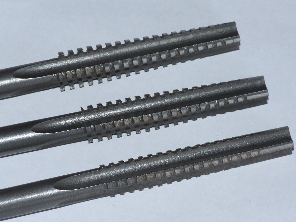

                                Andrew
                                Have you got any close-ups of the taps? You must post some. I expect they will be sickeningly good as ever….

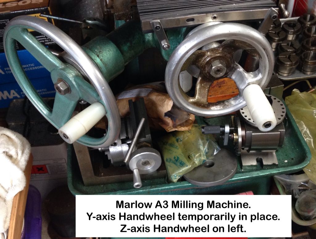

                                  YES YES YES.
                                  As a previous 4 times F1 champion was wont of shouting at the chequered flag.
                                  Thank you JS for repairing my Marlow Handwheel.
                                  Marlo A3 Milling Machine
                                  Just needs a coat of paint to finish.
                                  More photos added to the Album.
                                  Geoff – JS you are a Knight in Shining Armour!

                                    Posted by Muzzer on 11/03/2015 14:49:10:
                                    Here's a picture of the working end of the taps:
                                    Time will tell if they work.
                                    Andrew

                                    Muzzer
                                      @muzzer
                                      Wow, very nice. Now you will have to tell us if they produce nuts that mate with the leadscrew – the acid test. No pressure then!!

                                      Gray62
                                        @gray62
                                        Andrew, those taps look great, how did you flute them, ground, milled or a combination of both?
                                        Need something like this to do the brake gear on my engines

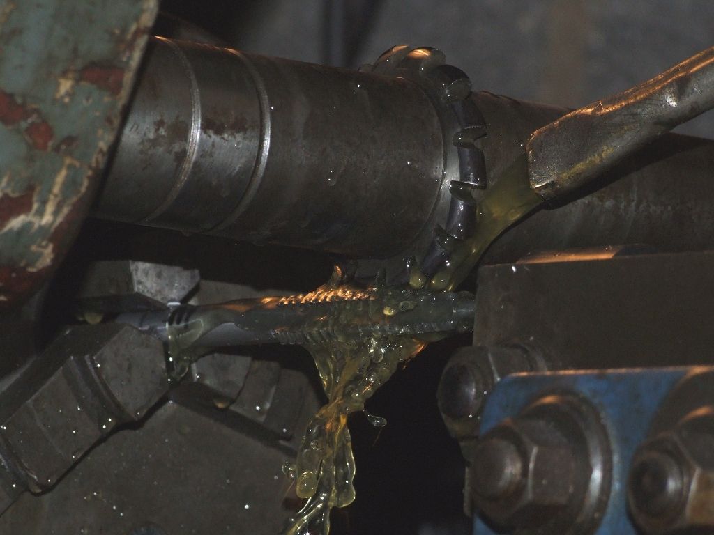

                                          The flutes were milled on a horizontal mill, using a convex cutter:
                                          They could also be done on a vertical mill, with a ball nose cutter, but probably not in one pass, which is why I chose to use the horizontal mill.
                                          As for writing up for MEW that's not my decision; over to our esteemed editor. smile

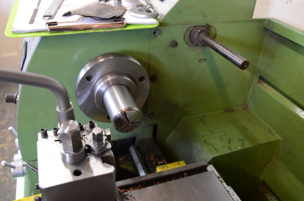

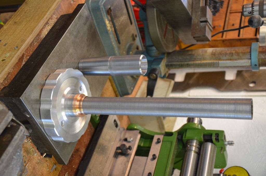

                                              Bought a job lot of C5 collets from e bay so thought I better make use of them, made a spindle nose adaptor and a drawbar for my Warco 290. Could have done with a piece of thick walled tube for the drawbar but would have to have bought 6m so turned it from a piece of 1.5" bar. Lots of swarf! Took a while but finally bored through to 1.06" dia.
                                              2nd photo shows a 1/16 collet in use to turn up some pivots, seems to run within .0005".dsc_1486.jpg
                                              Michael
