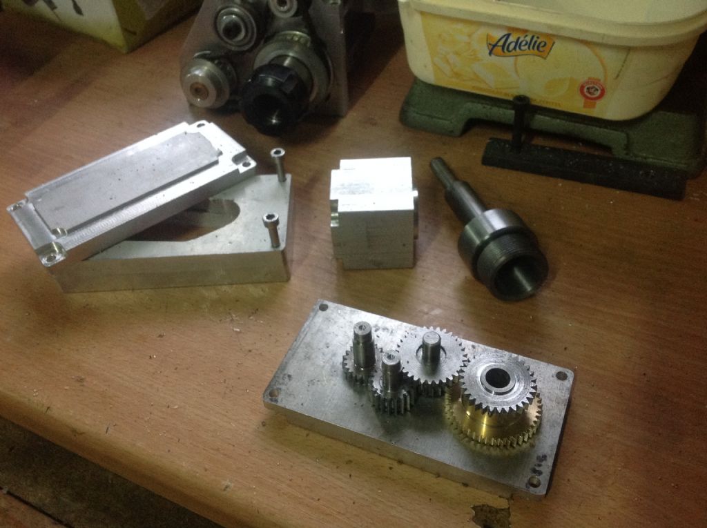

              Things have been a tad slow in the engineering department lately, the last couple of days have been the first time I've been able to get in the workshop (garage) due to low temperatures, but have just completed my first ever session of gear cutting. Glad to say it went quite well. Only made one error, fortunately on a gear blank that I had spare metal for to make a new one.
              The results can be seen below:
              Complete gear train
              And getting ready to knit the whole lot together for a trial assembly.:
              Gathering of the parts.
              I've been putting off the gear cutting, not just because of the cold, but also because I was afraid of making a dog's breakfast of it. Shouldn't have worried, as it happens, it all went quite smoothly for a change. Even the gears mesh OK. It remains to be seen, however, how they stand up to the rigours of power transmission! I seemed to spend as long making arbors to hold the gears as I did doing the actual gear cutting.
              For those interested, the gears are 20, 30 and 40 tooth, Module 1. Cutters were from CTC, mounted on a home-brewed arbor held in an ER32 collet chuck in the mill. Used a six-inch rotary table with tailstock centre for support and indexing plates in place of the handwheel.

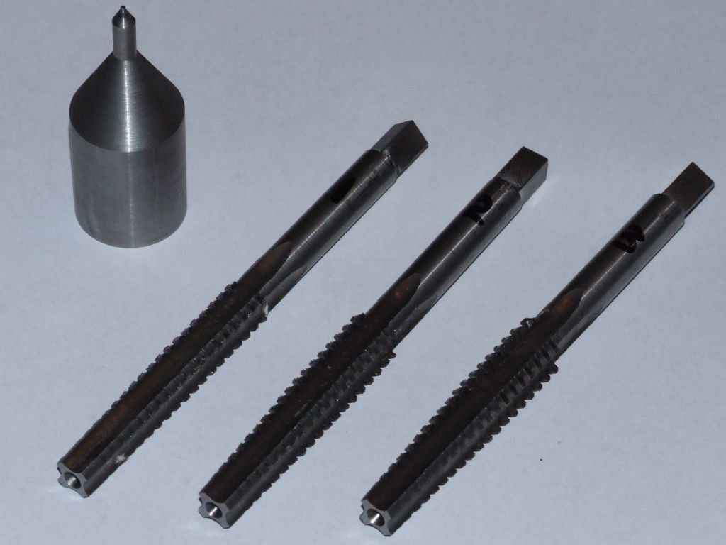

                    Square taps are now fluted and the driving squares machined. I had to make a special tailstock extension for the dividing head so that the milling cutter could go deep enough without chewing up said tailstock:
                    Next stage is to carefully deburr everything and then harden and temper.

                      Andrew,
                      Put rings round the taps at the top 1,2 and 3 to define the order, looks like you have them stamped but a ring is easy to see from an angle.

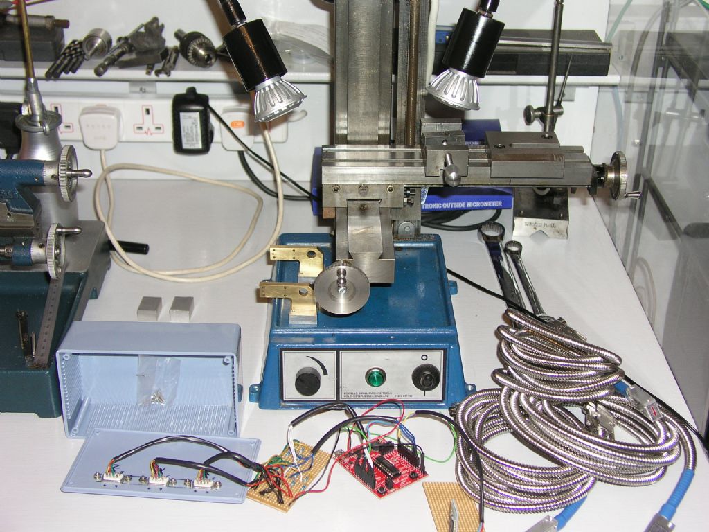

                                Colin Heseltine
                                  @colinheseltine48622

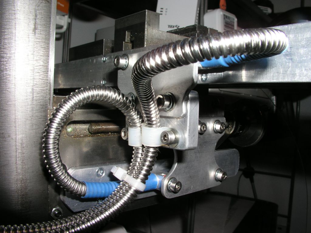

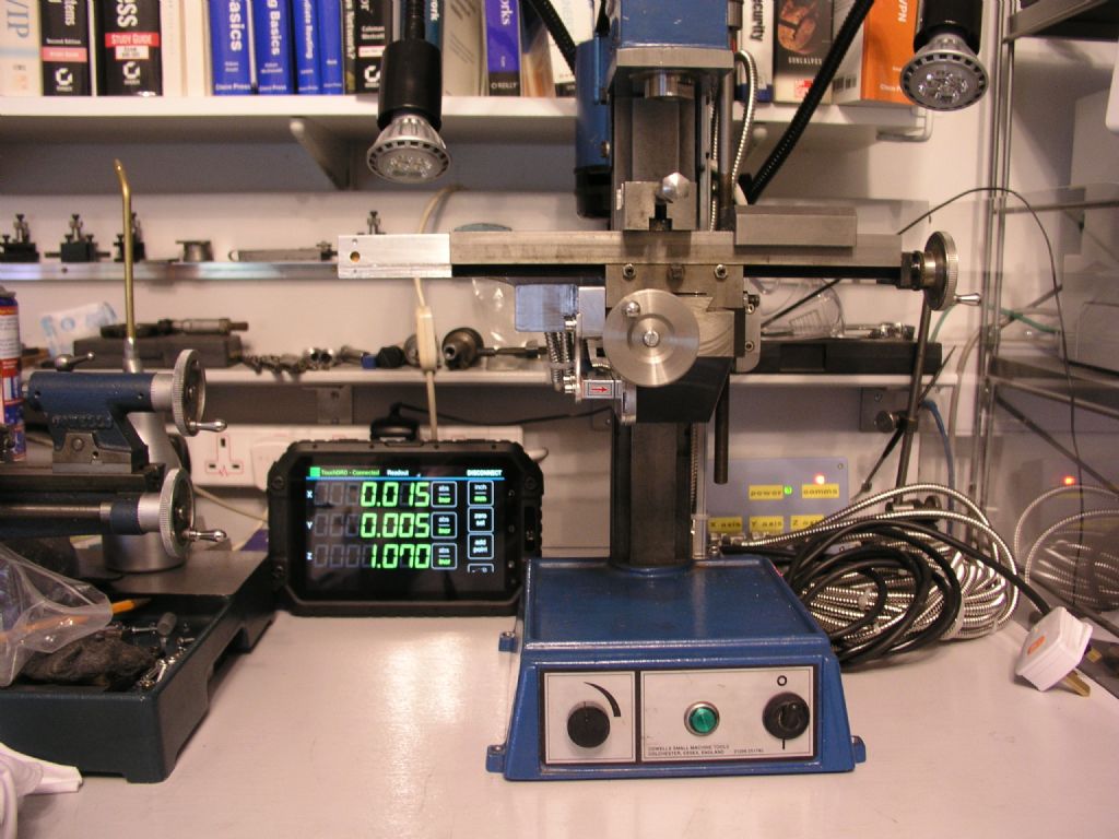

                                  Well Yesterday actually. Completed fitting 3 axis DRO to Cowells Mill. Used the Android TouchDRO App from Yuriy's Toys website and built controller from his plans using Texas Instruments Launchpad MSP430 Processor board. Used 5 micron magnetic readheads from Machine-DRO (no connection just a satisfied customer).
                                  Processor board shown before closed up and mill.
                                  X asnd Y axis read heads mounting bracket
                                  Z Axis Readhead
                                  View from front, tablet can be seen with readout displays and controller box at the right rear of the picture.
                                  p1010049.jpgVery please with the result.smile
                                  Colin

                                      Posted by Colin Heseltine on 02/03/2015 22:38:01:
                                      Well Yesterday actually. Completed fitting 3 axis DRO to Cowells Mill. …
                                      Nicely done, Sir !!
                                      It's good to see an example of a DRO installation on a small machine.
                                      P.S. … There seems to be rather a lot of armoured cable coiled-up behind the machine … What's the story?
                                      Edited By Michael Gilligan on 03/03/2015 07:36:47
                                      #181929
                                        Posted by Michael Gilligan on 03/03/2015 07:36:02:.
                                        Ignore the dumb question blush
                                        I see that the heads come pre-wired with long cables.

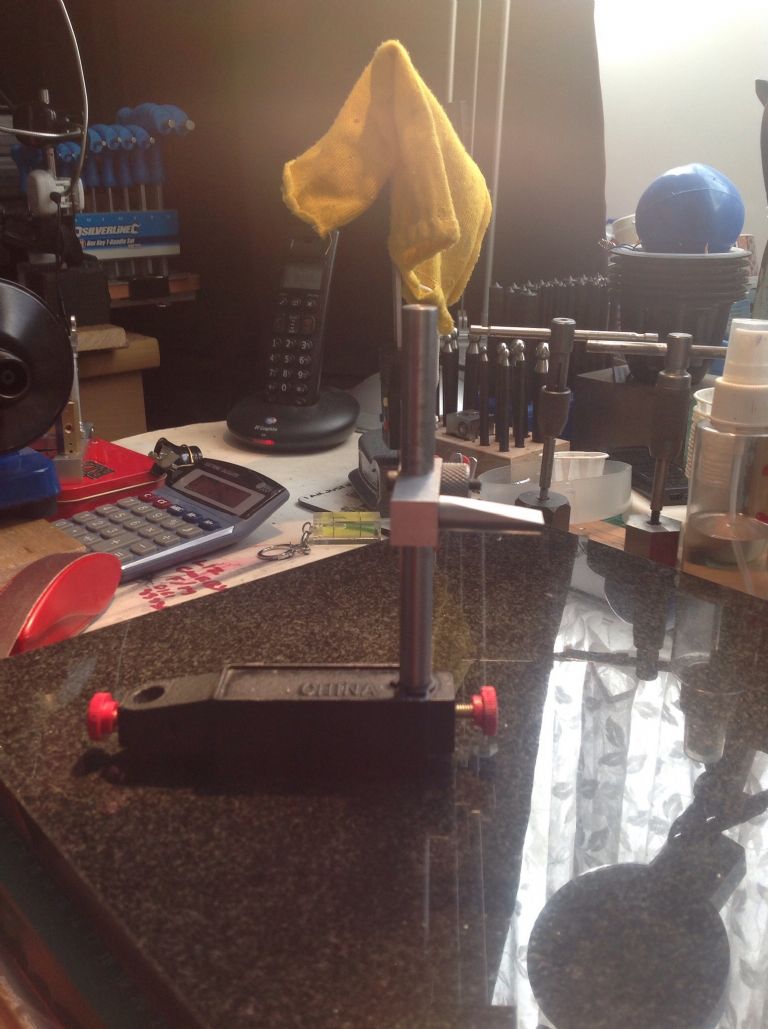

                                              Michael,
                                              Yes your right they do come with long cables. As the controller box communicates via Bluetooth I could move it off the bench and the long cables would come in handy. As its a house mill I am instructed to try and keep the area tidy, even though it is in my office. I was quite pleased with how small I could make the installation. The magnetic strips are only 7mm thick. They are two part and if I had been able to use just the top cover then this would have reduced thickness to 2mm.
                                              Colin
                                              #181949
                                                Thanks forthe extra info, Colin

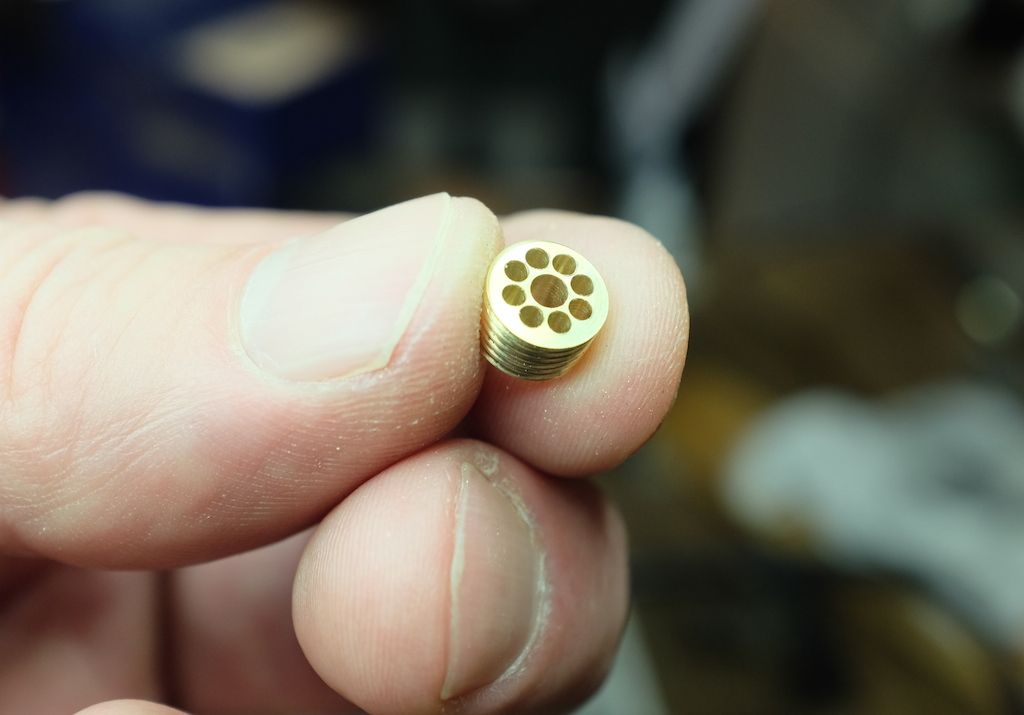

                                                Another JohnS
                                                  @anotherjohns
                                                  Workshop is a mess as it is filled with stuff from other parts of the house, whilst we have workers in redoing floors.
                                                  So, a small job, on the little KX1 CNC mill (controlled by LinuxCNC, not Mach3, not that it matters much)
                                                  Gordon Smith designed safeties, drilling the 8 vent holes without a rotary table. Did about 10 of these; should have been 11, but one moved in my jig. More details in my blog **LINK** as usual.

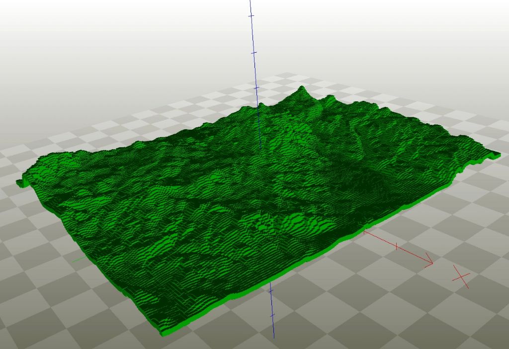

                                                    Here's a funny one. As part of my 'other' existence I produced this relief map of a landscape. This is a pic from an STL viewer. It would be very nice to make a 3D print of it to help me visualise it better.
                                                    By the bye, it's incredible how much OS mapping and other data is available for UK citizens to use FOC, even for commercial purposes – search they 'open Government Licence'.
                                                    This was made using OS data using a free plug-in for the QGIS open-source GIS system.
