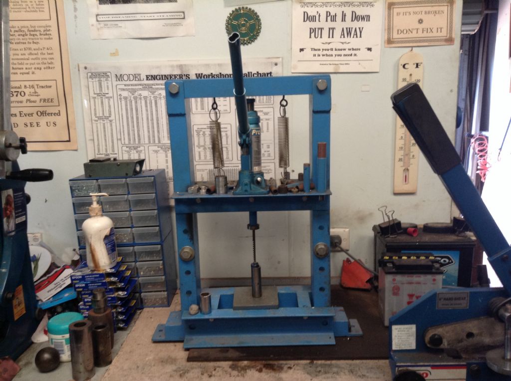

            Nope, this is my 'gentle ' vise. No hammering, chiselling or other rough work. The jaws on this vise are hardened and ground, no grips at all so I can put work in without it marking. Jaws get licked up every few months so they have no marks to transfer to the work.
            If I need to do heavy work I have anvils, hydraulic presses, ratchet presses, hot spanners and another couple of vises I don't care too hoots about.

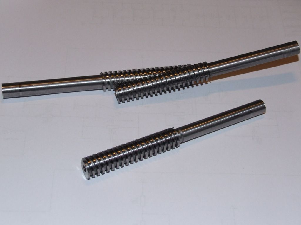

                                      Started roughing out a set of 1/2" diameter 8 tpi square thread taps, in silver steel, by turning the shanks down and screwcutting the threads:
                                      Next jobs are to machine the squares on the shanks, reduce the diameter of two of the taps, machine tapers and then machine the flutes.
                                      The two taps at the back are at a funny angle because the threads are interlocked, thereby proving that the screwcutting tool width must have been exactly half the pitch. thumbs up
                                      Andrew
                                      #181544
                                        thereby proving that the screwcutting tool width must have been no more than half the pitch

                                          Andrew when I did the Fowler brake the build manual suggests stoning a thou or too off the tool before you cut the taps so that they remove a slightly wider form than the brake rod. Gives you that bit of play. Or will you make the nuts first and keep cutting the screw until it fits?

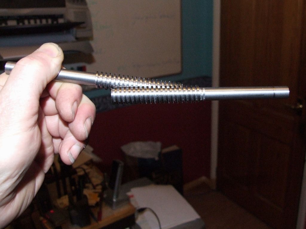

                                              Neil: Shouldn't that be no less than half? If a groove was cut less than half a pitch wide then the other tap wouldn't fit. However, if the tool wasn't exactly half the width I doubt the embryo taps would hold together in mid air like this:
                                              JasonB: I thought about that, but didn't want to fudge around with the tool. So when I made the brake shafts in the week, after I'd cut the thread I advanced the topslide by a couple of thou and recut the thread to widen the groove slightly.

                                                How much oil have you got on the threads to wring them together in that photowink 2
                                                #181585
                                                  Yes, although i didn't realise they were physically locked
                                                  Actually, it must be slightly less than half in order for you to be able to force them together

                                                      Just a smidge of soluble cutting oil.
                                                      Neil: They're not forced together, more of a sliding fit.
