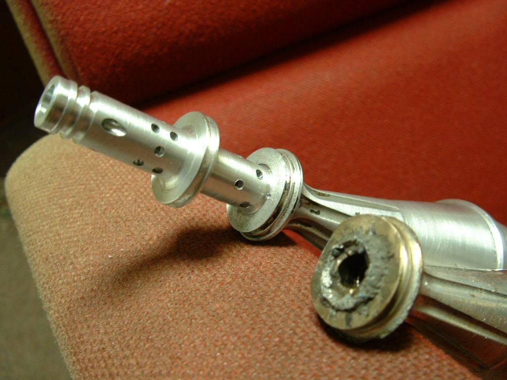

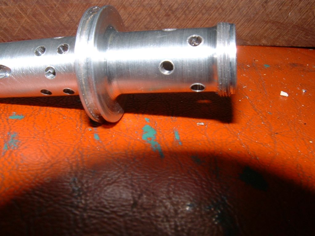

                  Emgee
                    @emgee
                    Not done today but yesterday, used the new internal threading tool to make a thread in the end plate of a model engine tuned pipe. The original stinger had broken and so no place for the silencer can to fit to. The new stinger was made a few days ago ready to fit into the f/m thread.before and after.jpg
                    Video of the boring and threading on Youtube, search for: ukmwg

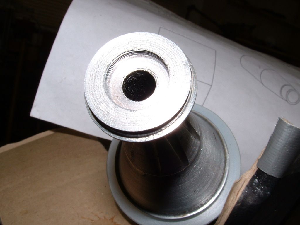

                                  This is not in the 'Workshop Progress' thread because it isn't progress, but several steps backwards. I spent part of yesterday making some cutting tools from silver steel and also made most of the re-designed water pump valve body for my traction engine. Just one thread to screwcut this morning, and it went pear-shaped. crying 2 Here's the scrap part and the tool made for undercutting the internal wing valve seat:
                                  And worse I live in a dog-owning area, so no cats to kick.
                                  Andrew
                                  #213640
                                    Is it still serviceable Andrew, may be OK once screwed into a hole or with a nut on the thread

                                          Probably yes if I clean up the BSP thread. And it's on the underside of the water pump and will have a gland nut on it. But I'm not happy with it and feel I can, and should, do better so in the bin it will go.

                                              Build it up with weld and recut the thread
