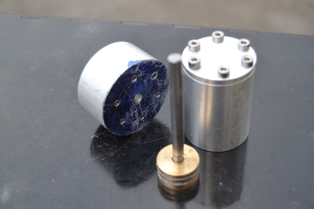

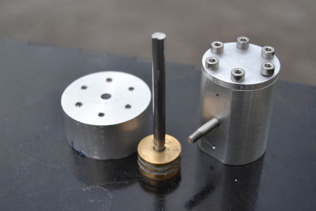

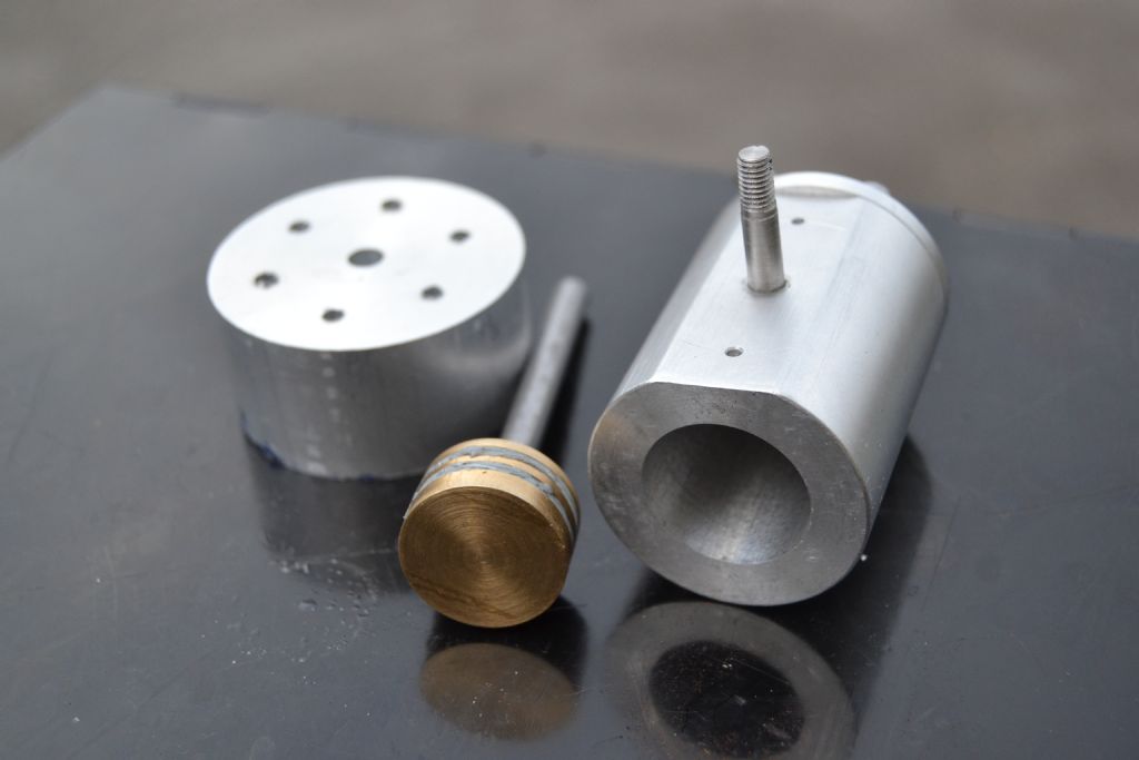

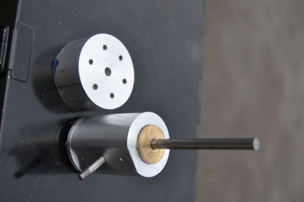

                                      Although my main build at the moment is the 'Potty mill' engine I have been building a simple double acting wobbler as a bit of fun and hopefully fairly easier for a beginner to build.
                                      I'm intending to build a simple boiler shortly so wanted a slightly bigger than average wobbler to test it out – this will be no monster but it will be double acting and be 24mm bore – approx. 30mm stroke.
                                      I've ringed the piston with PTFE tape and it has a good reassuring feel to it – the aluminium disc with holes will be the piston rod end cover and I'll pack that out with PTFE also.
                                      The piston rod at the moment is a temporary one – I have a silver steel rod to make a proper one once I have the cylinder end cover made and reamed.
                                      Ultimately it's intended the cylinder will operate vertically with the flywheel above and I'm building it in such a way that I'll be able to make it a twin cylinder if it turns out ok.wobbler (1).jpg

                                      #206504

                                                  Hi Roy,
                                                  I'm glad of the advice to be honest.
                                                  I just happened to have a piece of silver steel laid around that is of the right size so I had thought it would be ok but I'm open to suggestions, I can get a piece of stainless if that will do a better job.
                                                  I had intended to make a brass gland and pack it with PTFE so I'd like something that will operate smoothly through the packing and give a good seal.
                                                  Peter.
                                                  #206528
                                                    Silver steel tends to rust very easily so it won't be operating smoothly for long, 303 stainless should do the job.
                                                    #206530
                                                    Gas_mantle.
                                                      @gas_mantle
                                                      Ah ok thanks, I didn't realise that.
                                                      Stainless steel it is then
