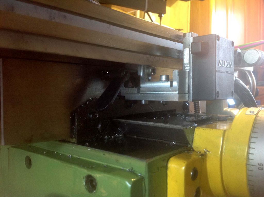

                                            If I may briefly drag this back to its title subject……….
                                            Today, I finished (well nearly) the installation of the X-axis scale on the VMC mill acquired recently. It took a lot longer than I had hoped but as I was designing it "on-the -fly", I don't think it turned out too badly. Made a couple of silly errors and had to remake a couple of parts as a consequence. As it turns out, I could have done with the DRO! I've just got to radius the ends of the limit bar and then move on to the Y-axis. That looks considerably easier and I think I will use a similar arrangement to limit the travel on this one, too.
                                            x-axis scale 1
                                            Above: General view of the installation.
                                            Below: Poorly shot photo of the read head mounting and brackets supporting the power feed limit switch and travel stop. (No flash on the iPad.)
                                            read head mounting and limit switch
                                            One down – two to go.

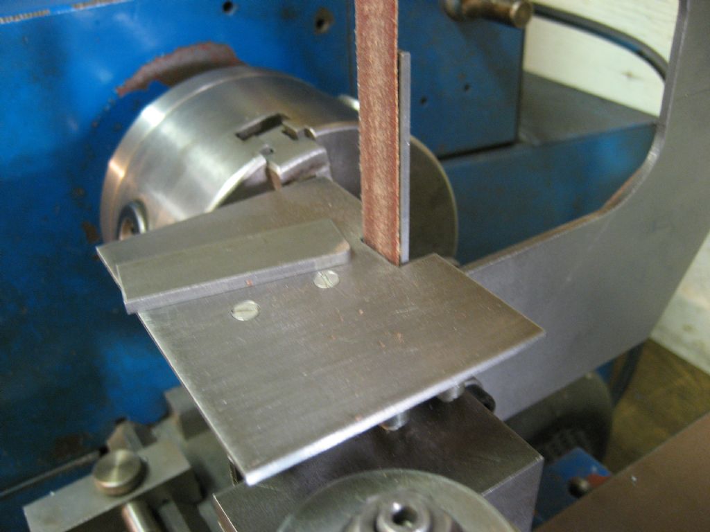

                                              Hello Folks
                                              Today I finished my latest project – a mini belt sander – made as an attachment tool for my bench lathe.
                                              Lathe attachment belt sander

                                                    Hi Morgans,
                                                    A nice looking belt sander. Just make sure that the ways and slides on your lathe are protected when you use it. The dust produced will contain small amounts of grinding grit which could damage sliding surfaces.
