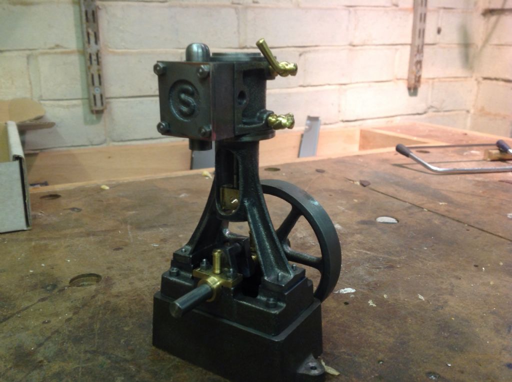

                                Well, the day started off well with a visit to Ellenroad Engine House **LINK** to see what inspired me to have a go at making steam engines.
                                Then after dinner (lunch if you're posh) I started a trial assembly of the S50 I'm trying to make, in order to check alignment of cylinder, crosshead, conrod and crank and then spot through the cylinder mounting holes. I used a clamp to hold the cylinder on the bed while adjusting the position. All was going well, clearances and fit of parts seemed acceptable (to my untrained eye), engine turned over with no binding or slackness. I needed to move the clamp to one side so I could get at the holes from underneath so I decided to clamp it at the end of the cylinder next to the slidebars. Unfortunately this meant that when I tightened the clamp it bent the piston rod. First part I've messed up. I imagine others have had bigger disasters though. At least it is a simple part to remake. Surprisingly demoralising though.
                                Gary
                                #145746
                                NJH
                                  @njh
                                  Hi Gary
                                  I feel your pain! I HATE remaking parts. As you say not so bad if it is a simple part but even then I kick myself for rushing or not thinking through the process sufficiently. ( It had nothing to do with the lunch I suppose? disgust )
                                  Norman
                                  #145757
                                  GaryM
                                    @garym
                                    I doubt it Norman, it was a cheese butty. wink
                                    I usually get accused of thinking too much. That's why it takes me so long to make any progress. I'll look on it as an opportunity to make it better than the first time. I think it was annoying because I thought I was pretty close to trying the engine on compressed air for the first time.
                                    Gary

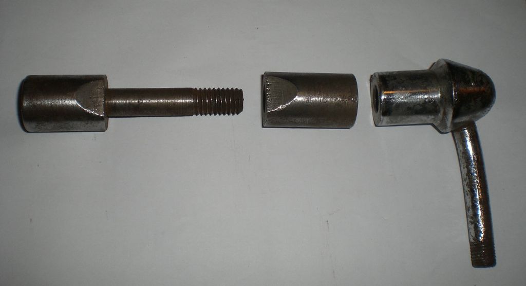

                                      Hi John
                                      I like this idea and want to do it to my minilathe. Is the clamp on an excentric?
                                      Cheers Michael
                                      #145793
                                        Michael if you look at the first picture you can see the clamp barrel inside the hole which has a scallop out of it to match the hole. As the orange handle is tightened it pulls the brass barrel to one side and locks the spindle.
                                        J
                                        #145796
                                        Gray62
                                          @gray62
                                          John has told me the brass clamp does not give sufficient locking force without tightening really hard and suggested a steel rather than brass clamp. I'm doing the same on my warco gh1330 and im going to try a split brass cotter first as I'm not keen on the idea of a steel against steel clamp.

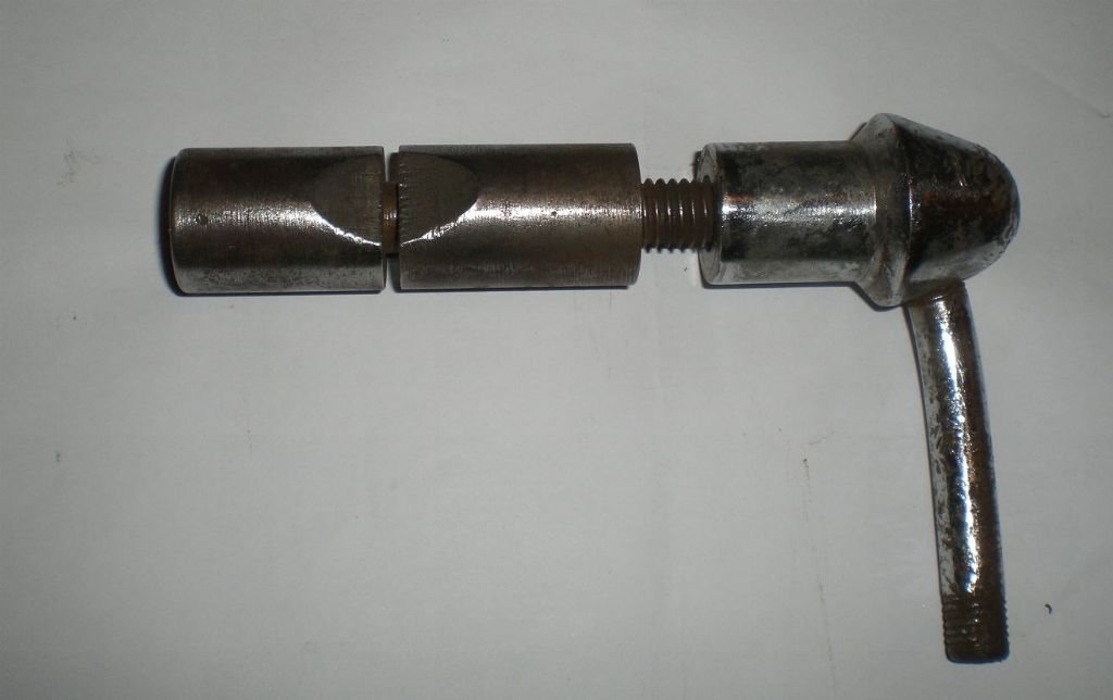

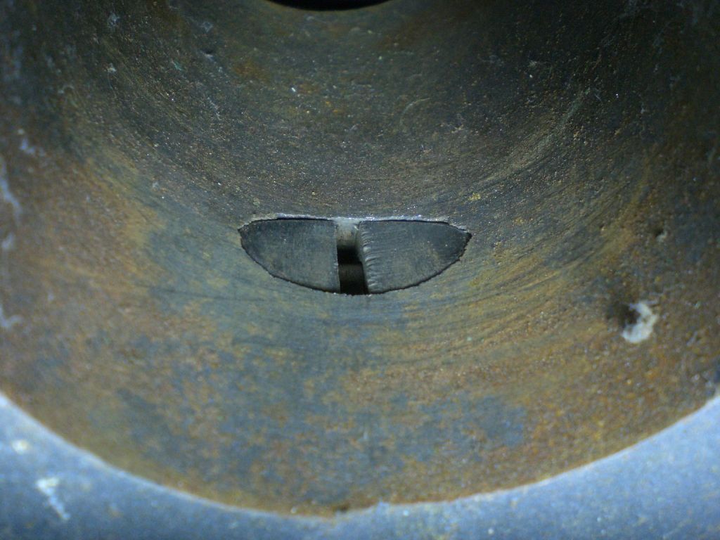

                                                  Hi, well you could always make the arrangement like the one that is on a piller drill head that I have stripped down at the moment. See bolow.
                                                  The nut only nips the two halves together and not on the frame of the drill head and will therefore nip the piller into a central position in the driil head.
                                                  Below is a view inside the drill head where the piller is nipped by the two halves. These types usually grip very well.
                                                  Regards Nick.

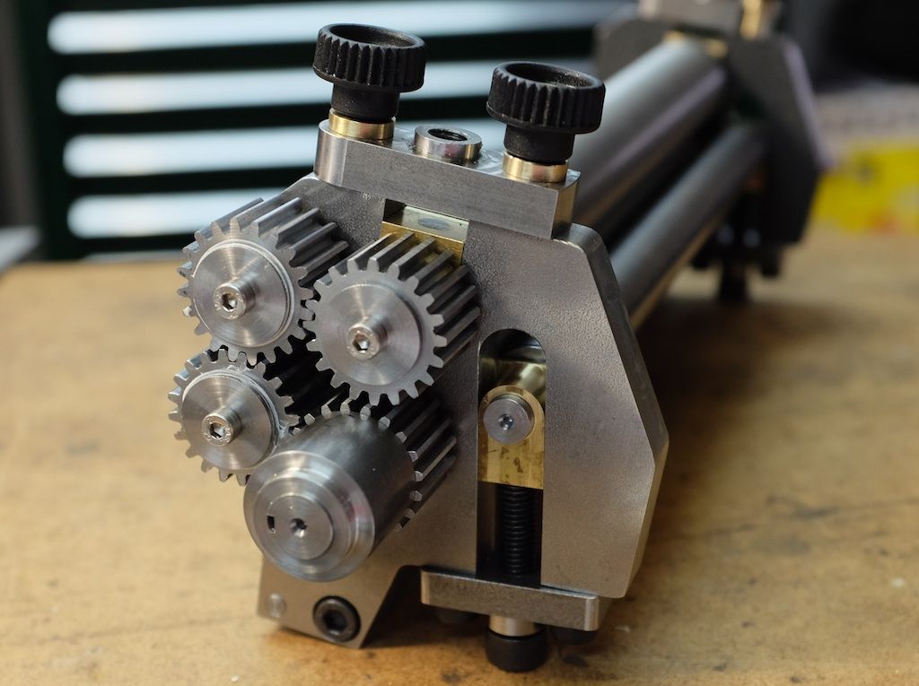

                                                    Pretty much finished up my Thomas/Hemingway Rolls kit.
                                                    Lots of fun. Waiting for Loctite, a broach, and some more Arc adjustable handles – all should be in this week.
                                                    More on CNCing part of the construction on my blog:
                                                    **LINK**
                                                    Now, back to the Ivatt…

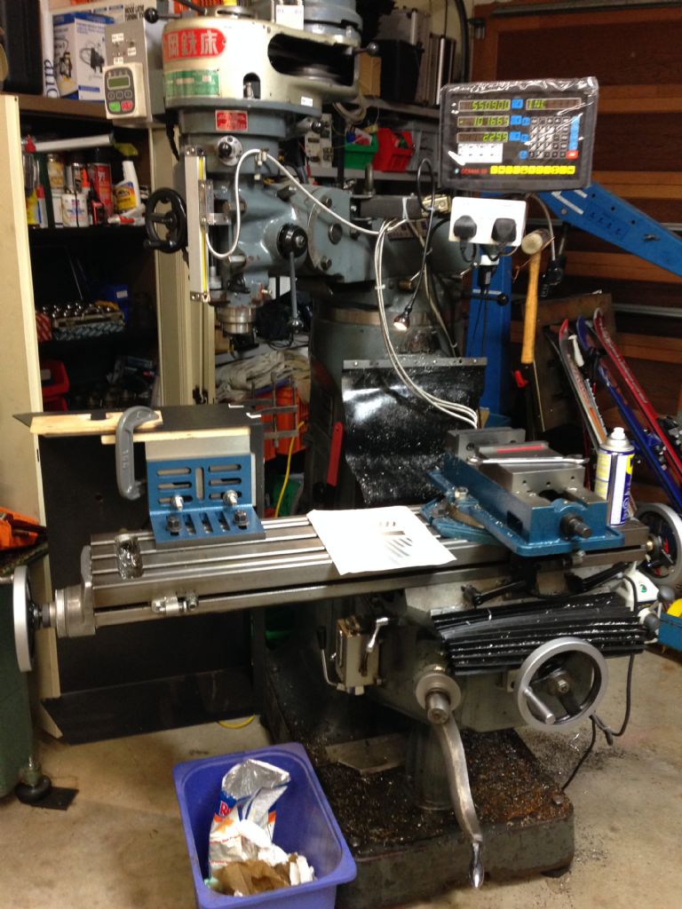

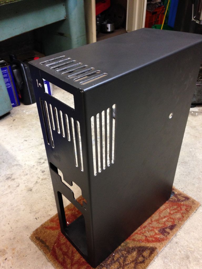

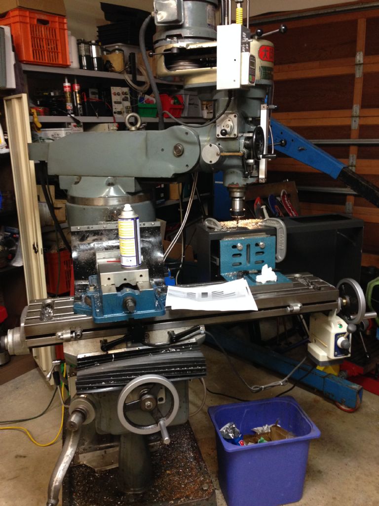

                                                      Tonight's challenge – add some 10mm ventillation obrounds to the lid of a steel battery cassette for a fork lift. 21 of them of various lengths from 60 to 160mm on 3 different faces. The lid measures about 60 x 50 x 20cm. In production, these would takes seconds on a CNC punch but I don't have one of these and it's already been folded anyway.
                                                      So the Blidgeport went in for a bit of serious yoga. Couple of angle plates, cassette hanging of the back of one side of the table then the other, table and ram fully extended, turret swiveled right then left. Being sheet metal (1/8", it was never going to be possible to clamp it rigidly, even without the various overhangs. Pretty noisy business, lasting just over 2 hours, a lot of it setting up. And thank god for power feed.
                                                      Stretch to the right….
                                                      …and stretch to the left….
                                                      Stretch to the left
                                                      Done now, including deburring. Managed not to ding the carbide slot drill and it's still cutting nicely.
                                                      Finished
                                                      Not the most fun I've had in an evening but a reasonable result given the circumstances.
