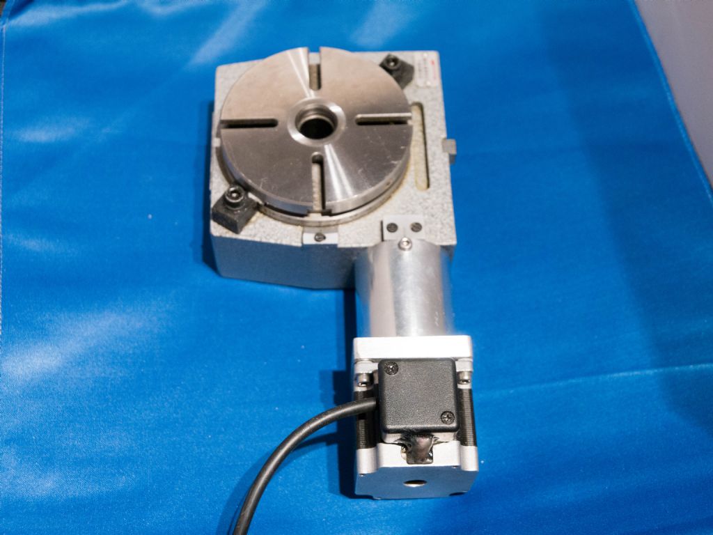

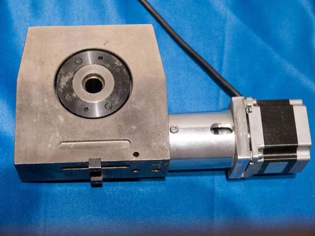

                                    Completed my motorised Rotary Table, RT from Amadeal ( after a little kerfuffle over specs).
                                    Nice table though, quite compact compared to some and very smooth manual operation, worm gear runs in oil bath.
                                    Metal bits and Nema 23 stepper motor from eBay.
                                    Controller bits from designer/eBay and was very easy to build and worked first time.
                                    Controller is very well written up on a CNC forum and via designers web page.
                                    some photos:-

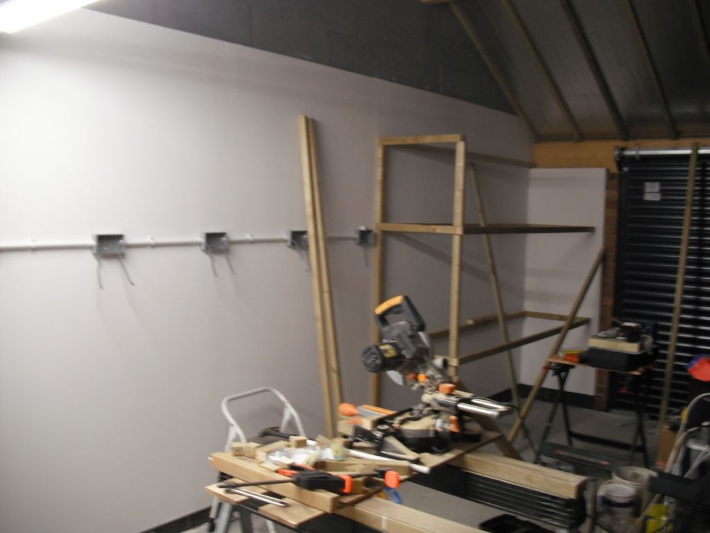

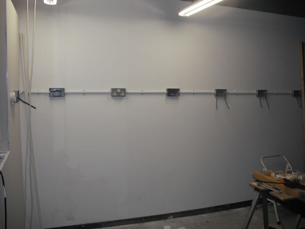

                                            Not really today as there is a lot to do but made a start on fitting out the workshop/garage.
                                            When can you have too many sockets, so far aim is a dozen doubles but I may add some more, 8 doubles along the wall where bench and milling machines will go.
                                            Need to add some storage so in the process of making up some racking at main door end 7ft x 2ft x 7ft high, bet it does not all fit or at least overflows inside 6 months ho hum
