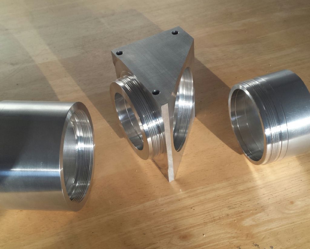

                                              Today I did a bit more on the underwater optical elbow that started off as a 3.5" aluminium cube by cutting the male and female threads in two faces at 45 degrees to each other.
                                              Three M6 tapped holes in two opposing faces allow the work to be removed and replaced (and located accurately) from the brackets attached to the lathe faceplate.
                                              Once all the internal shape has been completed I will mount the job on threaded mandrels (seen in the picture) so that all the external excess material can be turned and milled off.

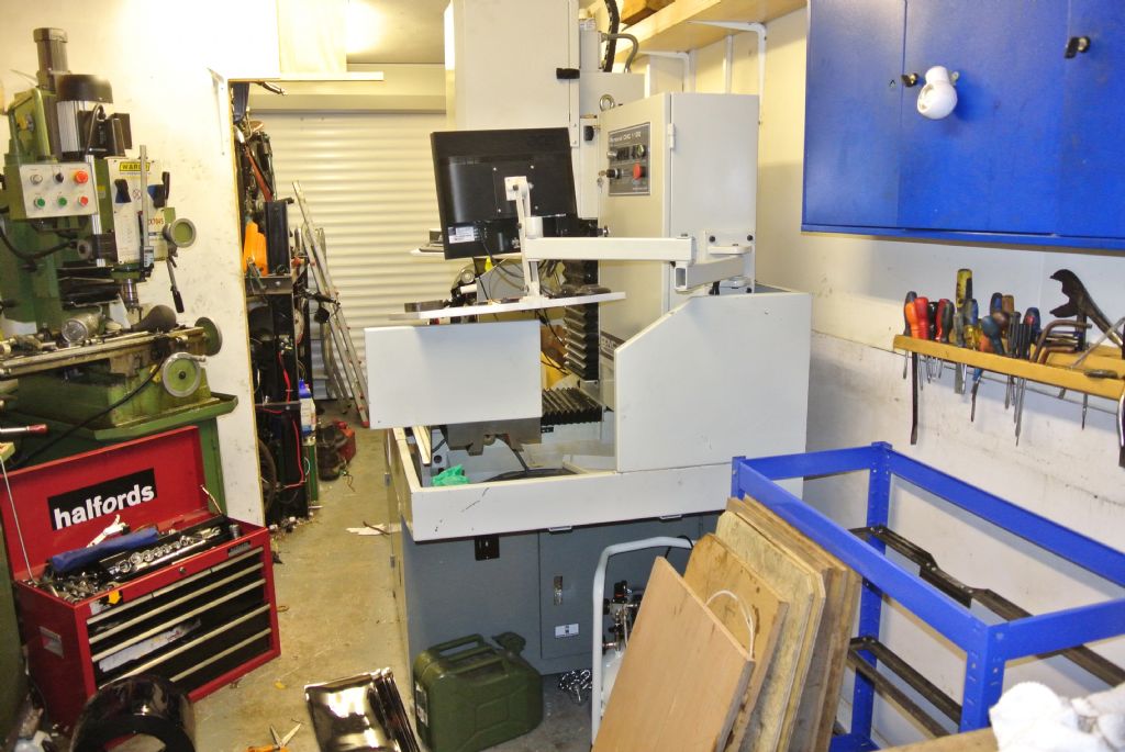

                                                Here are some pictures of the mayhem created by trying to find space for all of my machinery after importing a Tormach PCNC 1100 Mill. i finished putting up the curtain door in the "Dirty End" of the workshop tonight.

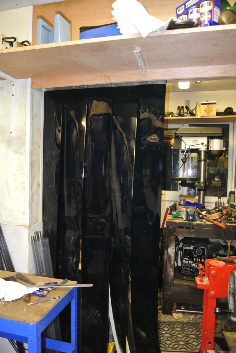

                                                It's an Easy job, just a case of cutting the strips off a roll, pop riveting the hanger plate and backing plate onto one end then hanging on the rail. This should keep the dirt from cutting grinding and welding in the far end of the shop. You can also see some of the shelving I have put up, The shelves are due to be completely reorganised and all of the kit for welding operations will be stored in the appropriate end of the shop.
                                                As you can see I am trying to cram a quart into a pint pot. For those interested the bikes are, left Velocette Thruxtonised Venom, BSA RGS A-10 Lookalike under bike storage lift and on top of the lift is my 1927 Humber side valve. There also lurks a 1929 Humber 350 OHV and a BSA DBD 34 Gold Star.
                                                Here's another view down the machine shop area showing the Warco Manual mill, Warco BH 600 Lathe and the Myford MG-12 Cylindrical grinder. The latter is a three phase machine and I use a rotary inverter to run it, this is visible above the grinder. The bench drill has been relegated to the dirty end of the workshop and is visible in the distance.

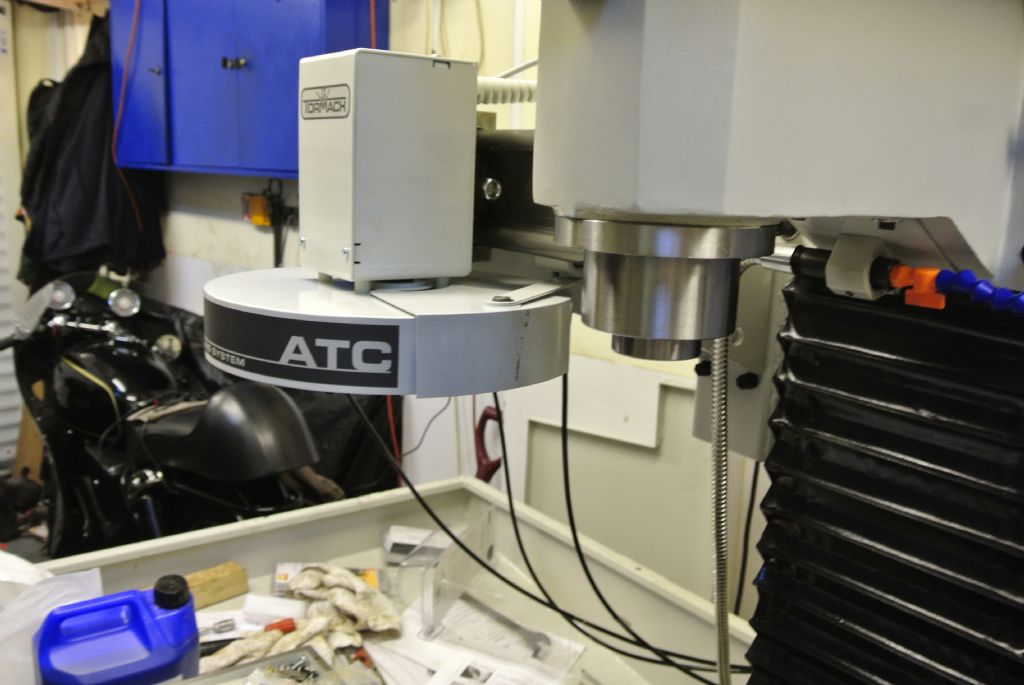

                                                The Tormach with ATC, as you can see, apart from running a test programme I haven't used it in anger yet.

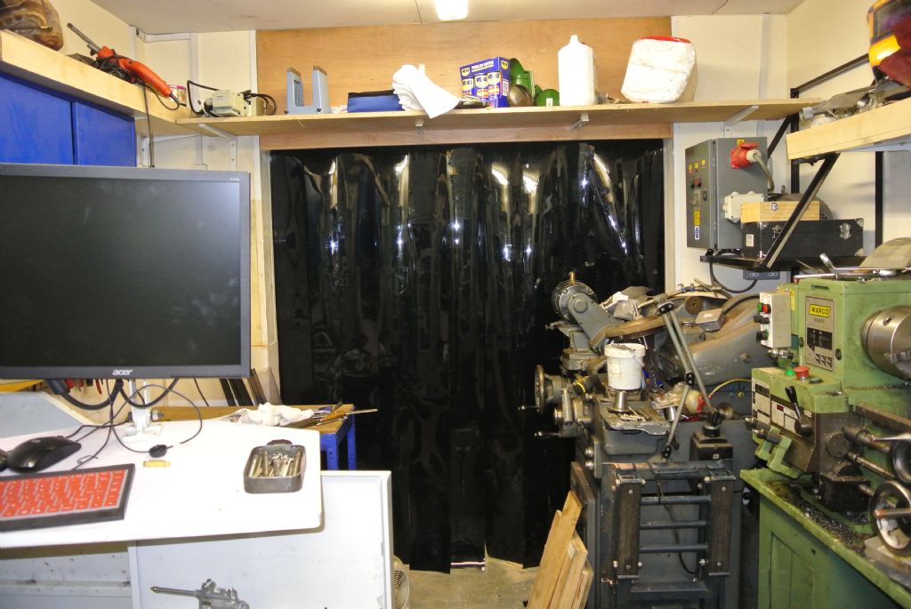

                                                Another view showing the Tormach mill and the Warco manual mill.
                                                The space created for the Mini Lathe,Tool & Cutter grinder and the bench drill.
                                                The completed Curtain Door. I was amazed at how much the heat is held in by the curtain, while putting it up I had a small fan heater running just to keep the chill off me but very shortly after I got all of the strips hung I had to turn it off.
                                                I hate to think how hot it will get in there when I am doing any big brazing jobs.

                                                  Bob,
                                                  +1 on the curtain doors. I have a long thin shop that is divided into two and a quarter bits by existing walls.
                                                  Doorways have been knocked thru and like you I have a dirty part on one end for metal storage and welding.
                                                  The short quarter bit is just a bit of an office / electronics's section and houses the laser cutter.
                                                  I have put a curtain door in between these two sections as there is no point in heating the metal storage.
                                                  I made mine out of a roll of DPC membrane that you lay on double brick walls for a damp proof course. I think a decent sized roll of this was under a tenner.
                                                  Just screwed a wooden strip batten up above the doorway and stapled this onto the batten. In summer I just roll it round a length of broom handle from the bottom and tie it up.
                                                  As you say works wonders with the heat in that if I'm in the cold end and walk thru when the wood stove is on it hits you as you pass thru the strips.

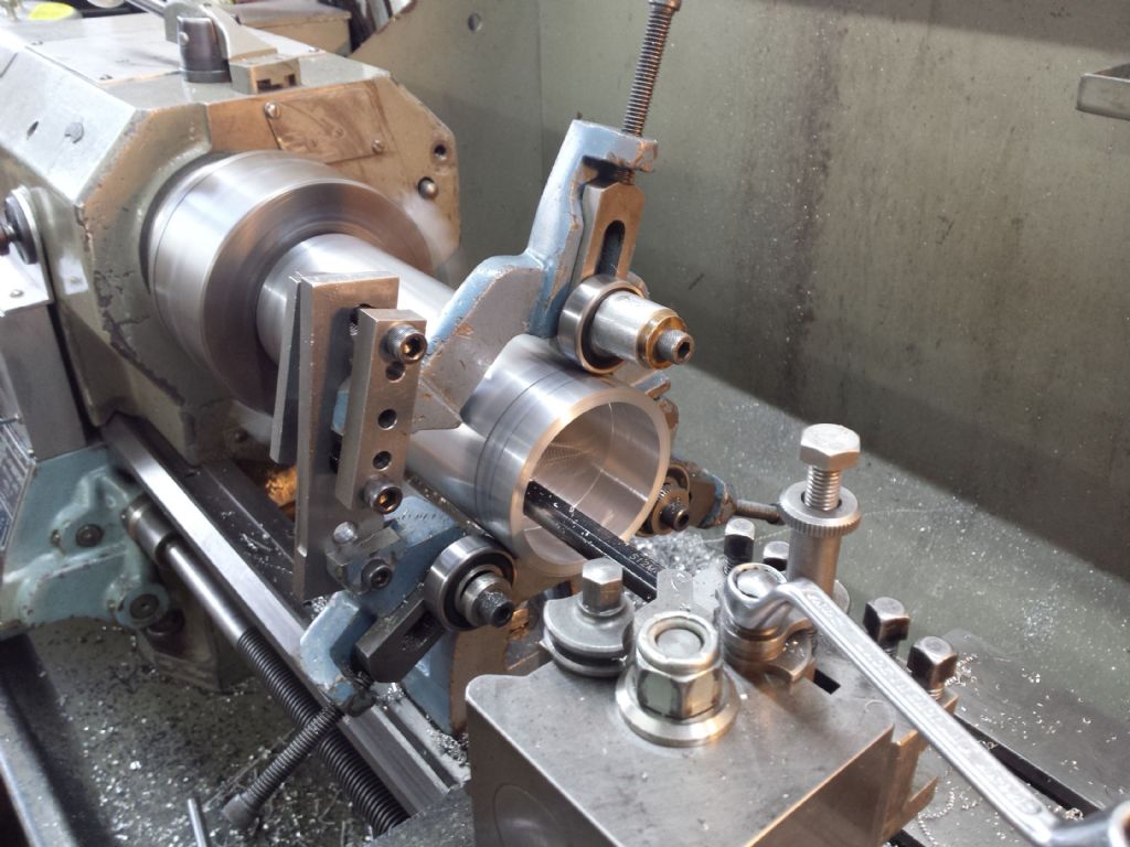

                                                    Some time ago there was a thread about lathe fixed steadies which is really where I should have posted this, but I cannot find it now. Not strictly what I did today because it was actually yesterday, however…
                                                    I needed to reduce the 1/4" wall thickness (to 5mm) of some 3" OD aluminium tube, I'm not sure whether 3" will fit in a standard Boxford steady but my lathe is a 5" and the steady I got with the lathe is for a 4.5" so I resorted to the above arrangement.
                                                    The lash-up clamp on the left it so hold the top half of the steady at the position it has to be to clear the tube. Ballraces from the scrapbox are just manually adjusted and clamped with the original fingers just acting as spacers.
                                                    The tube is 200mm long and I was able to bore slightly over half way from each end and I was able to finish up with an almost invisible joint mid way.
                                                      Well that's the most expensive storage unit I've ever seen
