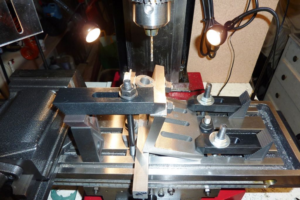

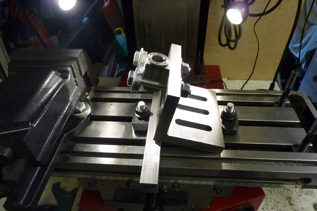

        I came up with a ridiculously (to me) complicated arrangement to drill the steam passage on the S50 cylinder at an angle. According to Tubal Cain's article, that I'm following, the angle is about 14 degrees. So, not having an angle vice, I clamped the cylinder on an angle plate and rested this on a piece of 3/4" square bar that was clamped 3" from where the angle plate touched the table giving an angle of 14 degrees. Was quite pleased with the result although I haven't taken a pic of it.
        Before the final clamps were fitted.

        Final arrangement of clamps

          Hi Gary,
          I still have the jig I made for my Stuart 10V.. it's a piece of wood with a 90-degree notch cut out of it at the appropriate angle
          This is one job where the cheap and cheerful angle vices everyone sells come into their own. I always eyeball the path of the drill before commiting – I haven't gone wrong, yet…

            With you there Neil.
            Every steam passage I've drilled has been done on the drilling machine, the angle gauged using Mk.1 eyeball and a normal vice to hold the cylinder blocks.
            Quick and easy.
