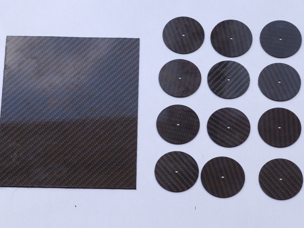

      After lunch I made twelve 48mm diameter discs from carbon fibre sheet. These are for our two seat glider, to help attach the new cockpit trim, replacing that which was attacked by mice a couple of winters ago.
