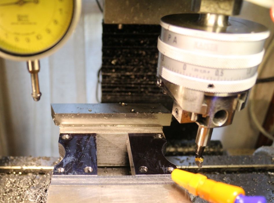

      George>>
      I very much like your version of soft jaws. I've a mind to copy your idea if you don't mind. What's the AF dimension of that hex ally?>>
      I am on jaws today but of a different sort. Just finished boring the scallops in the partially machined upper and lower jaws of my calliper knurling tool based on the Graham Meek version. Grahams excellent article on this tool was published in the November edition of Engineering in Miniature – thanks G.>>
      As I already had a couple of "QUICK" knurling wheels complete with hardened and ground mounting flanges I am first going to try mounting them on the side of the jaws rather than inboard as Graham has done. If this does not give the desired results then it will be a simple job to modify the jaw tips so as to bring the knurl wheels nearer to the centre line of the tool. We shall see! >>

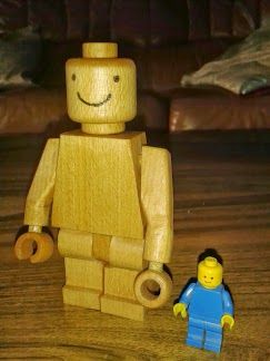

          Finished off a 3 times full sized copy of a Lego Man – as requested by my 7 year old grandson. I don't think Lego bosses will chase me as they are not for sale.

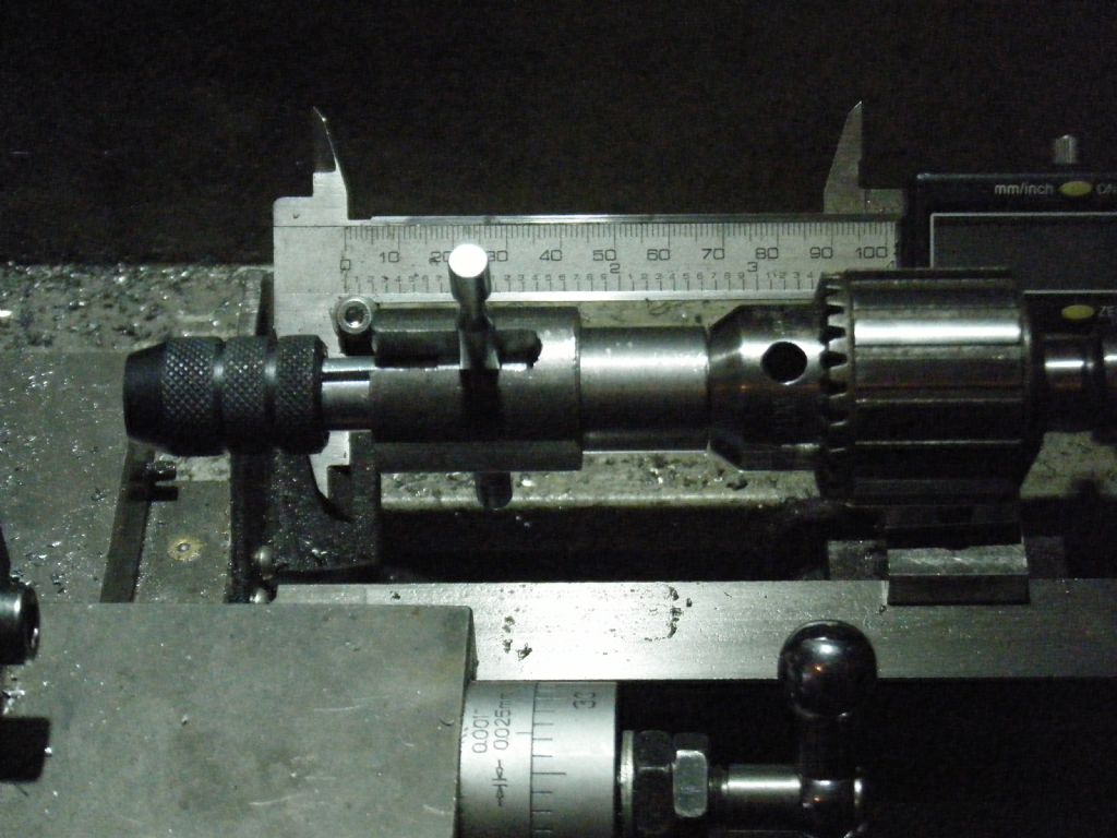

              Built myself a tap wrench driver because my tailstock one I bought didn't cover all the sizes of my taps. I bought the tap wrench for £3.60 so wasn't going to make that.
              Cheers Michael

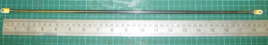

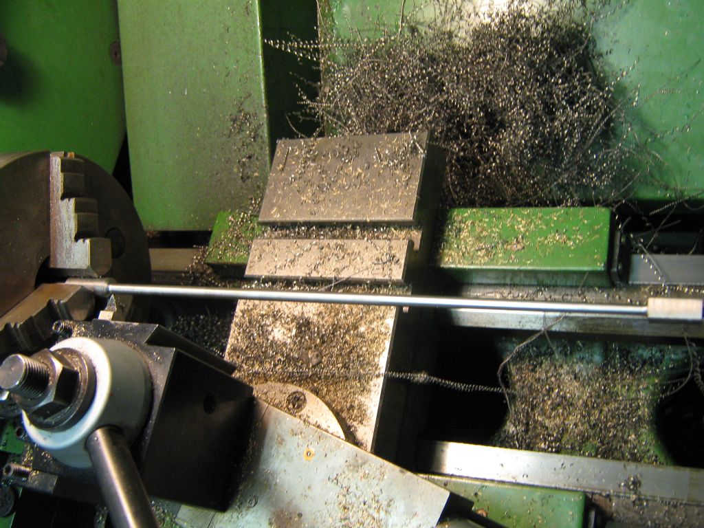

                                Extreme slender turning today as I made my 3" Allchin regulator reach rod in one piece.
                                Material En57T

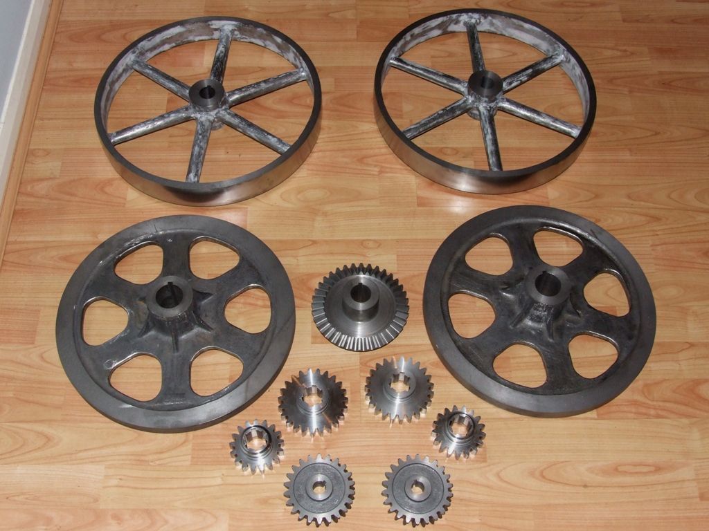

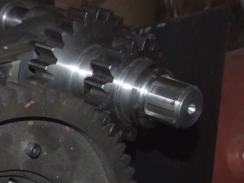

                                        This afternoon I cut keyways in the parts in this picture:
                                        Why is the bevel gear the odd one out? Because I'm making an extra set of bevel gears and a differential centre for a friend, who is building the same basic engine. I cut the keyways in my bevel gears some months ago. I also finished hand fitting the crankshaft gears. Here is a close up of the gears in situ:
                                        The 'rust' spots on the pinion gears are a trick of the light. The 'rust' spots on the gear bottom left are …. rust. sad
