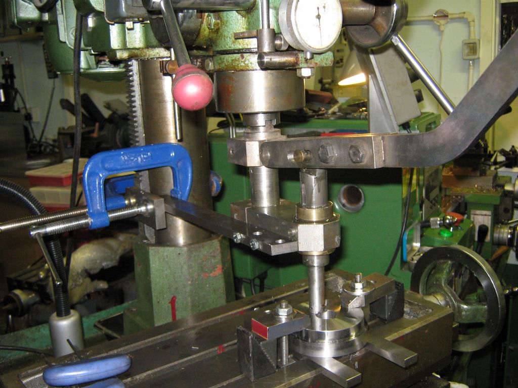

        Today cut 6mm keyways in En24T bead roller dies, here's my set up which is similar to one I saw in MEW or ME many years ago, it's surprisingly robust and works very well, very happy with the result.
        HobbyNut – thanks for your suggestion, the frame is very stiff so I think would it would be worth a try.

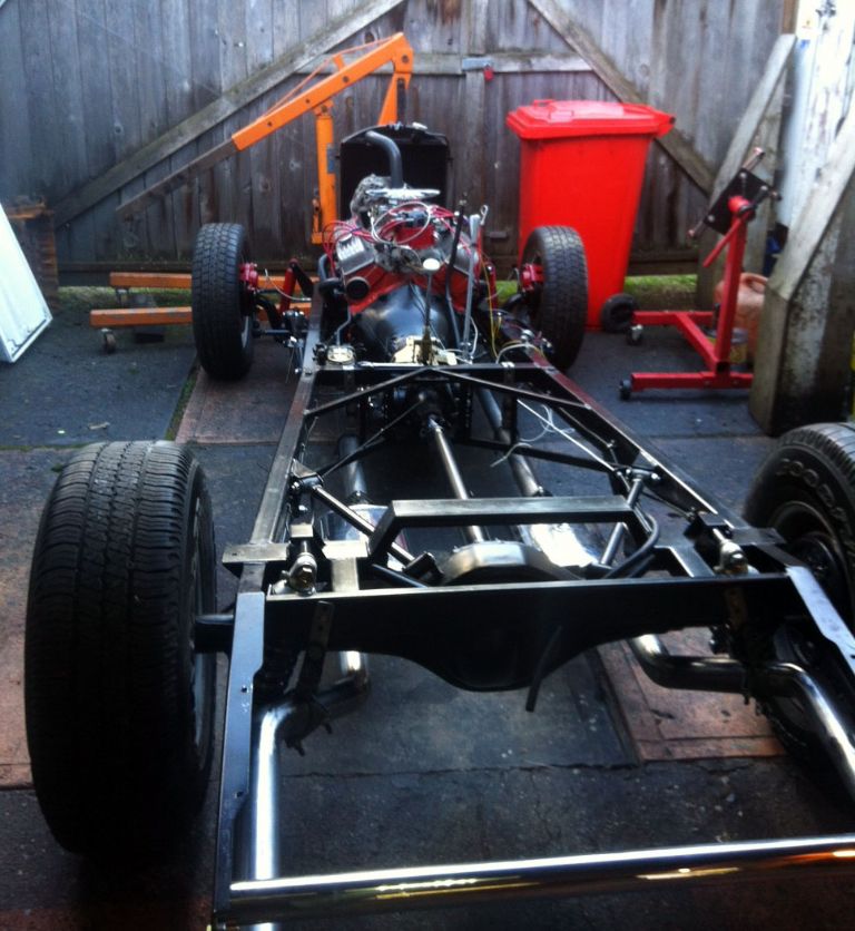

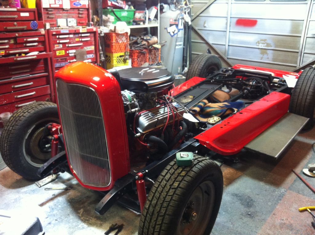

          chassis.jpgThis is what I have been up to the last few months.first stage of assy.jpg

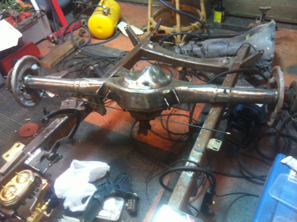

            The Ford Diff was shortened by 37mm each side, it is a 9" with 3.55 gears.

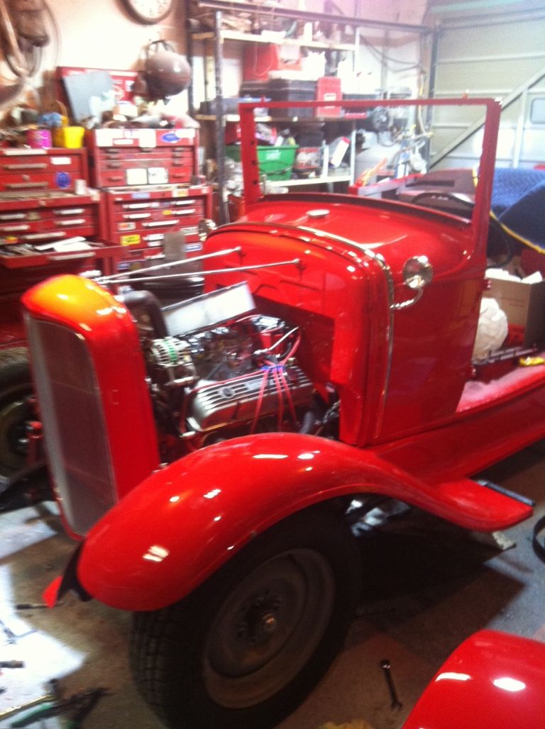

            This is how the car looked at 9.00pm last night. The body came back from the paint shop at midday yesterday. I have to get this finished so I can get back to smaller engineering projects!!

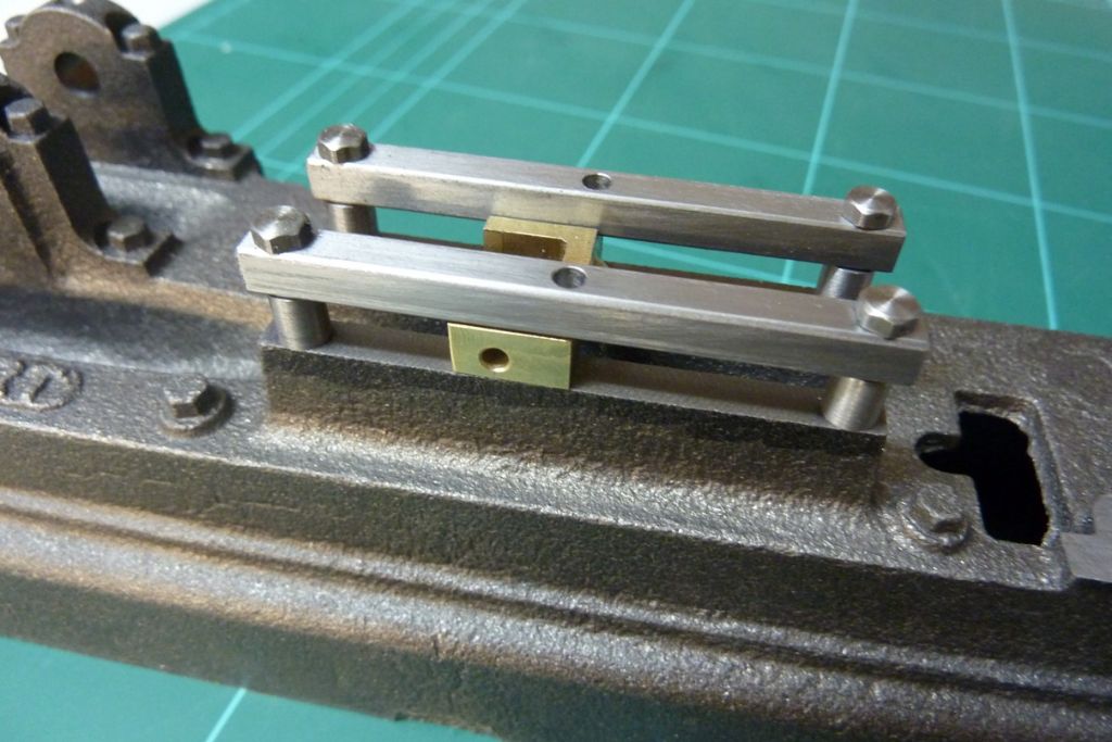

                Drilled and tapped the base casting of the S50 for the slidebars. Only a simple job to most of you but it took me all afternoon, most of which was lining it up on the mill.

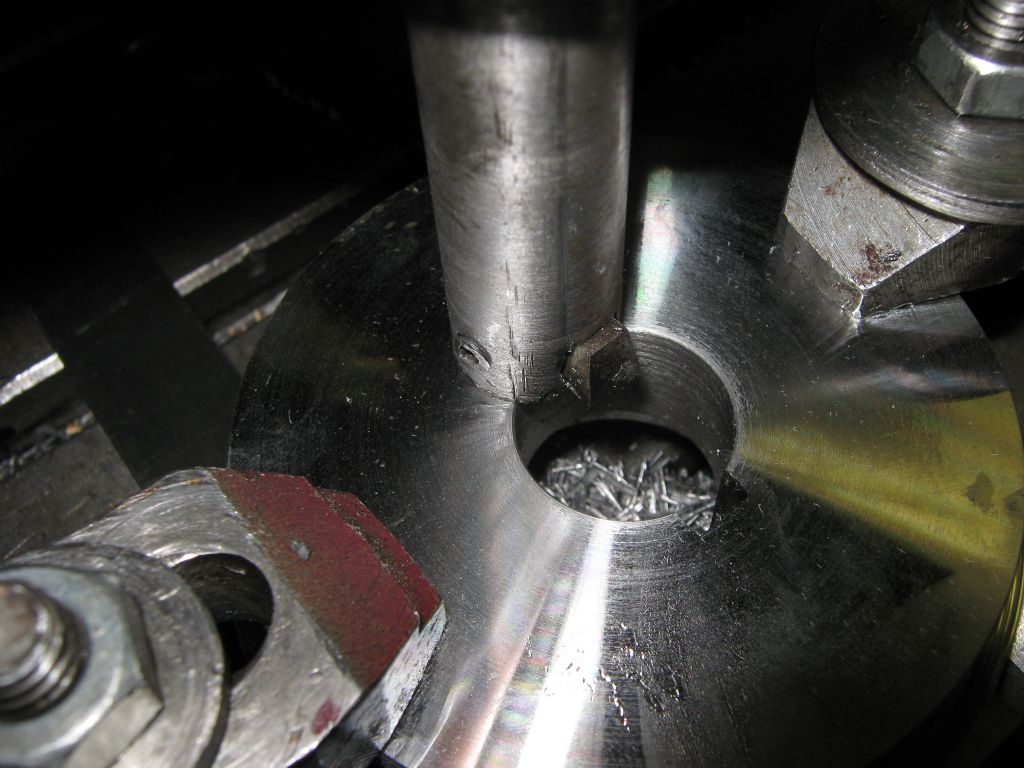

                        Drilled a few 1/4" holes
                        Then said the magic words and the waste material dropped out

                                "Then said the magic words and the waste material dropped out"
                                Sure Jason, you want to share those words?cheeky
                                #141582
                                  "Hacksaw, Hacksaw, Hacksaw, Hacksaw" wink 2
                                  Thats all it took, 4 quick cuts through the last 0.010" where the last holes were left just clear of the vice jaws and they did actually just come away.
                                  I use a 1/4" split point stub drill and 2 1/2" turns of the handwheel (0.25&quot to space the holes.
                                  Now if like some members on here I had a water jet cutter at my disposal I may have done it differently.thinking
                                  J
