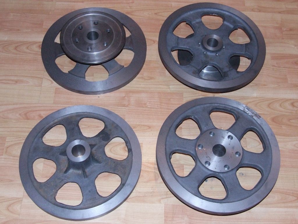

      Due to the wind and rain it meant no gardening or flying this weekend, so workshop time instead. I finished machining the final drive gears and winding drums for my traction engines:
      I just need to fettle the unmachined parts (I know I should have done that first), cut a couple of keyways and then cut all the gear teeth. Also had a massive clear up of the lathe, mill and floor after turning these gear blanks and the flywheels. I've now got a bucket full (literally) of cast iron swarf.

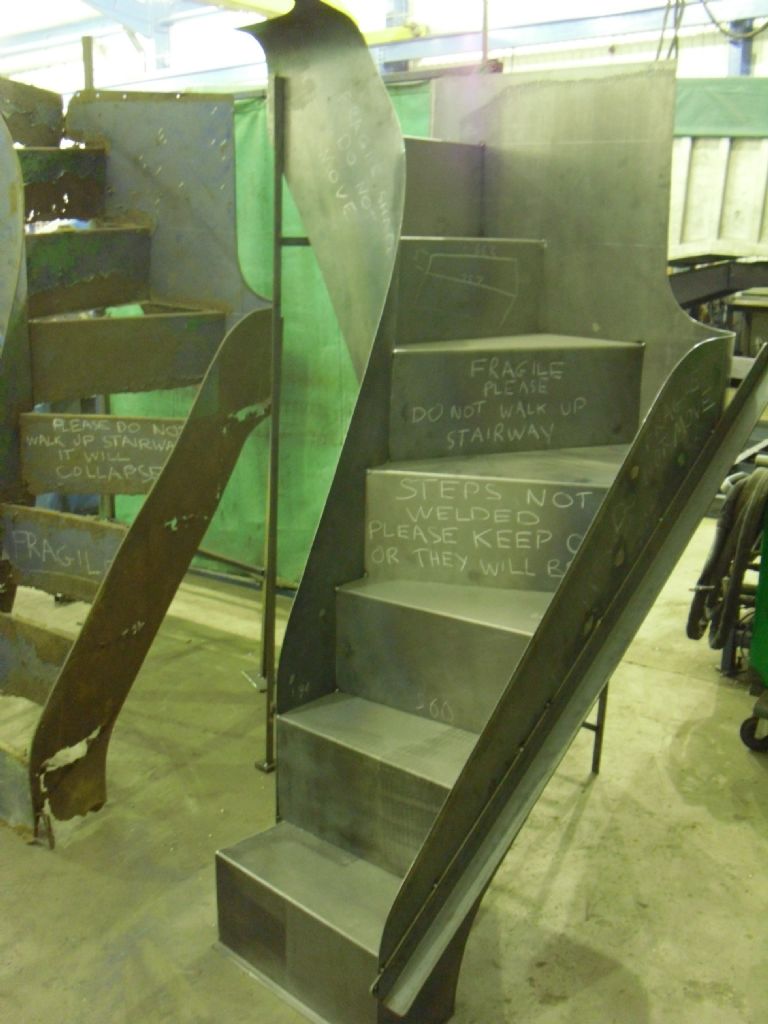

        I have been making a new stairway for a 1946 A.E.C. Bus for a customer at work, copying the rotten original.

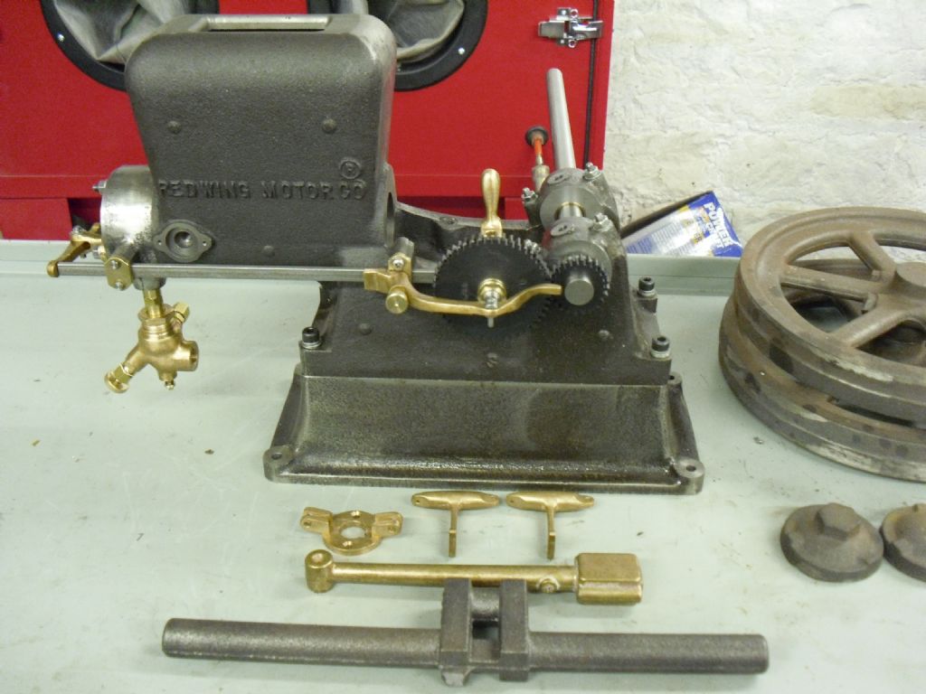

        And at last got a bit of spare time from working to do a bit more to the Red Wing engine.Progress, but slow.001.jpge.

          Stairway to heaven
          Sounds like nice work if you can get it – and a nice piece of work at the end too!

            The old one looks more holy! Ian S C

              Hi Lathejack, you should get a bit of rise by the time you weld the top step.
              Nice job.

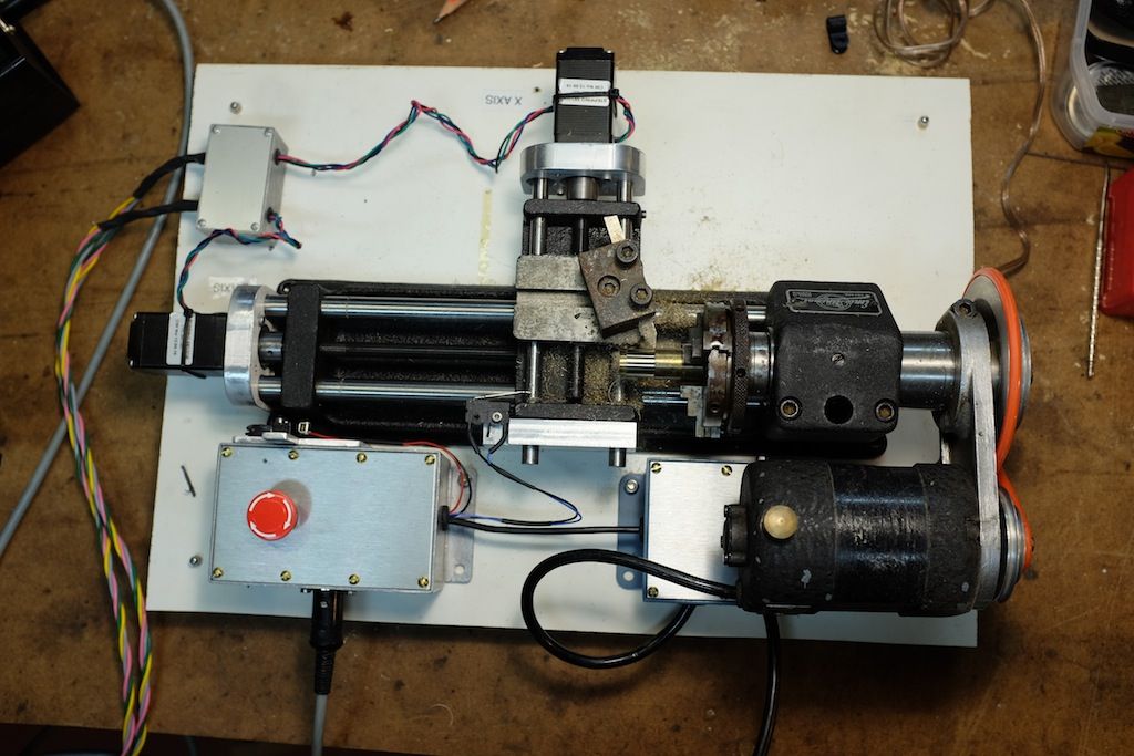

                      Put some pics of my lathe on my blog;
                      **LINK**
                      here's one of the lathe from my newly created album on this site:
                      I'm still excited like a kid with this CNC stuff – hopefully it'll never become "old hat".

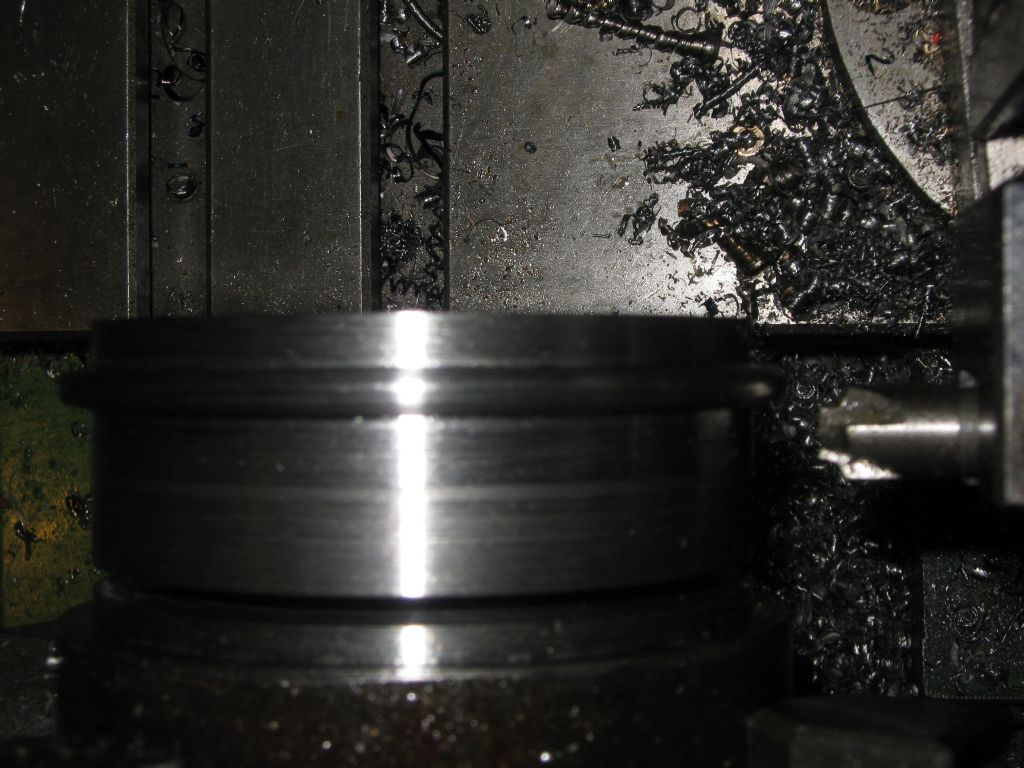

                              Over the weekend I have bored out the bearing housings on the Monitor, started with drills then a single ended bar held in the chuck and the final cuts were done with a between ctrs bar.
                              The casting is too narrow to allow for the crank and bearing flanges so I back cut the sides to account for some of the flange width. Luckily there is an access cover on one side which allowed the tool to be adjusted within the crankcase
                              I then turned the outside of the liner which had previously been roughed out, the slight differences on the surface are due to the middle being wasted for clearance and the top end being 0.004" larger than the bottom

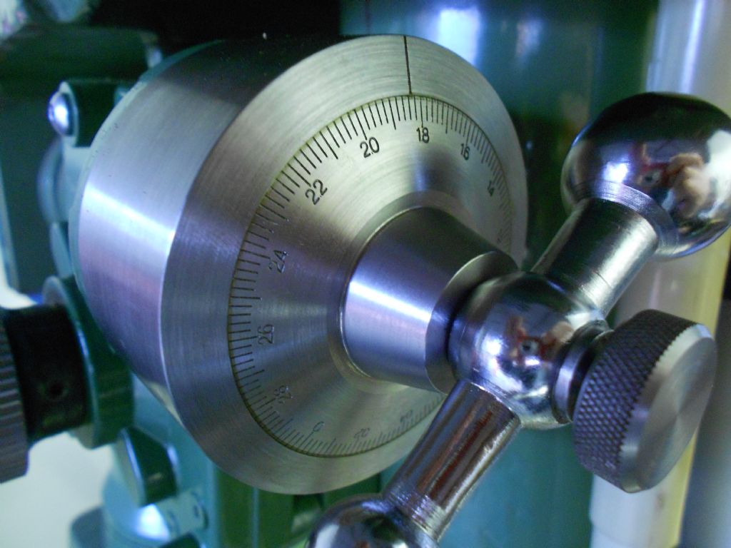

                                    I finished adding a fine feed to the quill on my Myford VMC milling machine.
                                    No more nudging the knee to get the right dimension and far nicer to use with a boring head.
                                    A few more pictures are in the album showing the general arrangement.
                                    Martin.

                                        Lovely dial Martin.

                                          Cheers Neil.
                                          I looked at the Mini-Lathe hand wheel you made based on Graham Meek's design and you've spurred me on to do the same with my Mini-Lathe and also my Harrison – when time permits.

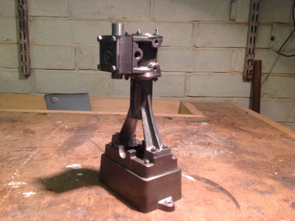

                                                  image.jpgI got a bit further with my 10V. Nearly finished the castings.

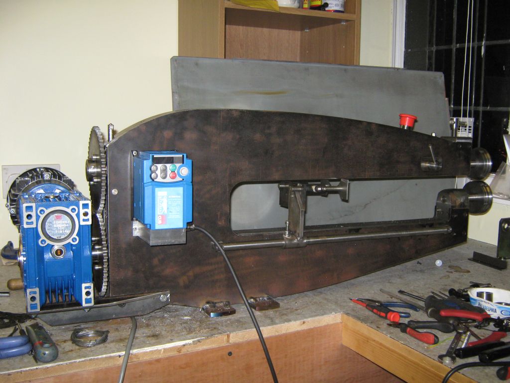

                                                      Not model engineering nor what I did today, more case of what I have been doing the last 6 weeks.
                                                      I designed and built this bead roller which has a 4" throat depth and 24" throat length. It's to be used for making custom motor bike parts in particular tanks and fenders as well as panels for motor car restoration.
                                                      Guards remain the last piece of fabrication to do, then after testing strip down for painting.
                                                      Soon I can get back to model engineering.
                                                      Nigel
