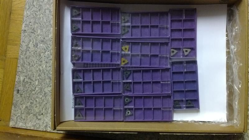

                                  Well, last week a box landed on my doorsteps, containing 20 different threading inserts. They came from a tooling firm not too far away, and I am (or was, mostly) a very small customer there. So they wanted me to test these 20 inserts, on steel and stainless steel, and I should give my thoughts about their quality. Steep task, given that I never used threading inserts before. But.they wanted that all be done by the same person and with the same procedure for all.
                                  First problem I saw: according to the catalog these chips need high speed, not the manual handle in the spindle end I usually use for threading. I had a length of 26 mm free cutting steel around, and for this the speed of 1200 rpm on my lathe would be perfect: But I can't stop from that in a microsecond! So first had to produce a mandrel (not a stub one!), on which the workpieces could be mounted far away from the chuck. Then preparing the workpieces, about 30 mm long, bored and reamed 12 mm. A small notch axially in the end for a positive drive – bad if they would turn on the mandrel. A pressure pad from the tailstock keeps all aligned.

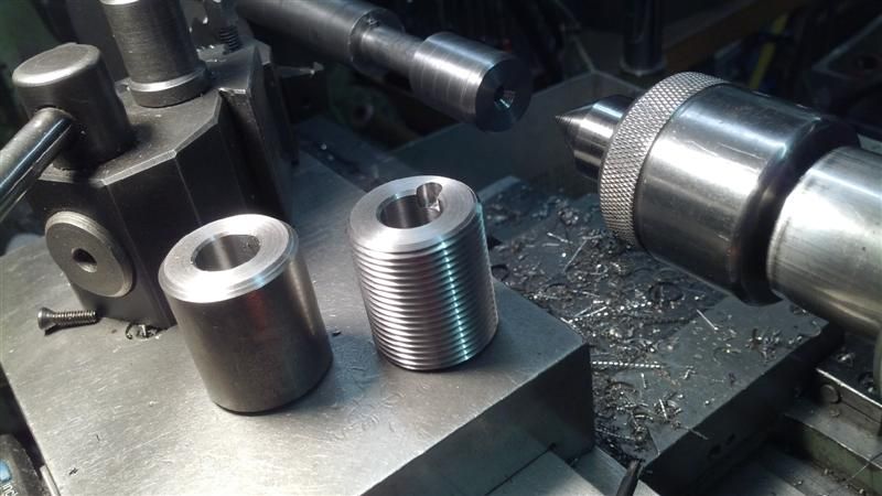

                                  You see also a finished example here. The threads are all 1.5 mm pitch, and accidentally my leadscrew is 3 mm. So I could open the clasp nuts and bring the saddle back manually. This way the mandrel could have been shorter, but I left it as it was…
                                  That's how it looks installed and ready for work. F.c. steel done now; have to fetch the stainless tomorrow.
                                  Ah – and I don't know what I should say about the quality of the threads. In my (very humble) opinion all work the same…
                                  Greetings, HansR.
