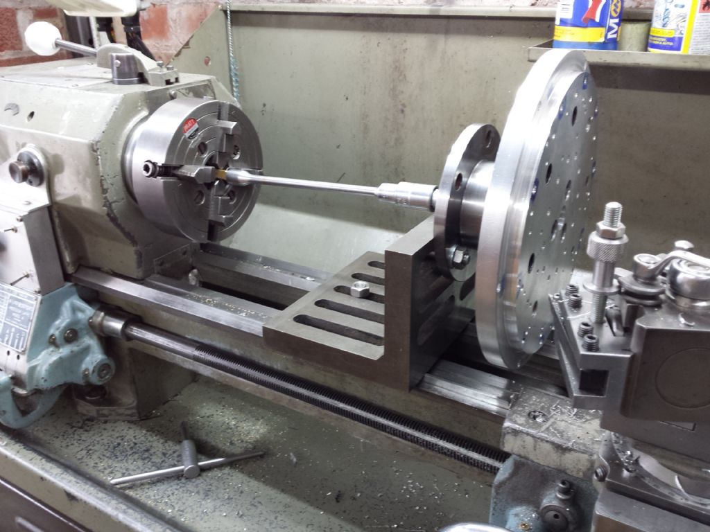

In the best bodging tradition I jury rigged a temporary headstock on my AUD so I could machine a part larger diameter than the 5" centre height would allow.
The 'headstock' is a free rotating rotary table I made some time ago out of a car front wheel hub and a large aluminium blank from the scrapbox. Drive is via a square bit of brass held in the 4 jaw that is a rattly fit in a 3/8" socket extension bar. At the other end the imperial socket is a loose fit on an M10 bolt that screws into the hub spindle.
Drive is surprisingly smooth and once the tool is cutting does not make any noise, its OK too at over 1000RPM although it wont be going that fast when I am machining the OD of the part (for 'O' ring grooves).
The 'faceplate' came with an assortment of holes with taper threads, I added several rings of holes for indexing when I use it on the milling machine. The fact that it came with holes in random positions is a bonus, it means I have no qualms about drilling more just to suit whatever I want to bolt down.
