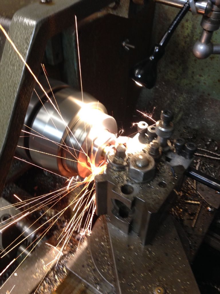

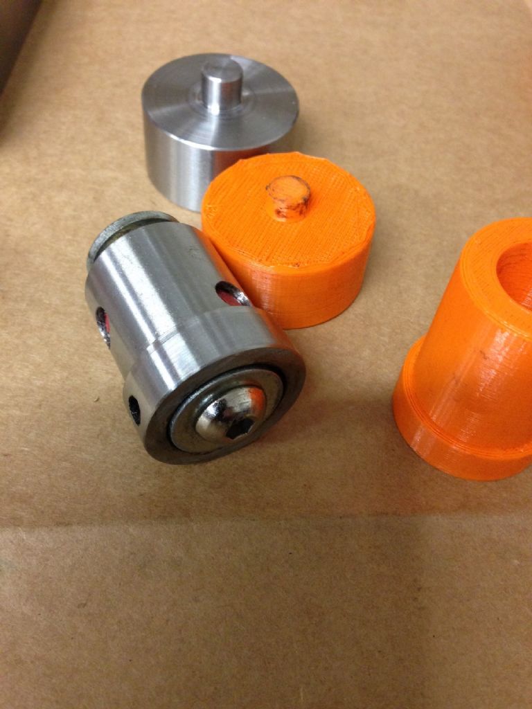

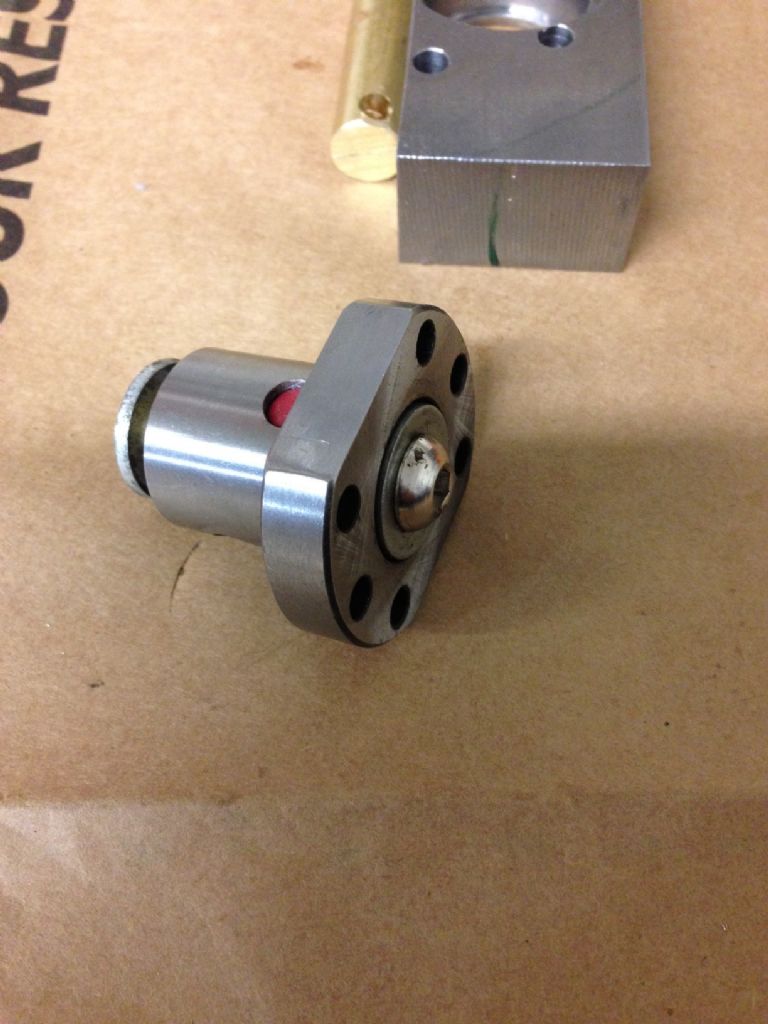

                            Needed to reduce the flange on a (hardened) recirculating ballnut. Don't have any sensible grinding equipment so I followed Andy Johnston's lead **LINK** and turned it on the lathe using carbide tooling. I found 0.1mm depth of cut and something like 8 thou per rev worked nicely. You have to get the speed right up there, so I gave it 2000rpm and it cut nicely. Took it down from 48mm to 32mm diameter and the length of the flange is 10mm.
                            This is how it started out:
                            Ballnut as supplied
                            This is what it's like in action. Stand back!
                            Machining hardened ballnut
                            The finished part:
                            Finished part
                            I actually turned it using an indexable boring bar behind the workpiece with the machine running in reverse. I do this quite a bit, as you can turn inside and outside surfaces this way and also make internal and external chamfers without having to change the topslide. You just need to remember to select the correct direction of rotation every time….
                            As before, I made most of the parts on the 3D printer to check fit etc and I am gradually swapping the plastic parts out for metal as I make them or they arrive in the post. When you are making parts up to fit an existing complex body it seems to me to be the path of least effort and risk (try modelling a Bridgeport head with all its lumps and bumps this side of Xmas).
                            Murray
                            Edited By Muzzer on 16/04/2014 07:20:43
                            #149968
                              Great work, Murray
                              … Love the pic of the sparks flying.
                              Excellent use of 3D printing, too.

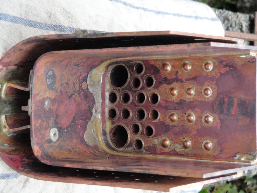

                                              thursday afternoon, silver soldered the outer wrapper to girder stays and inner firebox tubeplate to front foundation ring and throatplate stays on my current build 5"g terrier loco STEPNEY. major big heat up and awkward job done… hopefully now plain sailing to finish. all done with silverflo 55.
                                              cheers,
                                              julian
