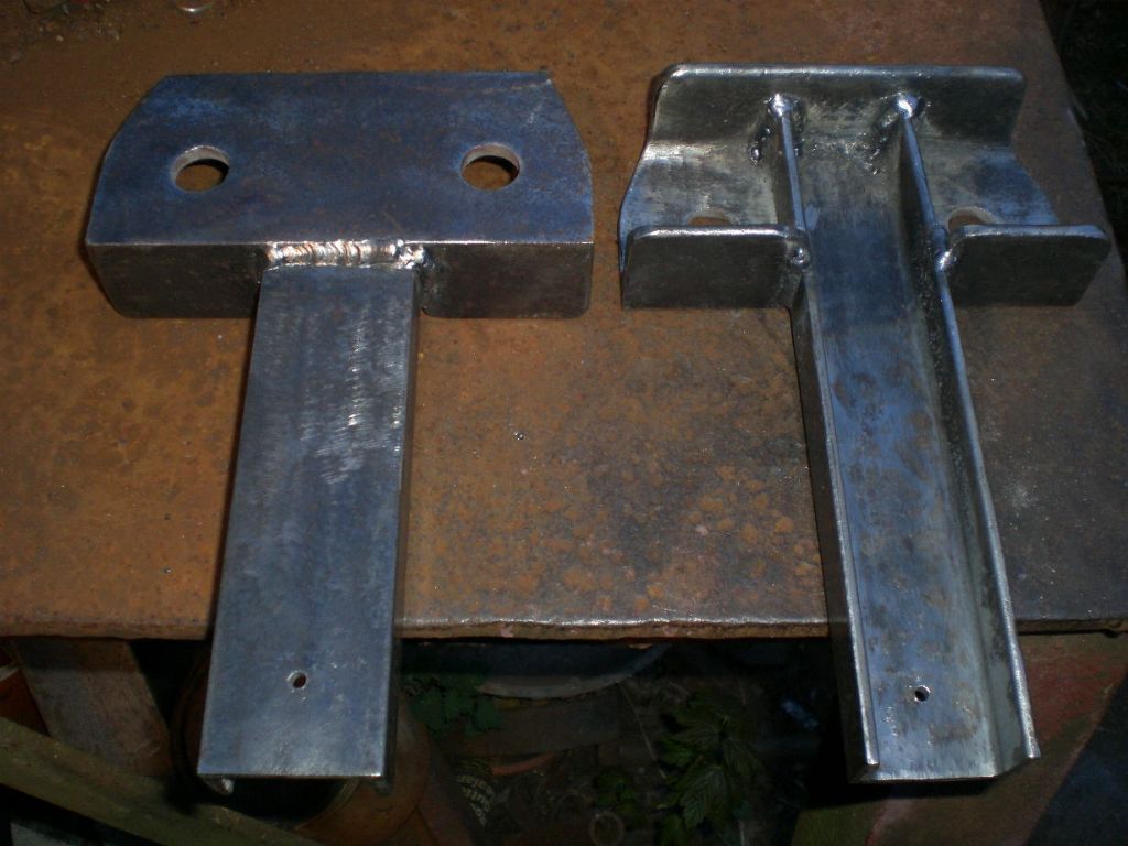

        Hi, made the frames for my liting beam trolley. Two pieces of 3" x 1-1/2" channel are used either side of the wheels and two pieces of 2" x 1" channel hang down from them below the beam, long enough for a pin to tie them together, which will also be for hanging the chian blocks on.

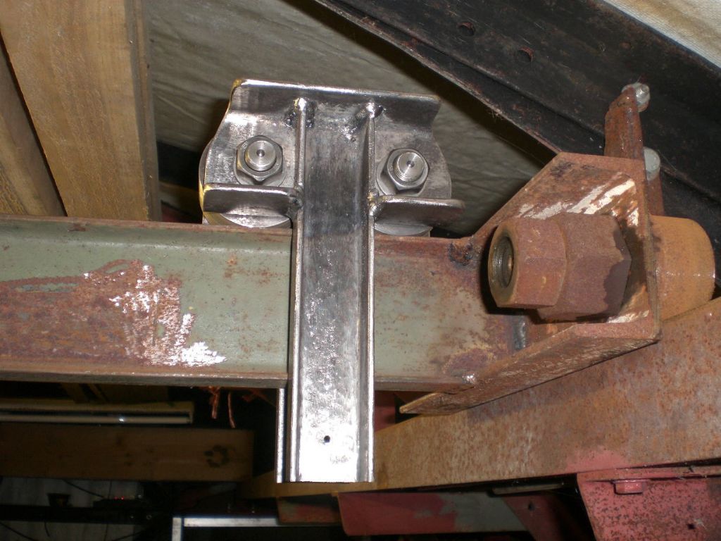

        The two pilot holes at the bottom of the 2" x 1" channel is where the pin will be. Below is a photo of the trolley on the beam excluding the pin and side thrust pads.

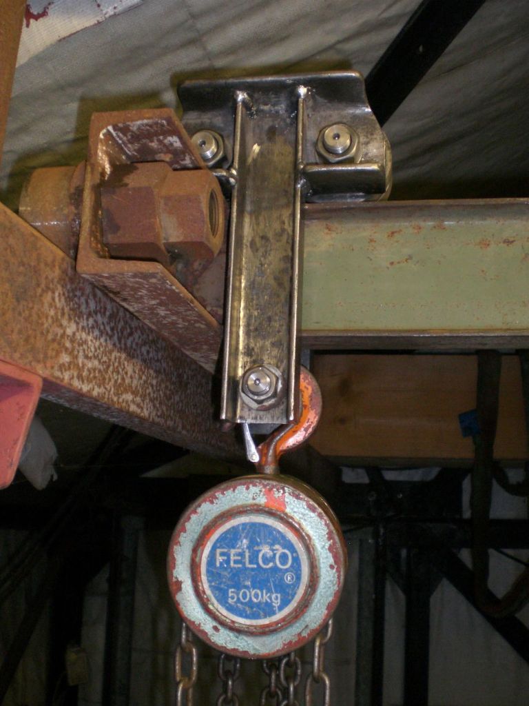

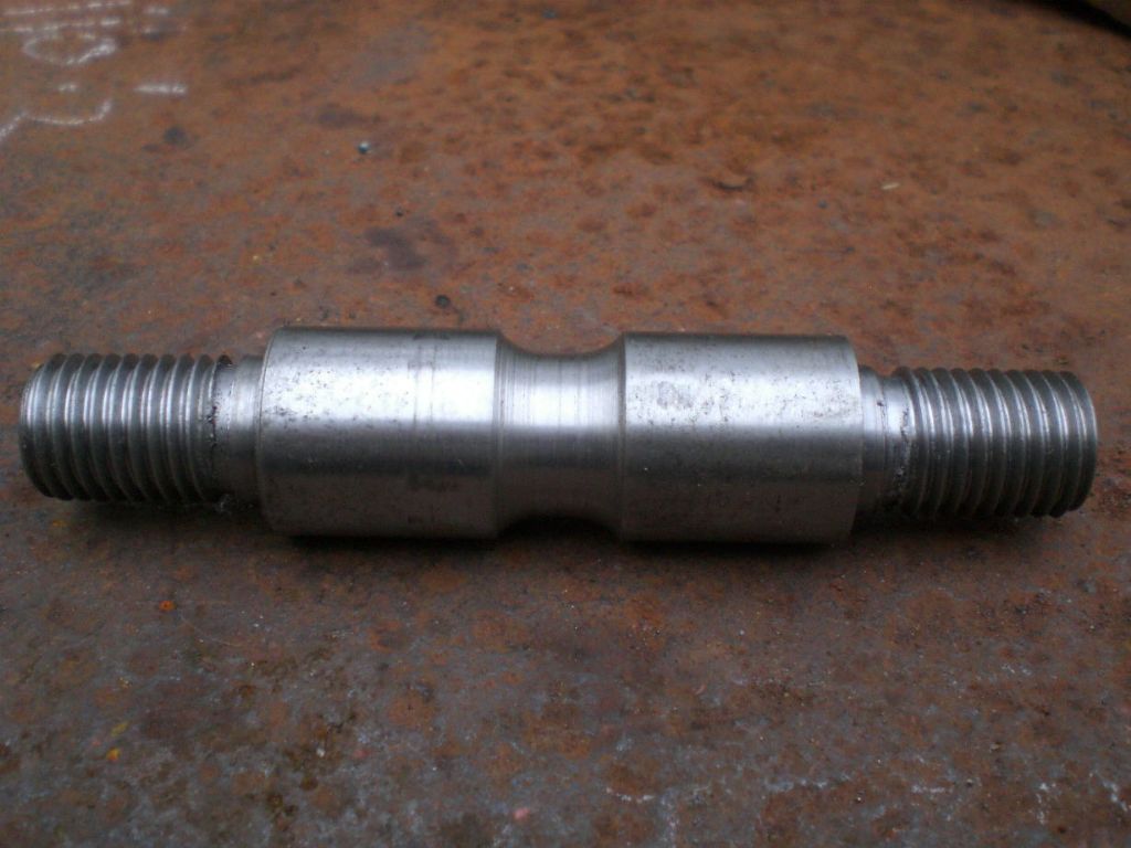

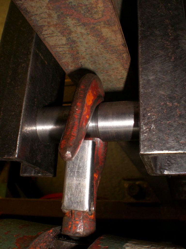

          Hi, made the pin today that ties the two channels that hang down below the beam and to which the chain block is held up by.
          The reduced portion in the centre is where the hook of the chain block sits and keeps it central to the trolley.
          The design of this trolley maximises the full width of the traveling lifting beam.
          Just need to make and fit a pair of guide pads to keep the trolley central on the lifting beam and to stop it twisting.

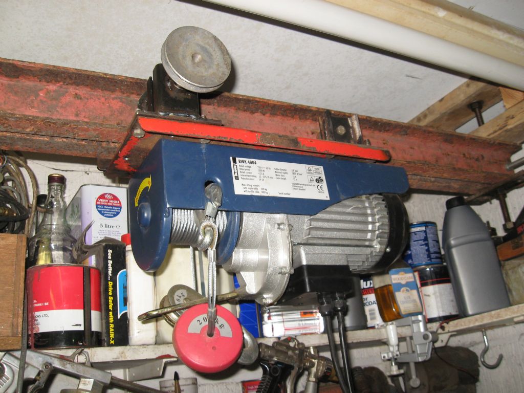

                              Hi Nick,
                              I was going to suggest using flanged wheels but it would not fit in with your design. I thought I had put flanges on the wheels on mine but when I went to take pictures I found I had only fitted a flanged wheel to the wheel that can be used to drive it along the track. I did not even make wheels for the other three. I just used the outer of the bearings.
                              I had just used guide plates on the other three corners.
