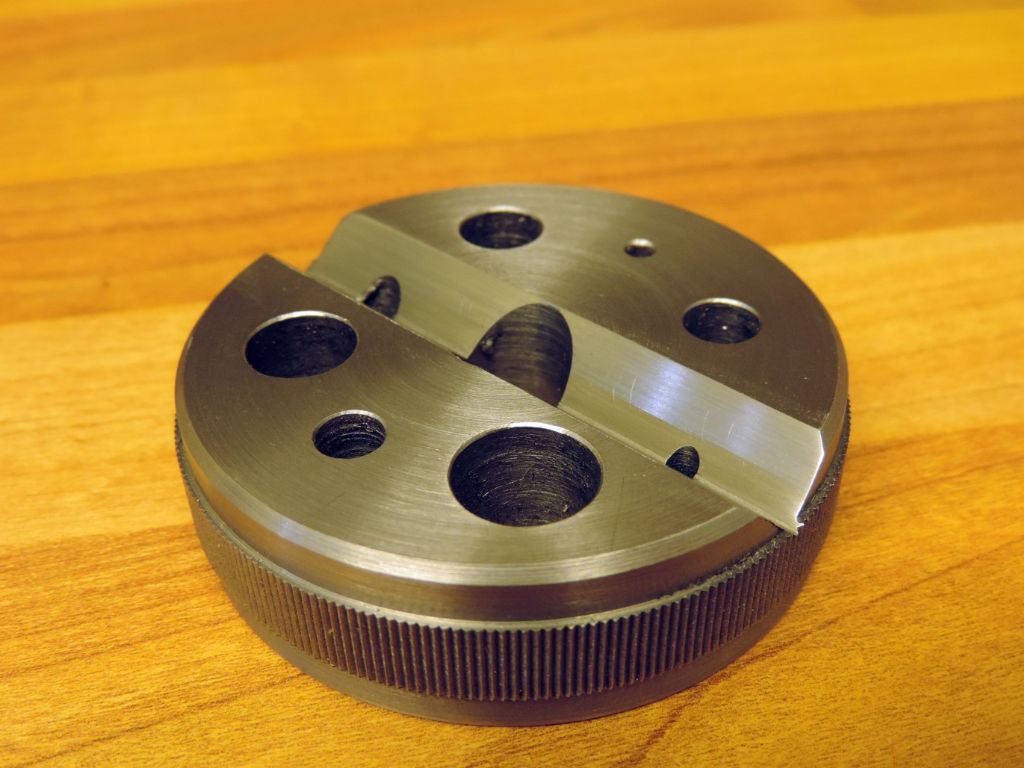

              Bench Block take 2.
              I spent 20 minutes putting a really decent end on an 11mm slot drill with the diamond wheel.. the difference in the cutting made me wonder why I even bothered trying with it blunt (excuse – it looked sharp enough!)
              Gave a silky milled finish, but still some light marks, so a couple of minutes with emery over a hefty steel bar.
              The other side of the V still has a few marks where the cutter had dug in deeper over the holes, but I really didn't want to make the v any deeper.

              #148409
                That looks much nicer.

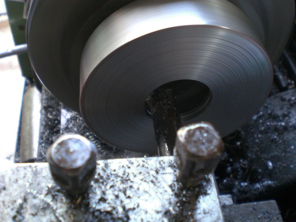

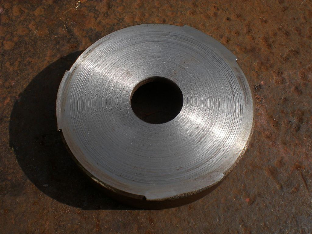

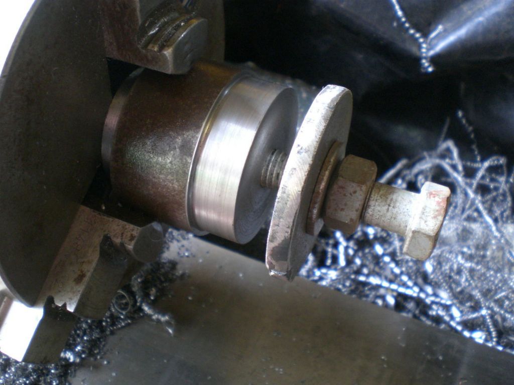

                      Hi, I made a start on a beam trolley for my overhead traveling beam in my garage. I've started with the wheels, which I've made from bearing housings, which were salvaged from 3 1/2" rollers that we used to make up for use in Flexowell horizontal/vertical elevators, similar to some of these, **LINK**.
                      I first mounted them on a three jaw chuck, with the jaws in the well where the bearing is fitted (after removing the bearings) and just lightly faced the back to remove what was left of three short welds that held them into the rollers.
                      I then chucked a suitable size piece of (rusty) BMS and turned up a mandrel to fit the bearing well, snugly and drilled and tap a hole in the end. Then tidied up and drilled a 6mm piece of plate that was a scrap piece that was cicle cut from a job at work.
                      The housings where then mounted on the mandrel and the outside edge was turned down to remove the disc cut, which was a result from removing then from the worn out rollers. The one with the deepest cut was done first and then the other three where tuned down to the same size. No particular size was aimed for, but they are all now 79mm O/D.
                      They were then remounted on the three jaw as before and the hole in the back was then bored out to 30mm to make room for a spacer.

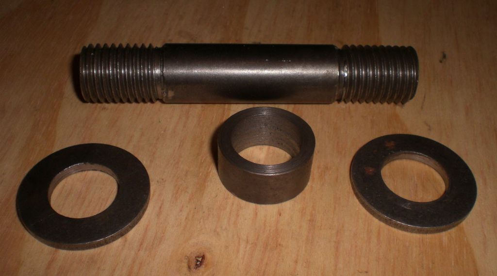

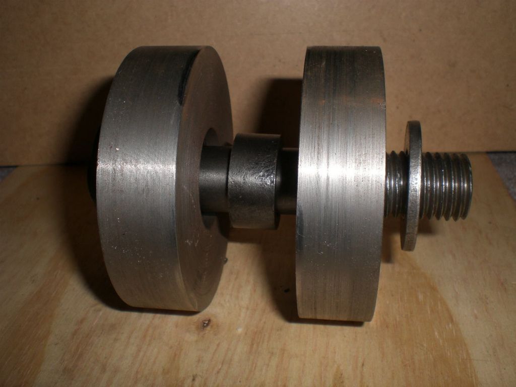

                                                    Hi, made the spindles and spacers for my lifting beam trolley.
                                                    The two washers were 3/4" which were stacked and skimmed for a close fit on the 20mm spindles and will space the wheels from the trolley frame. The middle spacer is just a suitable piece of tube which was drilled out to clear the spindle and was faced and then parted off to length.
                                                    Have cut and marked out some steel for the trolley frame.
