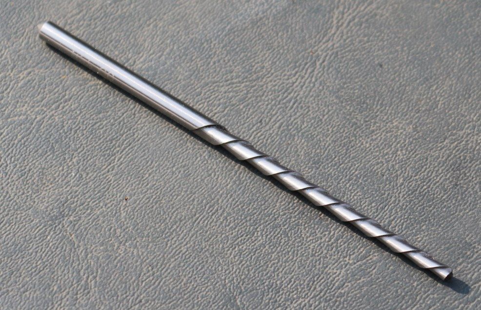

                          Started cannibalising a tired old bench drill for bits so I can refurb. an equally tired KENNEDY power hack saw.
                          Afterwards, sorted out the stuff in a toolbox from a boot last Sunday and found, along with much exotic engineering tooling, this:
                          I've never seen one before and have no idea what it's for. The shank is approx .125" and the business part has a slight taper toward the tip. Is it a drill or a reamer – or maybe a dreamer?

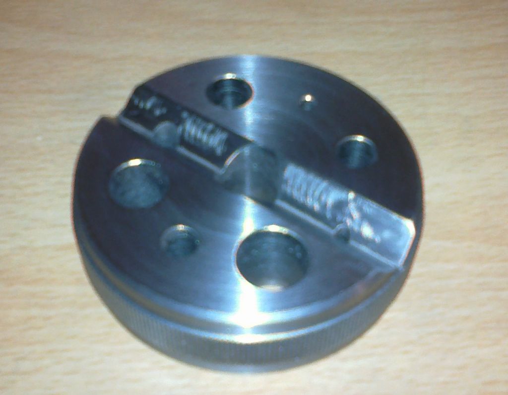

                            Apologies for the crummy phone picture and the machining marks on the V, but I ought to show you my bench block.

                              Very good Neil !
                              I made one of these many years ago ( minus the machining marks cheeky!) – So far I've not really found a use for it. Any ideas?

                                Hi Norman,
                                If I sharpen up one of my 11.5mm slot drills and take off another few thou to tidy it up (assuming I can reset it accurately enough) it will make a fine paperweight.
                                #148320
                                  And the Vee will make a handy holder to stop your scriber rolling off the bench.
                                  J
                                  PS will that bit of paper that its weighing down be a forthcomming article for MEW on how you made itwink 2

                                    Hi Rick The tapered device in your photo is a machine reamer to ream tapered holes for taper pins, which were used a lot to secure collars to shafts.when this country did proper engineering, the taper used to be 1 in 96 (1/8 per foot) nowadays the more common taper is 1 in a 100, Taper reamers with straight flutes were for hand reaming the holes. Hand reaming the holes was time consuming,machining them was quicker ,the cheap way nowadays is to use roll pins which work but can be bl….y useless.

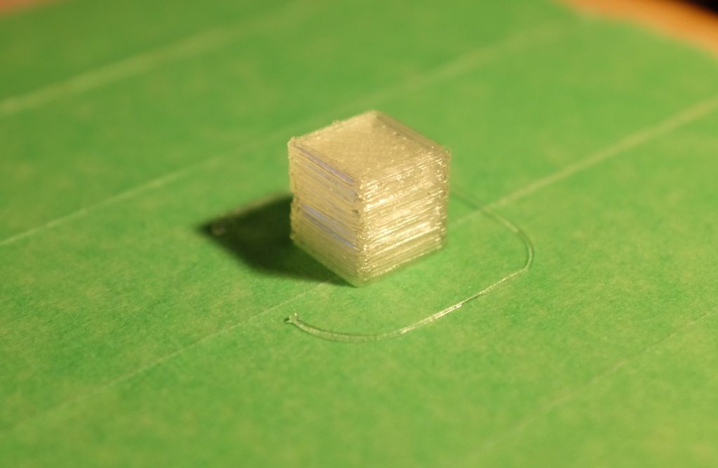

                                            A couple of weeks ago I put together a "Printrbot Simple" 3D printer, but the power supply was dead on arrival.
                                            Printrbot sent a new one, arrived in the post today, plugged it in, figured out the Z height, put in some filament, hit play, and the gosh darn thing (family forum language, that is) worked first time!
                                            It's a calibration cube, which is "close", but I'll need to actually measure it with something other than a plastic ruler to see how it actually turned out. (my blog, with more info: **LINK** if you are interested)

                                                  Hi Rik, It looks not unlike a rotozip cutter called a spiral saw, take a look at
