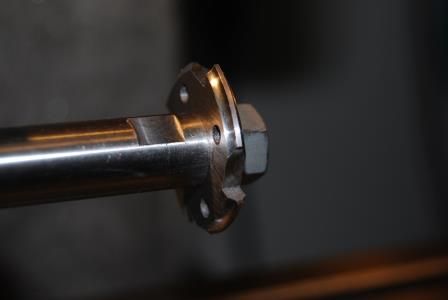

      Yesterday and today I finished my first gear cutter (save for hardening it), made using the "button" method except that instead of making two buttons and a bar to hold them the right distance apart I turned the proifiles using CNC. Took a while to work out the method but should be much quicker. Here are 3 photosdsc_0205.jpg
      This is the blank (in this case with all the profiles finished) mounted on a fixture held in a collet chuck.
      Here's the finished cutter after gashing it, mounted on its arbor held in my dividing head.
      Another picture showing the gashed cutter and the fixture.
