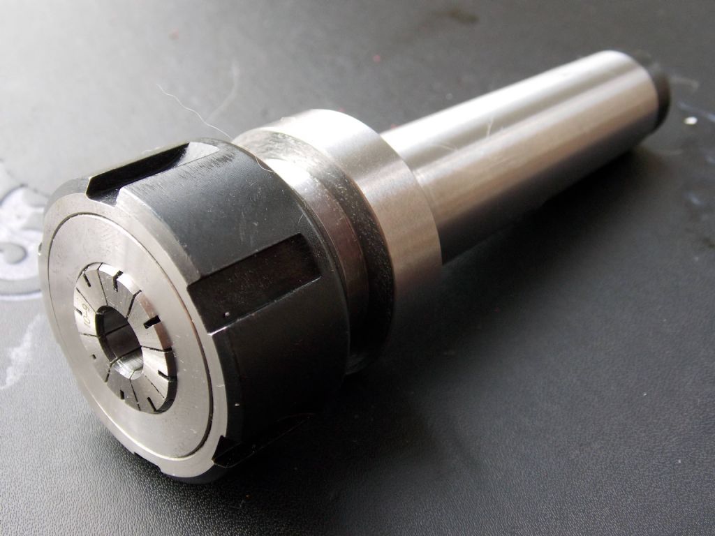

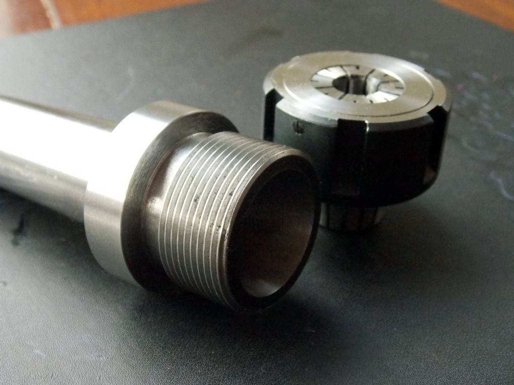

          Just to prove I don't spend ALL day looking at this forum.. I a couple of hours was enough to make a new ER25 chuck using a large-ended MT3 blank arbor from Arc Euro and a ball bearing collet nut from Gloster.
          Made easier as I already have an 8-degree 'square' made for my first ER25 chuck & homemade collets. This chuck is much smaller but doesn't have the through capacity. I'll use it for milling cutters and teh other for holding bar on the lathe.
          The ballbearing nut is brilliant – I was able to collapse that collet by hand.
          P.S. yes I know there are three holes left to drill for a tommy bar
          Edited By Stub Mandrel on 16/03/2013 14:57:47
          #114558
          Douglas Johnston
            @douglasjohnston98463
            Ok Neil,
            What form does your 8 degree "square" take and how do you use it? I have found getting the 8 degree taper a bit hit and miss and use a collet as my "square". Have you found a better way of doing it?
            Doug
            #114559
            Sub Mandrel
              @submandrel
              Hi Doug,
              Just a brass blade soft-soldered into a steel bar, and file to be a good fit aligning the cross and top slides. The initial setting of the top slide was set with a protractor and fine tuned when making the original chuck by the usual trial and error methods. (ME 4232, 15 October 2004, p.455).
              I got a good finish on the taper using a bit of hex key in a pistol drill on the handle to provide a dead-slow 'power feed'. I finished the taper using a piece of emery tape cut to fit round a collet, just enough to make sure all machining marks were removed.
              The 32×1.5 metric thread was cut using the ratios 63:60 45:50 for imperial mini-lathe owners.
              Edited By Stub Mandrel on 16/03/2013 15:56:26
              #114561
              Grizzly bear
                @grizzlybear
                Hi Neil
                The ER25 chuck looks brilliant. I'm not into collet chucks, but always fancied one, home made of course.

                                      #114607
                                      Douglas Johnston
                                        Thanks for the information Neil, I will take on board your ideas if I make other ER collet holders.
                                        Doug

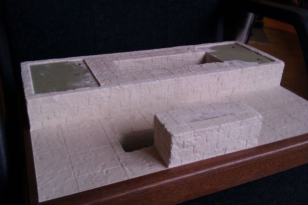

                                                #114633
                                                  I laid some blocks and flag stones in preparation for my soon to be complete Large scale Easton & Anderson Grasshopper Beam
