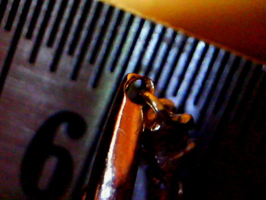

                                            Repaired a gold bracelet.
                                            One of the tiny links had literally worn through, so I added a little bit of gold by soldering some on. I had to use hallmark quality gold solder (its like silver solder, but made with gold instead of silver). I had to use a tiny, intensely hot, flame to melt it without melting the other link.
                                            The rule in the photo is marked with 0.5mm divisions..
                                            Tiny Soldering
