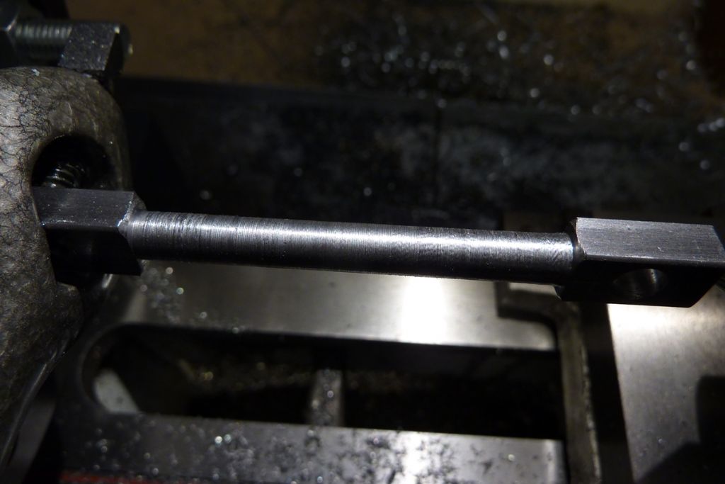

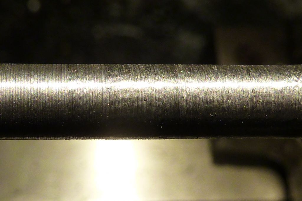

          Had my first go at turning between centres for the S50 con rod. The surface finish is abysmal. This is the worst turning I've done since I got the lathe 18 months ago.
          I made sure the tool was on centre height, and tried a right-hand knife tool, a left-hand knife tool (going the other way), and a threading tool which was probably too pointed. What is the correct tool shape when reducing a diameter between two larger ends? I've tried searching forums and couldn't find anything relevant. Do others just swap tools and try to minimise the join in the middle. Or is a round nosed tool better?

            A pointy tool will reduce flex issues if it's set right (which can take a few goes), slow feed, light cuts, metal should peel off almost silently
            A travelling steady will help
            A rotating tailstock centre can be "better" for a workpiece held tight between centres, make sure the centres contact points are chunky enough for decent stiffness
            A sharp carbide tool usually saves me when things get troublesome

              Thanks for your suggestions. DOC was 5 thou, feed was by hand and I tried varying it without much effect. I should have added that the length of the reduced section is only 2" so I don't think there is room to get a travelling steady in as well. I'm using a rotating centre in the tailstock. I have a RH carbide tool that I could try. It could be that the piece of steel supplied with the kit is not free-cutting. I've read that often poor finish is caused by unsharp tools or incorrect angles. In fact it reminds me of the finish I got when using the cheap set of brazed carbide tools I bought with the lathe (soon stopped using those). I'll try another piece of known FC steel.

                The metal was tearing rather than being cut. Several possible causes:
                Are you sure it is a good free cutting steel? Some alloys are a pig to turn but EN1A or equivalent should be OK.
                Perhaps the tool was blunt or the wrong form. Yes knife tools should be fine but must be really sharp and for this I would grind with plenty of side and back rake – perhaps 20 deg. Put a small radius on the tip.
                Your cutting depth feed rate were perhaps a bit too high. Try reducing them that will reduce any possibility of the work flexing.
                Russell
                EDIT:  Only just seen your reply to Ady and note that you have already tried some of my suggestions.  I wouldn't use a carbide tool for this as it's difficult to get it as sharp as HSS.
                If you haven't tried it you could also try using some neat cutting oil.

                      I've had similar result from time to time. It usually means blunt tool or nasty steel (which is unlikely in a Stuart kit). Other possibility is that it isn't really secure enough between the centres?
