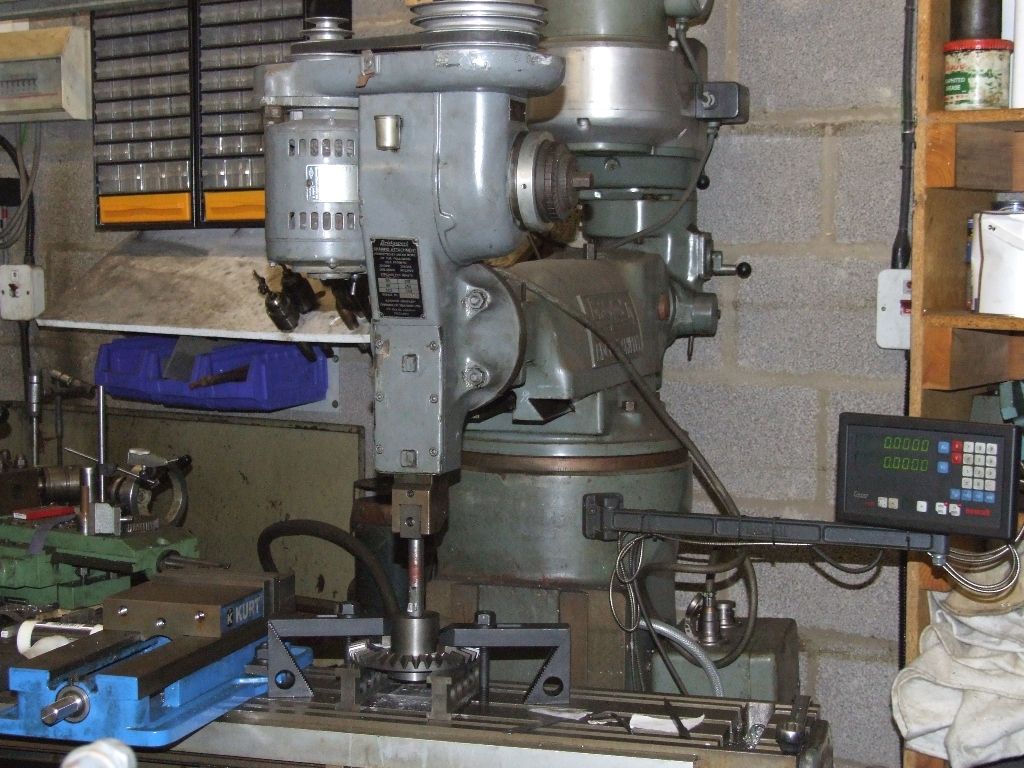

            I was going to have a go at milling the worm for the steering gear on my traction engines today. The extra toolholder I needed arrived from the USA this morning. But, when I went to assemble the cutting tools, no 3mm endmill in stock. crying
            So instead I decided to have a keyways-r-us day. Here's the basic set up with the slotting head:
            The only iffy part is swivelling the ram on the mill through 180° to swap the milling and slotting heads, while avoiding the shelves on the right. Here are the tools I used:

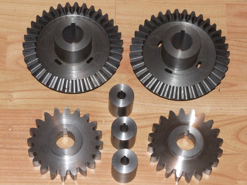

            Here are the parts in which I've cut keyways today:

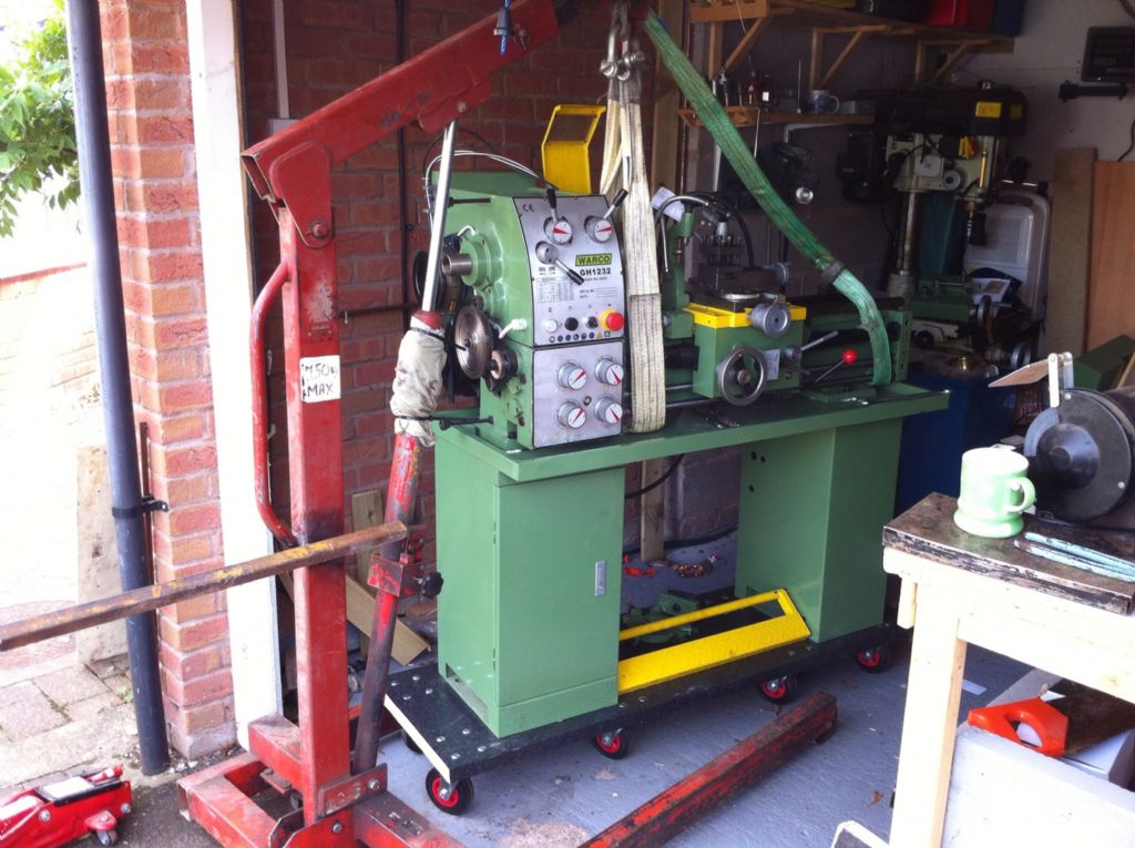

                  image.jpgToday I united my new Warco 1232 lathe with its cabinet stand. A few nervous moments with 500kgs of precision equipment dangling a metre off the ground on the engine crane waiting to slide the stand underneath! Gave it a good degreasing and oiling then ran it up and had a good play to familiarise myself with all the knobs & levers. Quite a difference from the ageing ML7 that it replaces.
                  I have to say, everything seems to work ok and I found my way around the machine quite easily, no thanks to the extremely poor instruction manual that comes with the lathe. It never ceases to amaze me how importers go to great lengths to continuously improve on the quality of machinery coming from the Far East but completely ignore the ludicrously translated, poorly illustrated manuals which accompany them. My lathe manual has several illustrations that appear to have been photocopied so many times that they are illegible. Surely it wouldn't cost much to get the things translated properly and get a decent set of illustrations printed.
                  Anyway, there are one or two things I am not sure about that are sadly not covered in the manual such as how to remove and attach the cam lock chucks, so any advise would be greatly appreciated!

                    Martin, go onto the Grizzly site in the US and look for a lathe called a G0750G not quite the same as yours but very close and the manuals are downloadable and good.
                    **LINK**

                      Hi Martin,
                      if its the same as my 1224 then use the chuck key, I had to extend mine so I didn't keep loosing the odd knuckle – make sure you make a wooden tray to go under the chuck to protect the slideways
                      when they drop they go with a bang

                          Thanks for the link John, the Grizzly machine is pretty much identical to mine. I've downloaded the PDF file for the manual and WOW what a difference! Every aspect of the lathe is clearly explained in good English backed up with clear, well annotated illustrations. Another shining example of how far ahead the Americans are when it comes to customer service. I think I will forward a copy to Warco and ask them why they can't produce a similar manual for their machines!

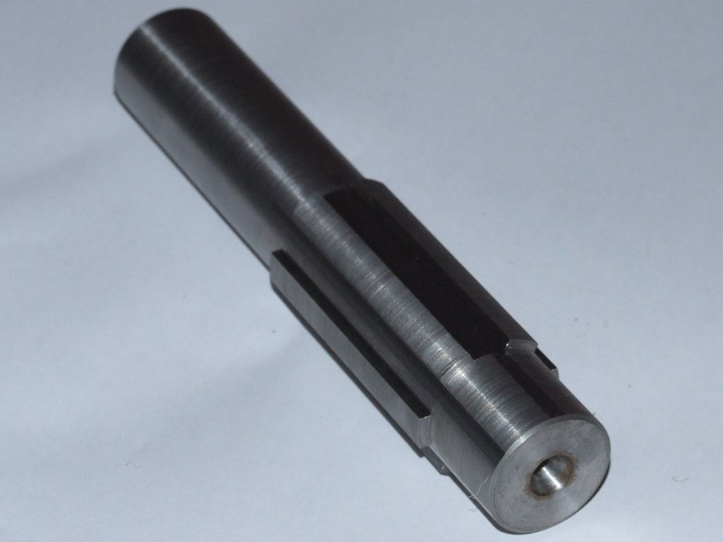

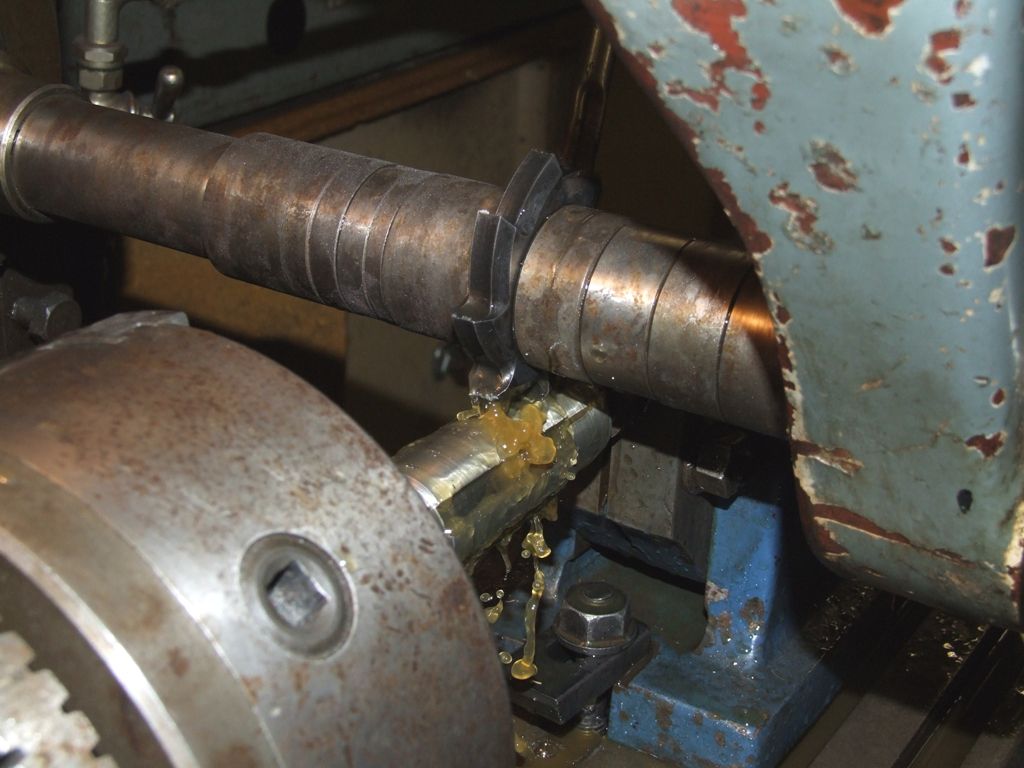

                            Hardened and tempered my home-made spline cutter today. It was pre-heated at 500°C, then raised to 810°C and left to soak for half an hour. I don't have any quenching oil, so I compromised and used brine. After hardening testing showed it was at least 65Rc. It was then tempered at 210°C for half an hour, and quenched in brine again. After tempering the hardness had reduced to around 61Rc, pretty much where it should be for the tempering temperature.
                            This evening I cut my first test spline with the cutter. I choose a conservative speed of 67rpm, giving about 55sfpm and a feedrate of 28mm/min, about 2 thou per tooth. Here's the cutter in action:
                            And the finished spline:
                            The core is supposed to be 1-1/8"; on every opposite pair it measures 1.125" at one end and 1.126" at the other. The splines are supposed to be 5/16" wide, ie, 0.3125". They all measure 0.309"±0.001". Good consistency, but a bit undersize. Never mind, I can adjust the width of the tool used when I cut the slots in the mating gears.
