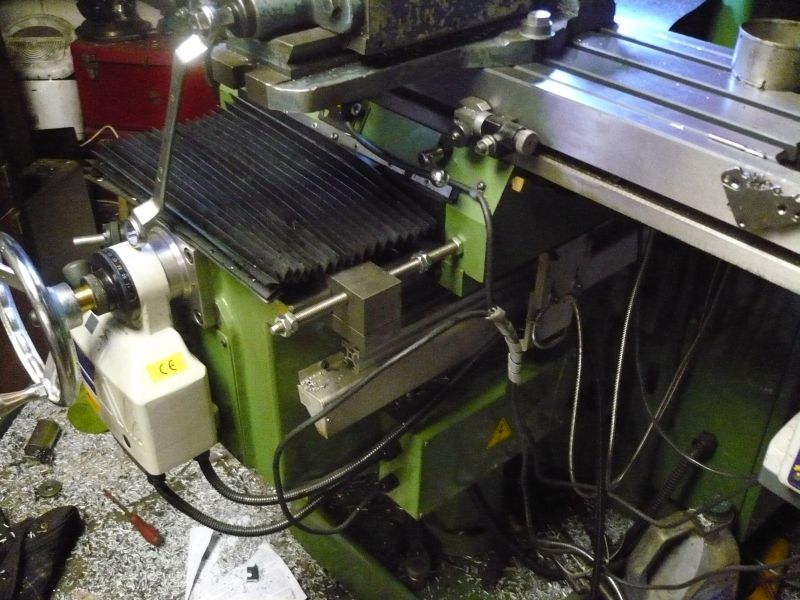

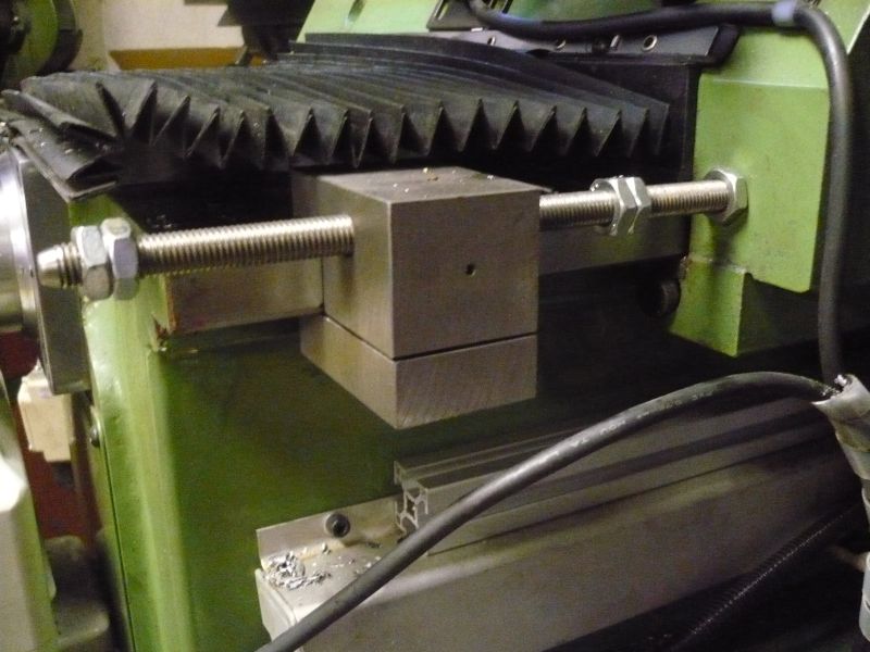

                                          Decided to drill some holes in my new mill as I know it upsets the purists smiley
                                          Dead easy to fit stops the the X axis on a mill but the makers never give a thought to the Y axis.
                                          Soooooooooo,
                                          Belted a hole in the saddle and tapped it M12, length of stainless studding because i had it and a big block to clamp on the ways.
                                          This WM40 has box ways and not dovetails so it makes it an easy job, nice solid thing and dead repeatable.
                                          John S.

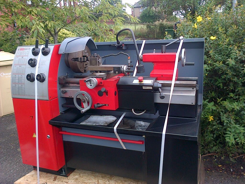

                                                      Got my new (to me) lathe today. didn't want to drop it by being a muppet so got that landylift bloke Steve Cox to shift it up my uneven drive, very nice chap and glad i didn't attempt it myself. It's not yet in its final position as i still have some painting to do, but this is it.img-20130913-00030.jpg
