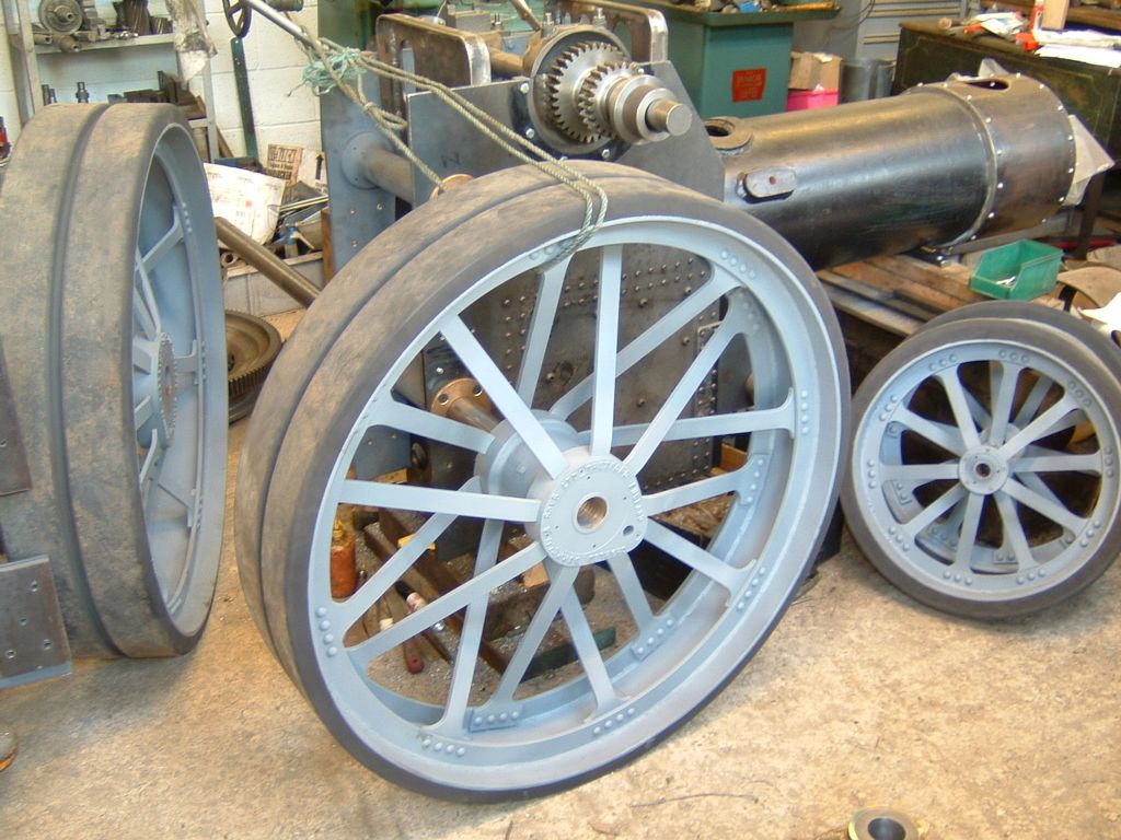

                  Today I went up to "Reliant Rubber Co" at Batley Yorkshire, (180 miles each way ) to collect the wheels of my 6" scale Burrell traction engine, to which they had fitted the vulcanised rubber tyres, also shot blasted and primed, had a tour of the factory with the boss.
                  Richard.
                  Edited By RICHARD GREEN 2 on 18/07/2013 17:48:24

                      Richard,
                      The shot blast & prime sounds a good idea, I recall Martin Wallis was taken aback by the state of his rusty little samson wheels after vulcanising!
                      He had his tyres made oversize and ground them down, yours look more or less on size to me?
                      #124944
                      RICHARD GREEN 2
                        @richardgreen2
                        Neil,
                        Yes the tyres are perfectly on size, I gave Trevor at "Reliant" the required sizes and he machined them to the drawings,
                        They have several facing lathes that they machine traction tyres on, the largest had at least an 8 foot faceplate on it,
                        When we took the wheels up to " Reliant " about five weeks ago they were working on a pair of 6 foot 6 inch diameter rear wheels from a full size road loco,
                        Also they were "rubbering" steam roller wheels,
                        Richard.

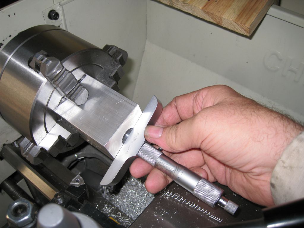

                                    Skimmed up my drill vice & milled a rebate in the jaws (8 x 2.25mm) to take thin material…
