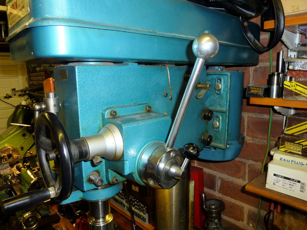

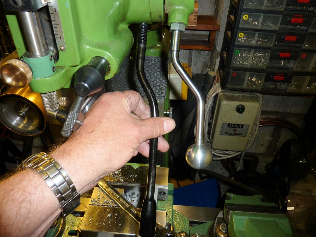

      Today I fixed one of those annoying problems that kept getting ignored. The spoke arms onboth my mill and mill/drill were always too long I thought, the handles would often hit the vice or something else when going for a deep drilling job etc. So I made new ones.
      The one on the mill I made much shorter, and it needed an offset so I had to do some blacksmithing on it to get those bends in. Ball handle was made with the tool I made a few weeks ago. Even though significantly shorter it is still easy to use.
      The one for the mill/drill is similar but without the offset

            Chris, what make your mill/drill, it looks similar to my Rexon 400, except for the colour, mines a dreary green. Ian S C

              It's an elderly Warco A2S turret mill I converted to 3-phase. I don't think they sell them any more. It's been a reliable machine for me over the years.

                    Sorry Ian I mis-read you question – you asked about the mill/drill not the mill.
                    The mill/drill is an (even older) Naerok machine (cute – Korean spelled backwards).

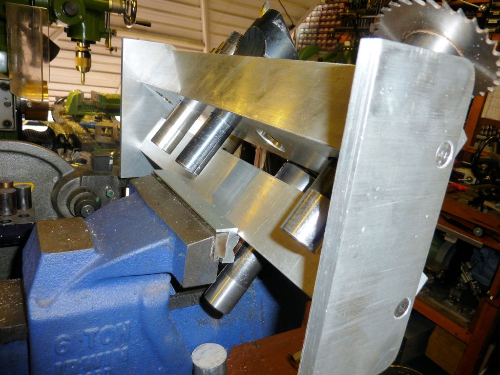

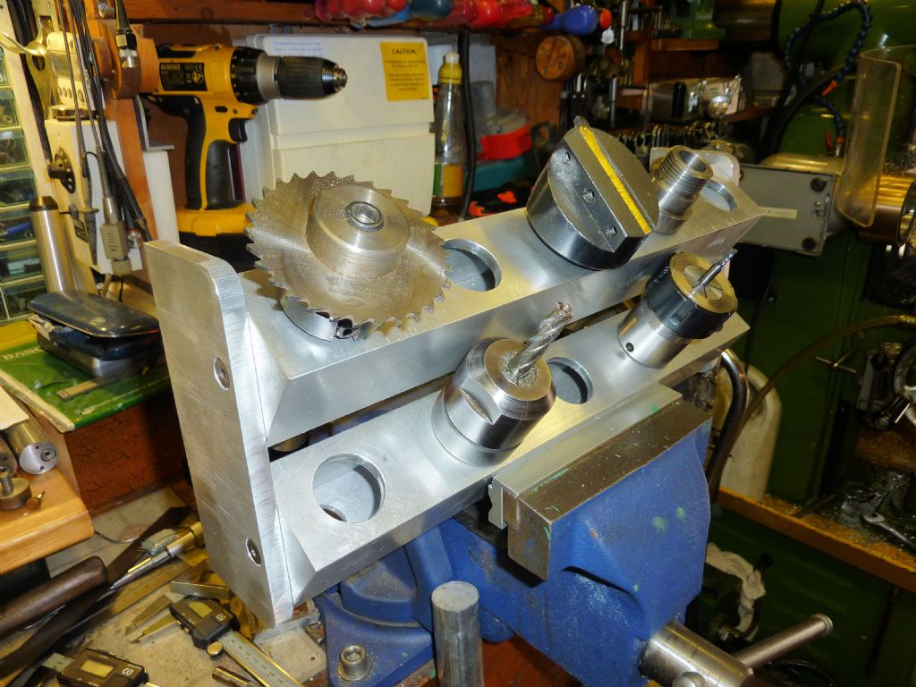

                                                    Partly made an R8 shank tool rack. It's constructed from square alloy tube and alloy flat stock. I wanted something the tools would drop into at an angle rather than vertical, so came up with this.
