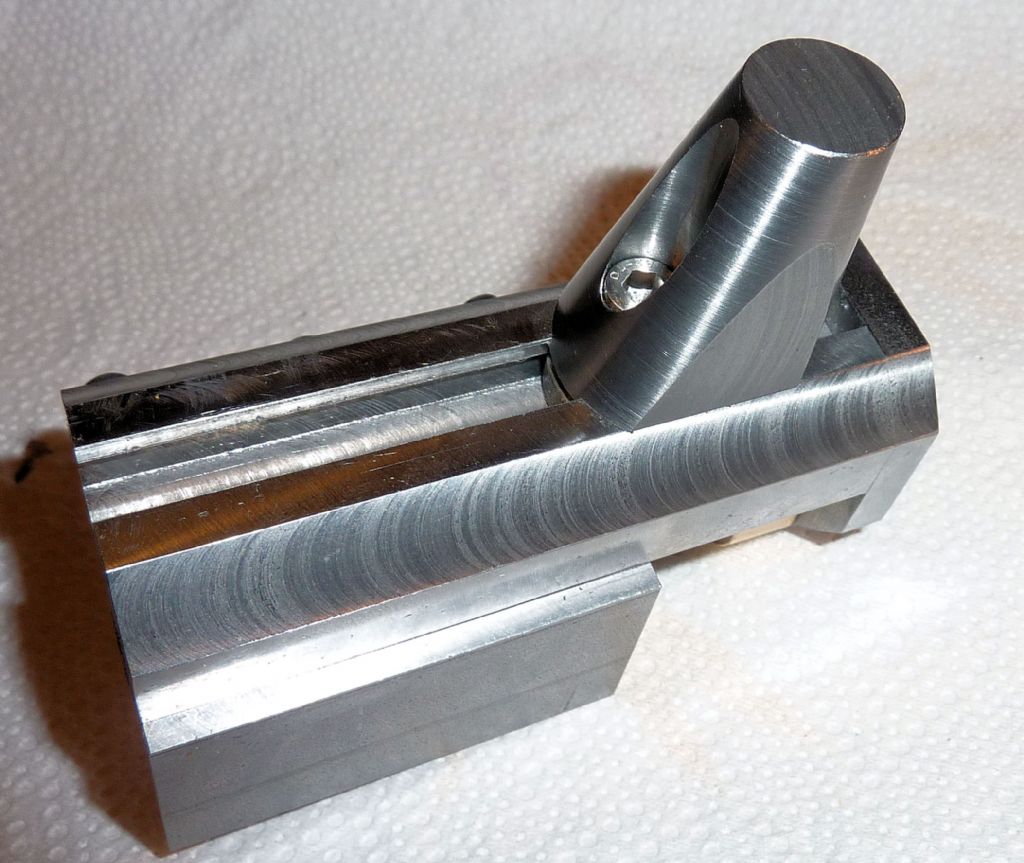

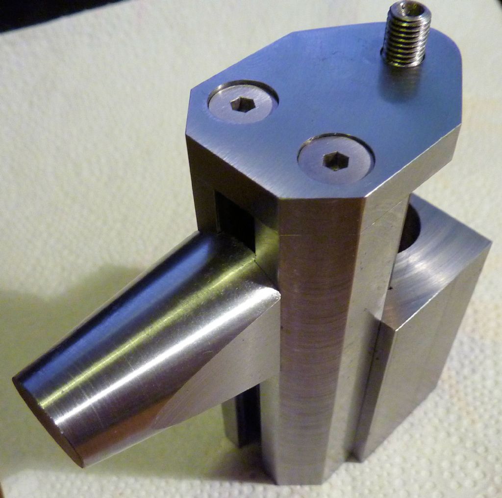

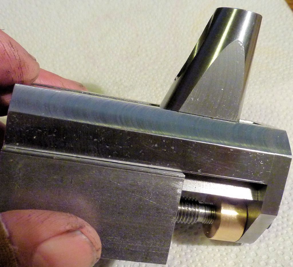

                              A rather miserable evening weather-wise, so still tucked up in the workshop. Made a tool holder – which was an interesting machining exercise. I know – it didn't have to be this shape to be purely functional, but I wanted it that shape because it was more fun to make. Locks up firmly with just one screw.
