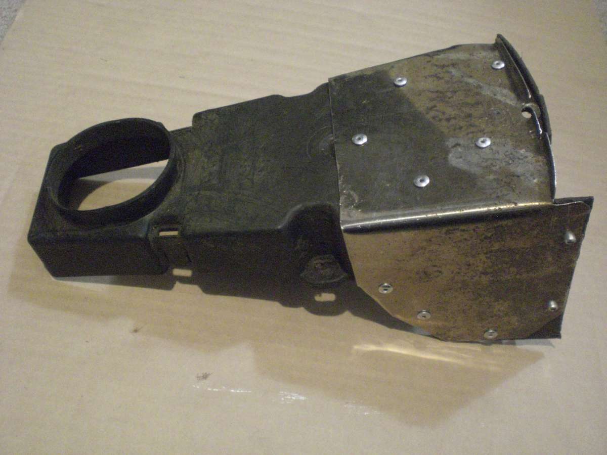

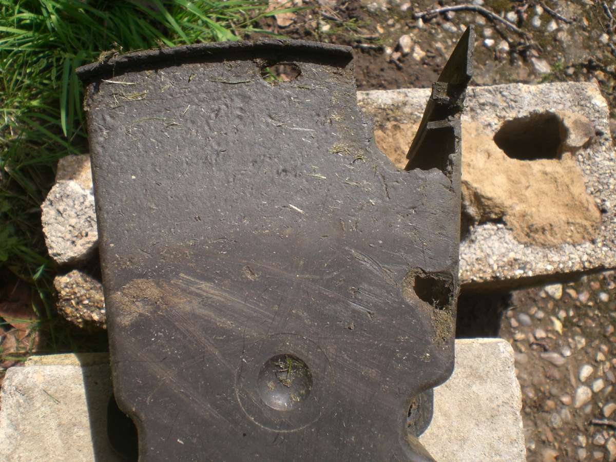

                Hi, earlier this week I was mowing one of my lawns with my self propelled mower, when all of a sudden it stopped self propelling, which made it hard work to push on my uneven ground, and with the grass being on the really long side, made it worse. So when I’d done I had a look at it, and was expecting to find the gearbox that drives the wheels, had given up, however, it was just a build up of wettish grass between the gearbox that swivels and puts tension onto the drive belt, and the mower casing. The obvious cause of the build up, was due to a large piece of plastic missing from  the belt guard, and allowing the blade flinging the grass into the space where the gearbox swivels.
                CIMG3379
                So today I decided to patch it up, and looking for something suitable, I came across a couple of old stainless steel wind shields that you get on those round Barbeque cookers. So cutting a piece big enough out, and folding it to a suitable shape, pop riveted on to cover the gap and another small hole.
                CIMG3381
                Regards Nick.

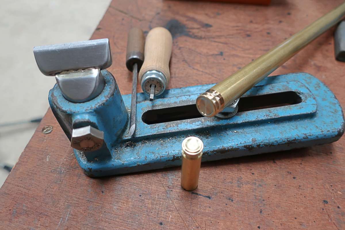

                    ..tested a graver rest.. ..an addition to (or should I say, replacement for)  the iron bracket that has long earned it’s keep as a workstop on the milling machine.
                    ..must have bought back many happy memories for it to be stuck back onto a lathe again for a short while..
                    IMG_2414

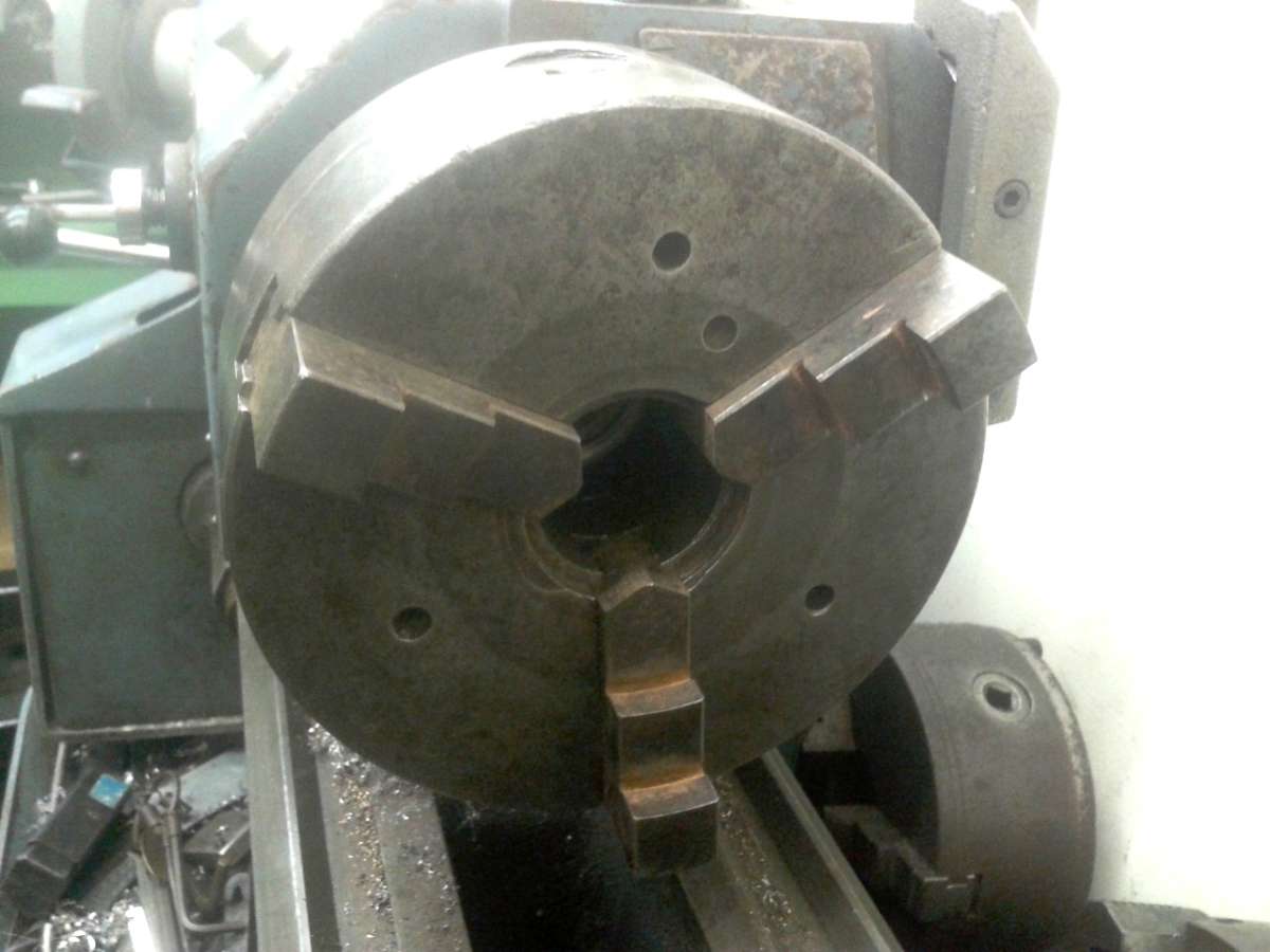

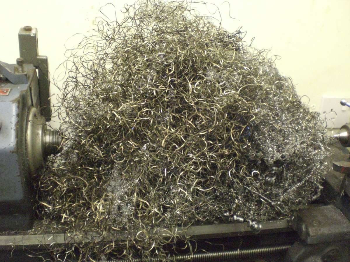

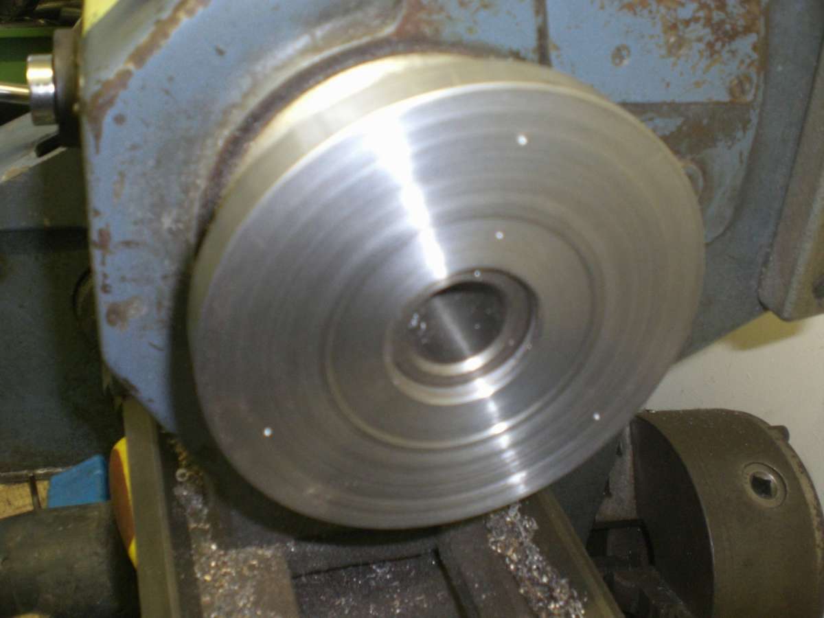

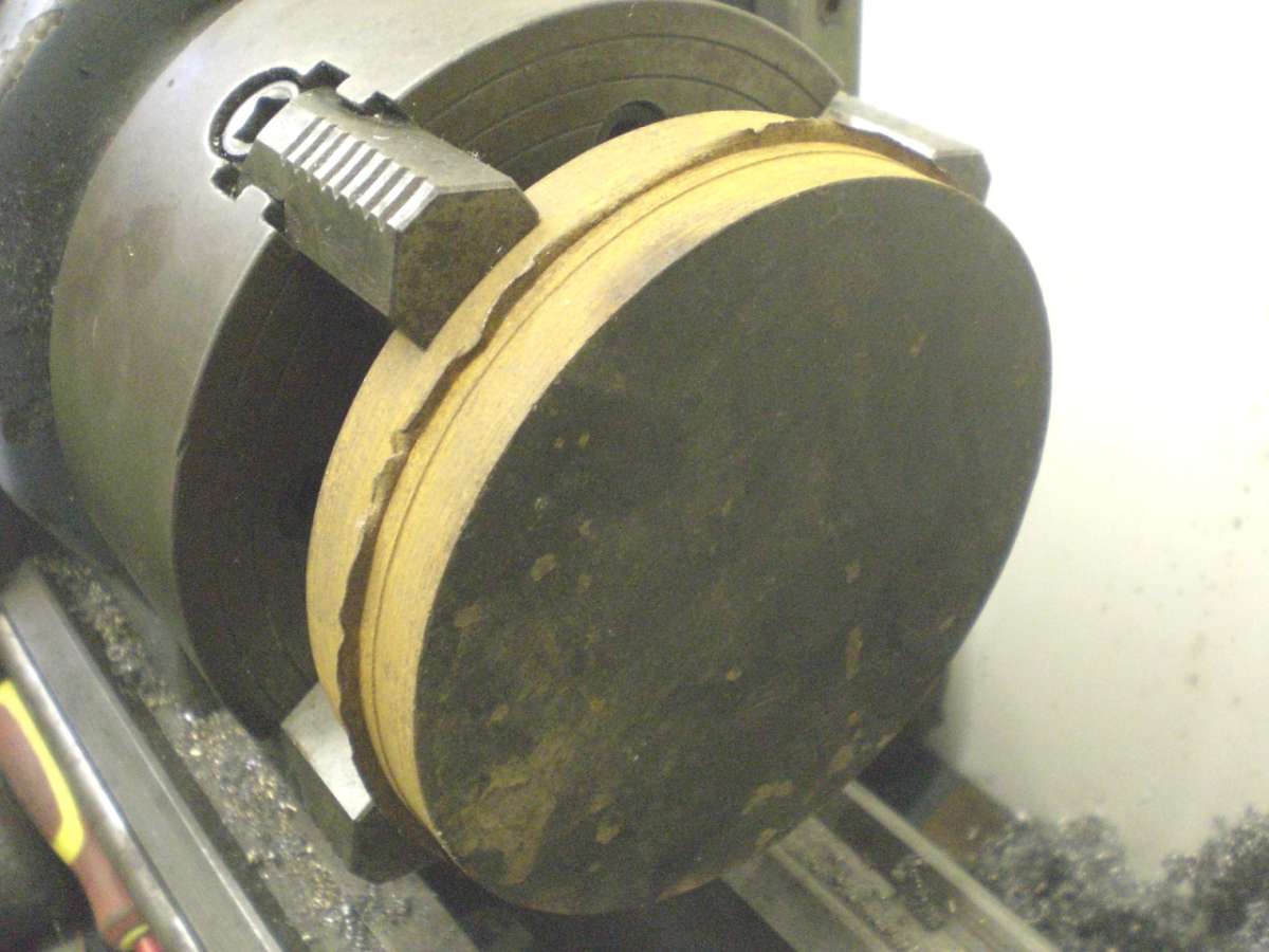

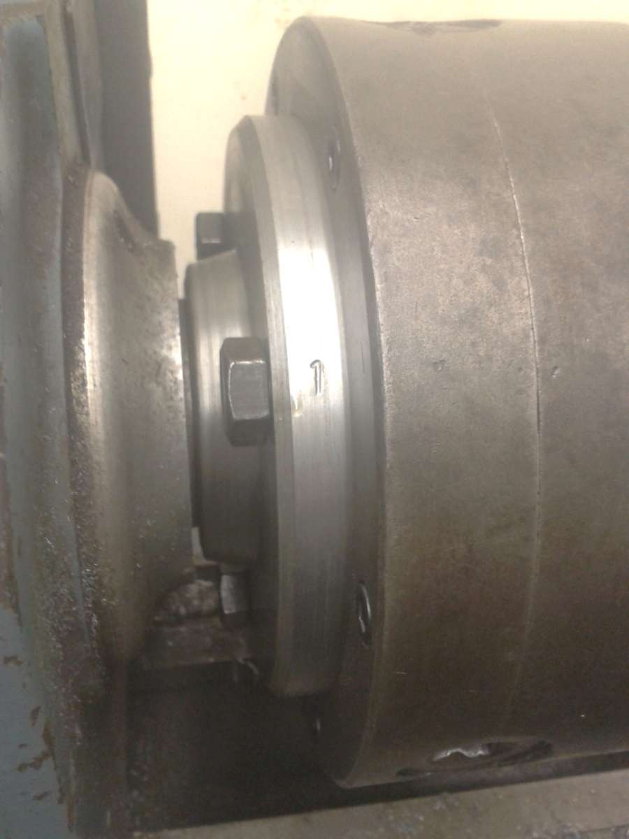

                              Hi, not today, but last Saturday afternoon, I held a 5″ diameter by 30mm thick steel plate, like the one in the photo below, in my four jaw chuck on my Boxford lathe, and as you can see, these were cut out of a larger piece of plate on a large lathe.
                              steel blank
                              After cutting away all this swarf.
                              swarf
                              I found this 120mm diameter chuck backplate hiding inside, which happens to fit my Boxford lathe spindle.
                              backplate 1
                              The three white equidistant spots, show where the holes are hiding, which is where the bolts for fitting a 6″ three jaw chuck that I’ve recently refurbished, and today I’ve drilled those holes, and fitted the chuck, but I had the go out and get some grease, before fitting the two parts of the chuck back together.
                              2024-05-30 17.30.50
                              I’ve also marked the jaw numbers on the side of the backplate, that sticks out at the back of the chuck, which makes it easier than trying to see them on the chuck face.
                              2024-05-30 17.33.40
                              Regards Nick.

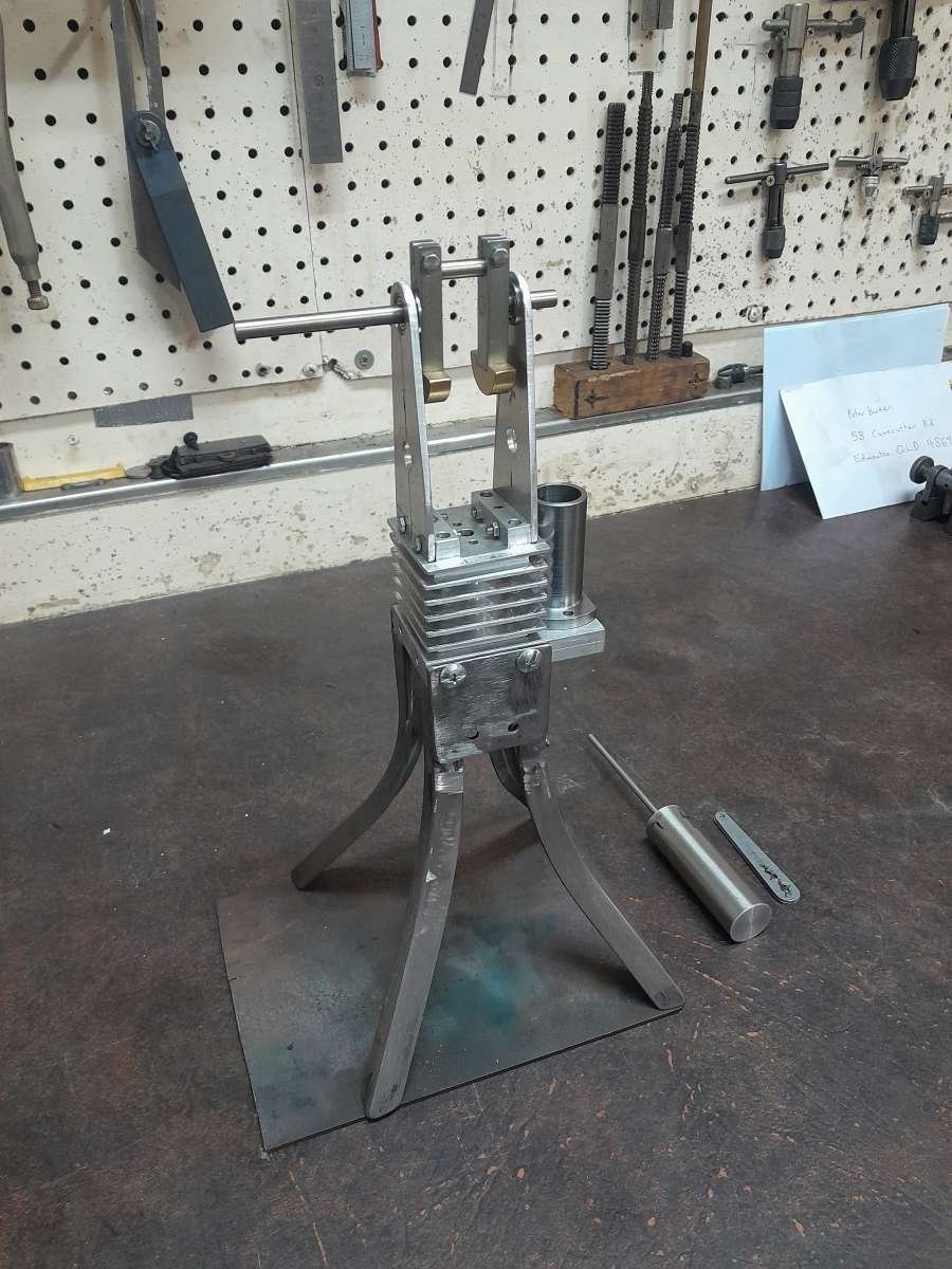

                                  A bit of progress on the Moriya Stirling engined desk fan. I welded the legs onto the sideplates, nearly setting the shed on fire in the process. (see the fire extinguisher thread.)
                                  I do have to say I do my best welding with a grinder and paintbrush. Nevertheless, it scrubbed up ok. Biggest chore was cutting down the 1″ x 1″ x 1/8″ angle iron into 1/2″ angle as the latter seems to not be available in Australia. Then bending the four legs in vice with a piece of pipe slipped over for leverage so they all came out the same. Somehow we got there. So it is starting to look like something now. And I can go on and make the underslung hot end cylinder now it has legs to stand on.
                                  It is always good when you get a project to the stage where it starts to look like something rather than a pile of disconnected parts.

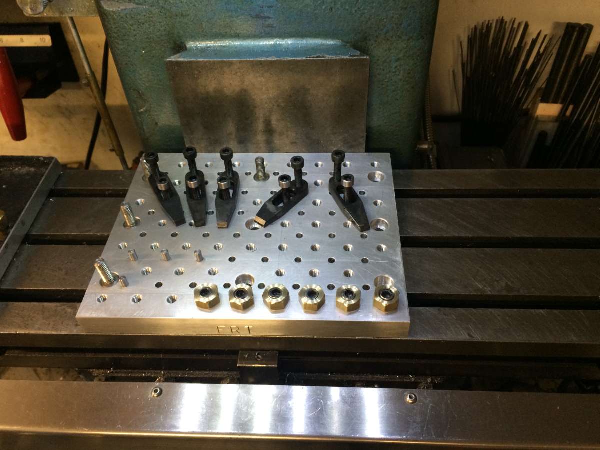

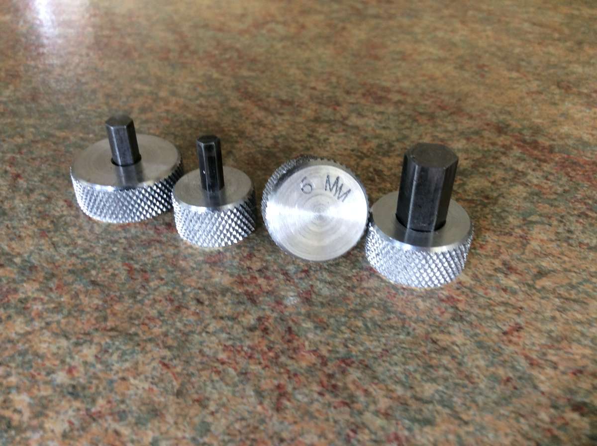

                                    Finished the mini pallet today complete with tool steel finger clamps and some mini mitee bites. wasn’t I glad I kept the Archer tapping head!!. Now I need a job to test it out.IMG_0540

                                      Bought or made mitee bites?
                                      Looked at them a few times, but always put off by the price!

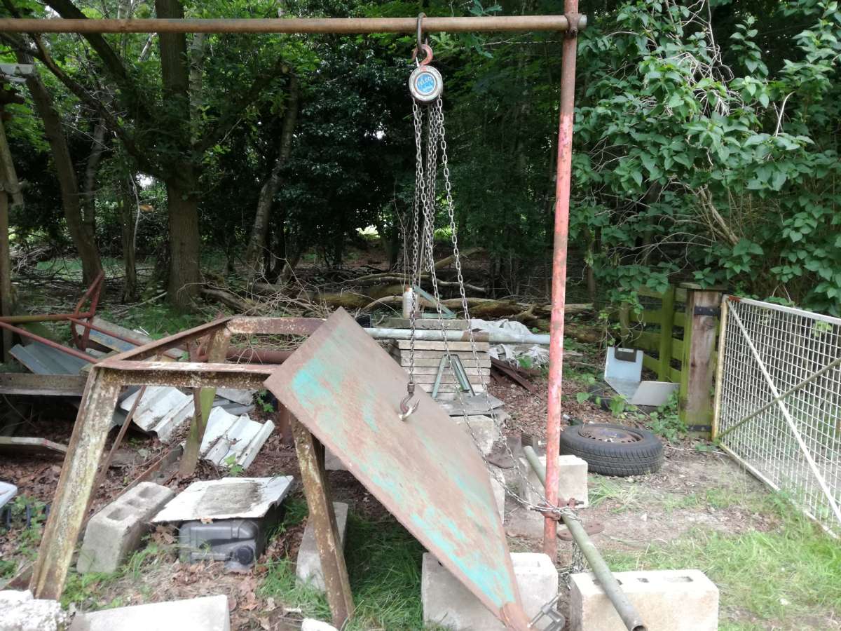

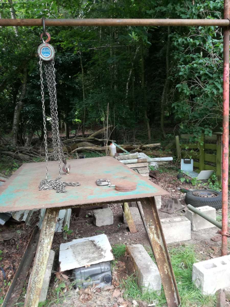

                                        Hi, spent a couple of hours on a kind of “don’t try this at home” kind of thing, no doubt it broke most H&S rules, but I needed to get a 68″ x 40″ x 1/4″ thick piece of Chequer plate onto my old outside welding bench frame. The only way I could think of doing it, was to attach a scaffold pole to a substantial scaffold, that I already have, and fix the other end to a single pole, with a cross pole near the bottom, for extra stability. I used a link on the pole I lifted on, to hang my chain block, which slid along the pole quite easily, by pushing it with a piece of 4 x4 timber. Setting up was the longest part of the job, and the Chequer plate had a 17mm hole in it which an eye bolt was fitted into, but the hole wasn’t exactly in the middle, so a lump of steel was clamped to one side to get a good balance on the length of the plate.
                                        Lifting 1
                                        Lifting 2
                                        It all went very smoothly, without any struggling.
                                        Regards Nick.

                                          Yes Mark they are home  made, I have had the T slot versions for years but am not keen on the pressure it puts on the T slot but this version is only a socket head with the head turned eccentrically to provide the sideways nip on the hexes although these could be round as well.
                                          Nick, lots of thought and little work!!!

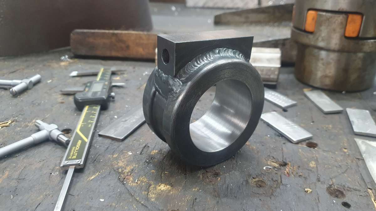

                                            20240607_233715
                                            Finished boring a collar I’m making for a Fobco drill press. Just need to tidy up the welded lug and put the slit in it

                                              Nice neat bit of welding Craig. No pigeons where you live!!!
