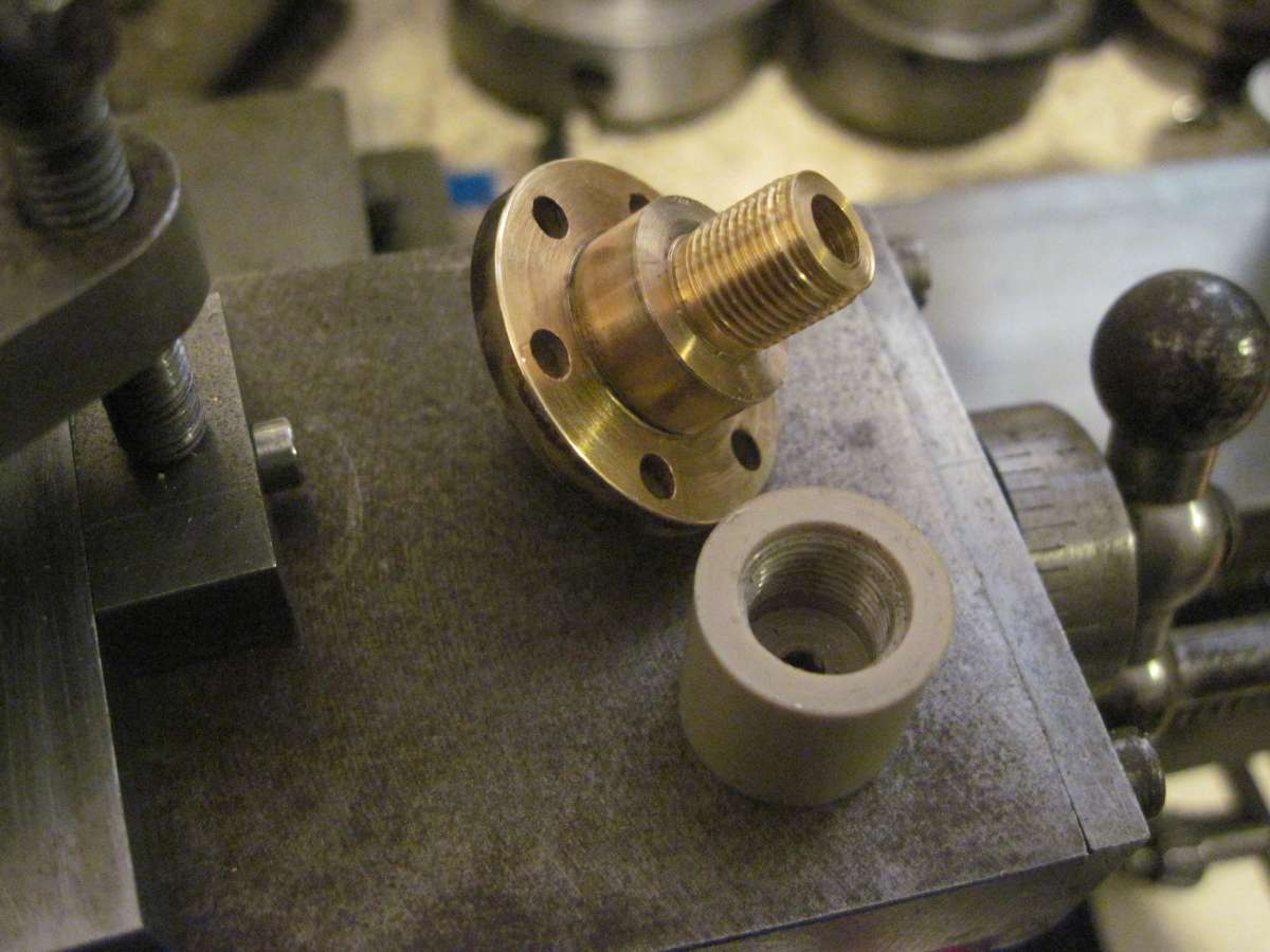

      I’ve been working on a new regulator for one of my locos, replacing a leaky disk type with a screw in one.
      IMG_5711
      This is the third body I’ve made. I wasn’t happy with the wet-header connection on the first one, so started over. The second one was just about finished except for the thread. I was busy turning down to size (listening to the radio) when I realised I’d been thinking of a smaller dimension than I’d drawn for the new part. So gave up, tossed it in the scrap bin and went to bed.
      Then I was step drilling the PEEK cap and the drill well and truly stuck (the larger drill got quite hot) gripping better than any collet chuck. Had to cut it off and start over. Drilled the through hole and then used a very small boring bar to open it up. The PEEK tapped very nicely though.
      IMG_5713
      Then realised that steam collecton was on the other side of the L/H screw body, so had to make some passages in it. My hand shaper did a decent enough job but the part was obviously loose and moved during indexing. Doesn’t really effect the working, just doesn’t look neat. However, after re-doing the body, I was just wanted to move along, so decided to live with it. Being inside the regulator tube, no one but me will probably ever know (and now you dear reader). It is still bugging me a little bit though…
      IMG_5719

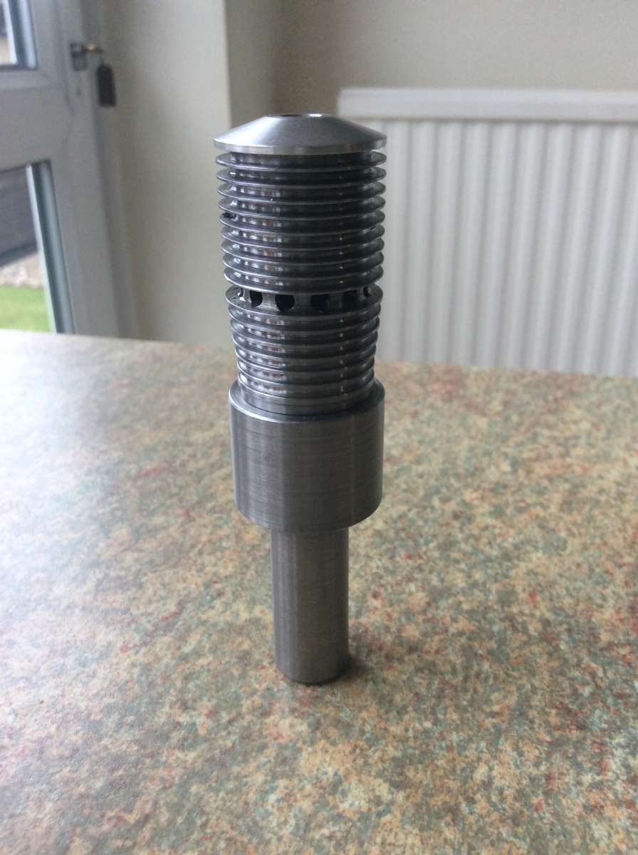

        M & M 29 Have managed the cyl and head today ready for lapping. Now just need some warmer weather to cast the crankcase!!. Its still on the mandrel by the way.IMG_3577

          Bernard, I’ve been a bit slow on the uptake and have just realised what it is you are building – some interesting features in this engine, please do keep ’em coming as you go on with it.
          #727607
          bernard towers
            @bernardtowers37738
            Yes it is a bit unusual Im going to get it running (hopefully) on a glow plug first before I connect it to spark ign.

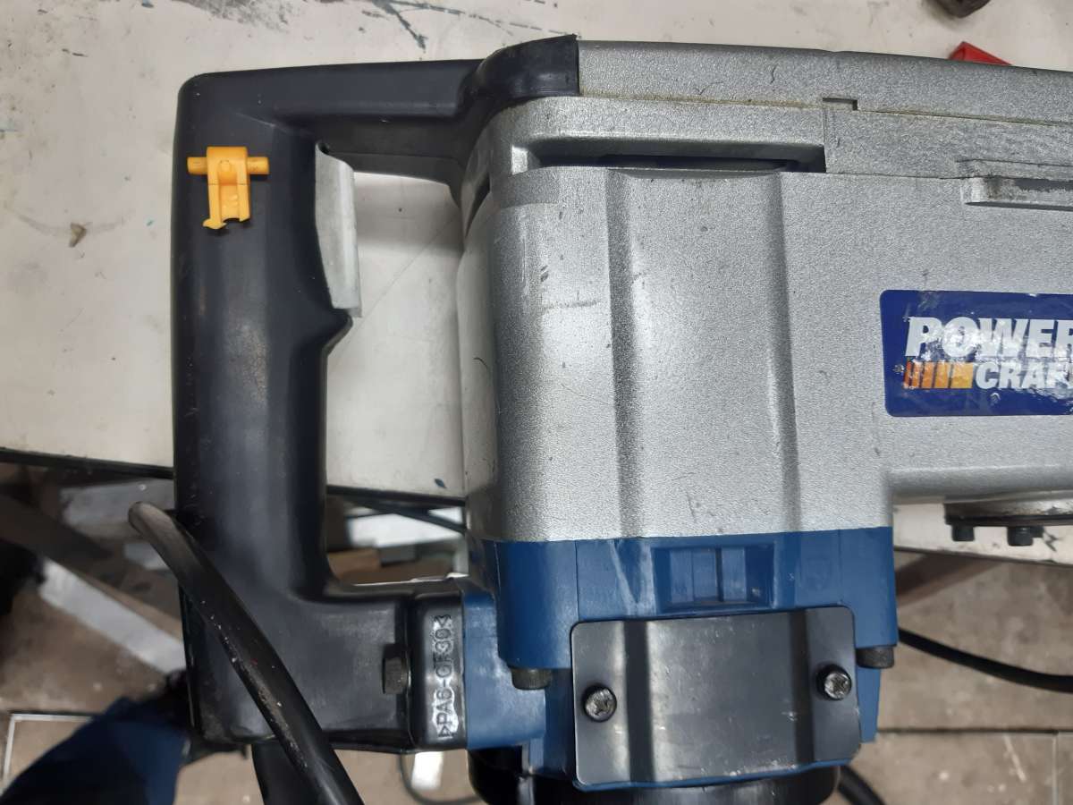

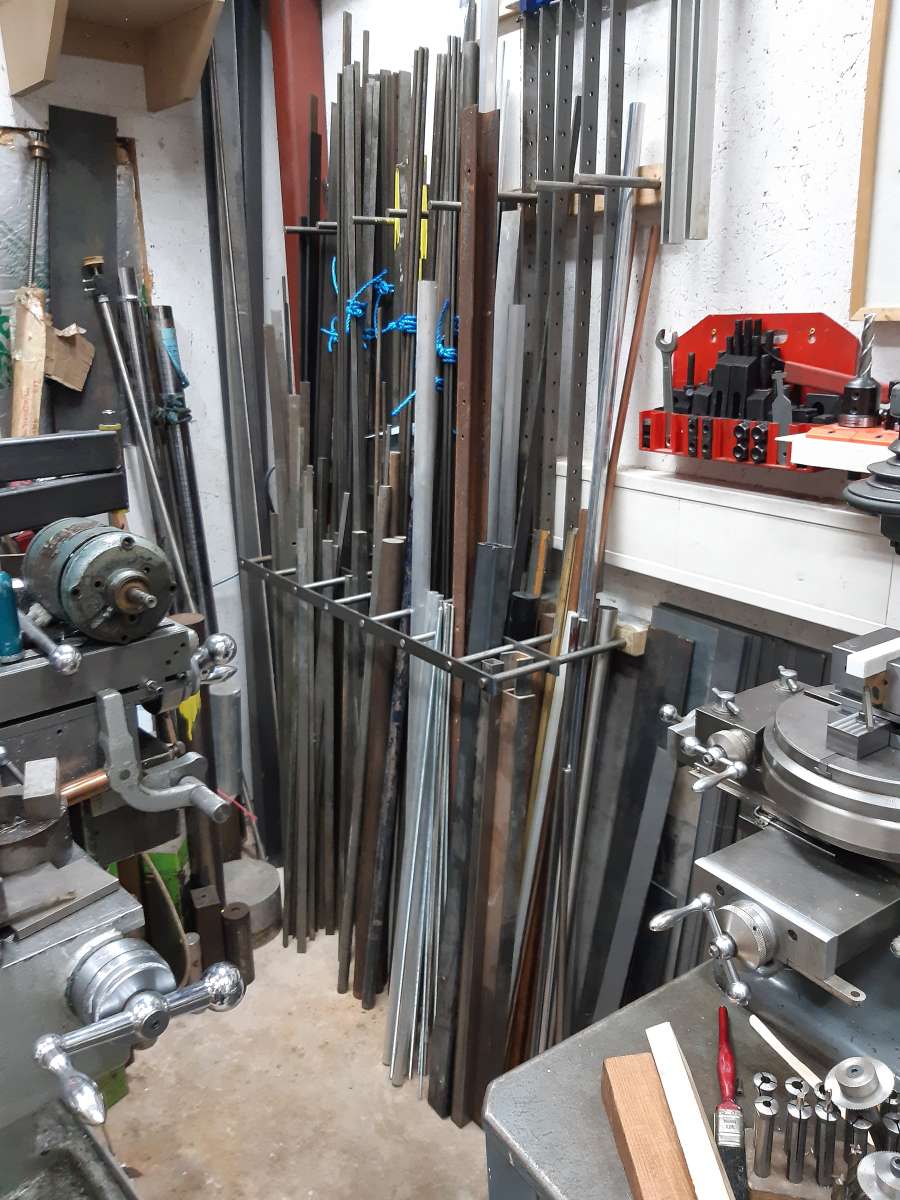

                                              On Friday i decided that I needed to break out and re-lay the concrete that (theoretically) controls water ingress from uphill next-door’s garden into the shed. This needed me to replace the button that works the switch on the Aldi electric road drill/demolition hammer that had broken off last time I used it.
                                              I found a bit of PE or PP plastic that had been used as packing for a bit of steel that I’d ordered, cut it to length and milled it to the right thickness. I mounted it on the BCA, since the rotary table would be useful for making the part. In doing so, I got annoyed with the mess of the collected metal stock between the mill and the BCA behind me. So I spent Saturday, Sunday and Monday moving it out of the way, hoovering the floor, making an extension to the rack and sorting and re-installing all the collected stock…
                                              breaker stock

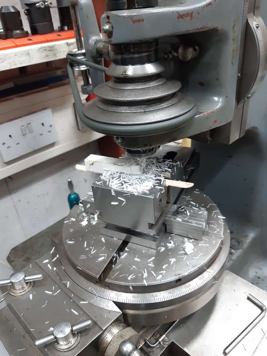

                                              Having tidied up, I got back to machining the bit of plastic.
                                              breaker swarf
                                              The machining was all, pretty much freehand. I Used some marking blue on the bits that the button needed to fit around as a guide to what needed removing.

                                              Eventually, I ended up with something that fitted and would work the switch without me having to reach my finger into the gubbins. The only remainder of the original button is sat on top of the handle:-
                                              Breaker final
                                              Tomorrow will be demolition day 😀

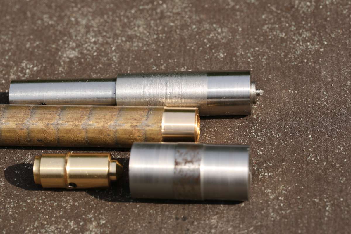

                                                    Tiny parts for the iron monsters… 🙂
                                                    NRvalveSeatInsts1
                                                    These are inner valve sleeves for the lubricators on (I think!) an S160 doer-upper in the shed at the railway at the moment. There’s a lubricator with 14 outlets on each side of the loco – each outlet leads to a pipe to a pivot or slide lubrication point, and has a nonreturn valve.
                                                    Not sure why, but each valve has two 6mm balls spring-loaded against seats. One of the seats is in the main body of the valve, and the coil spring that bears against it is located on the conical pip on the end of the sleeves in the pic. Inside the sleeve is another ball seated on the shoulder of the bottom 5mm bore and held by another spring located on a similar pip on an M12x1,0 threaded plug. The sleeve has bleed holes into the short 5mm bore at 25° angle to the centreline in the sleeve, and 45° in the plug – AFAICS all these do is increase the flow capacity above the 2,5mm central hole in the sleeve. Or maybe they’re to help the ball get back to its seat in the event of back-pressure?
                                                    #729988
                                                      On Mark Rand Said:
                                                      PS:- Why can’t I link pictures from a ‘gallery’ to the post???
                                                      You can … if you you know the URL
                                                      But they’ve made more bother than it’s worth
                                                      https://www.model-engineer.co.uk/members/markrand96270/mediapress/breaker/breaker-swarf/
                                                      breaker-swarf-675x900
                                                      Edit: __ I opened two instances of Safari on the iPad in ‘split view’ … one with my reply in the process of composition, the other with your image open.
                                                      Then dragged the image into the grey box that’s open in ‘insert image’.
