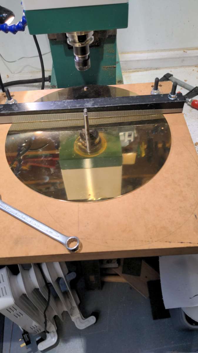

          Got set up to engrave the 5-minute marks on a 300mm brass dial and the main numbers, 3/6/9/12 – Novamill much too small to do the whole job in one bite so having to do “10 minutes” at a time, rotating the blank in between.  It’s taken 2 or 3 days to get this far, tomorrow the whole thing could go pear shaped…

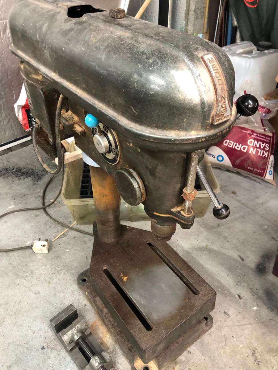

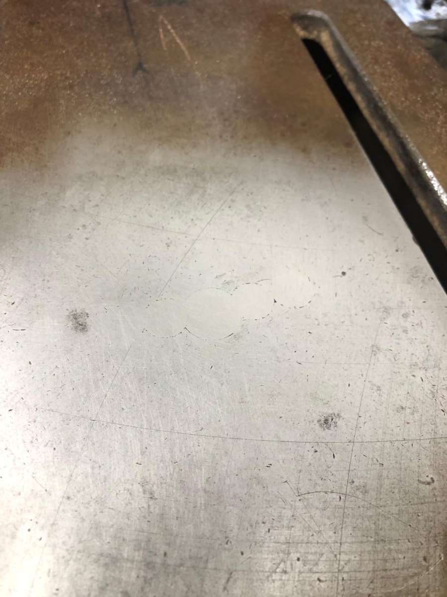

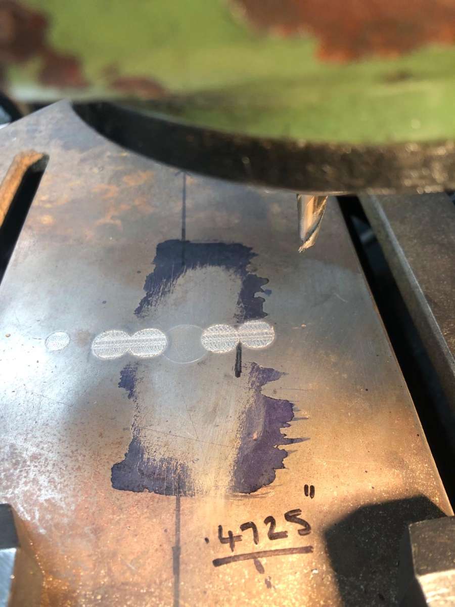

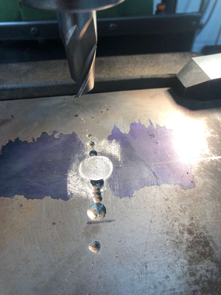

              76114ffb-a650-4ee7-aabe-05a13bfde708cac3911f-17b8-4977-acba-ce23ea4c4774Bought a very cheap Meddings drill from Facebook marketplace , lots of surface rust a smile of shame on the table and the safety collar that fits under the head is cracked, otherwise very little used. The Meddings table shouldn’t have a centre hole, someone had thoughtfully drilled one in, but not central to the table clamp slots. Decided it couldn’t be lived with so spent the afternoon giving the table a little TLC, slot drilled holes 5/16″ deep and plugged with little slugs of cast iron. Slugs went into the freezer for a while and tapped in, machined off as near to the table as I dared, filed and oilstoned flat. Doesn’t look too bad, not perfect but much better than before, pleasant afternoons work. Next job fabricate a new safety clamp, there’s one on ebay for sale, but it’s the same price as paid for the machine! 3781aecd-5291-4d71-9124-cc4fe5c95a82

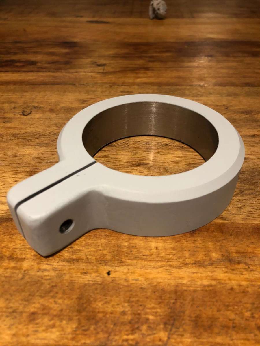

                Made the clamping ring replacement for the Meddings drill in the above posts, luckily had a suitable offcut of 4″ steel, so a lot of swarf and a bit of welding and we have a clamp. Tried to make it a bit casting like but it wont show much under the drill head.PHOTO-2024-03-31-21-08-26[3819]

                  Very nice job on the drill table repair Dave, quite possibly the most “invisible” repair I have ever seen. Clamp looks great too

                    Wanted to show it’s not a difficult repair,as long as there’s enough metal around the repair area, visited a friend the other day who had a new to him mill in lovely condition apart from an obvious divot out of the table. He couldn’t believe how easy it was to let in a little cast iron plug, and in his case it is almost invisible unless you have Superman vision. Must have been pleased he forked out for a pint!

                      I have 1 small peck mark in my otherwise clean mill table so would be interested in repairing it. Do you use new cast iron bar or old iron repurposed?

                        I’ve always used the continuous cast iron bar, it always nice close grain, mainly as I have odd offcuts knocking about. But I suppose any C.I would do if it was fairly close grained.

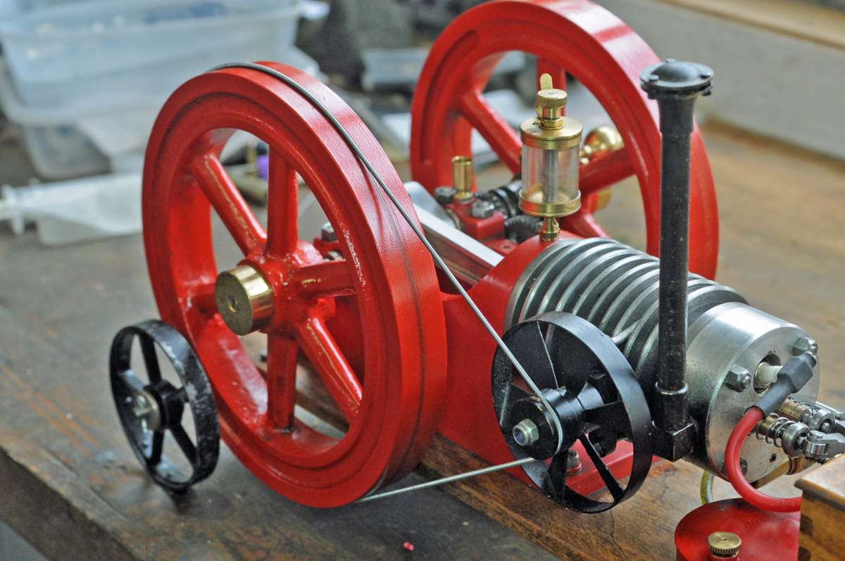

                            I replaced the O ring drive belt for the fan on my Farm Boy (which had perished).  The new belt is made from 2 Meccano spring belts from Alistoyshed on ebay .  I was a little dubious about whether it would drive satisfactorily compared to the O ring but it seems fine and, I hope, a bit more robust.

                              Nice, neat engine, Roy.

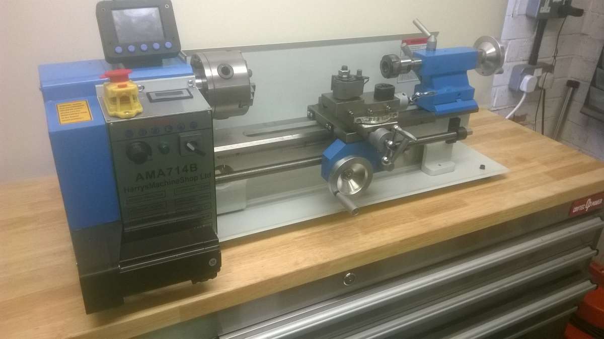

                              Today, I refitted the gear cover to the mini lathe, although there are no gears to cover as I’ve converted it to an electronic lead screw.  I’m particularly pleased with the pulley cover that completes the ensemble.  Now to revisit the saddle and apron assembly, which had given me problems since the lathe arrived a few weeks ago, all now sorted I’m glad to say.  Just got to replace the lead screw support bearing with one I 3D printed, as well as the lead screw protection covers.
                              Mini Lathe with els fitted
                              Now, what can I do next?

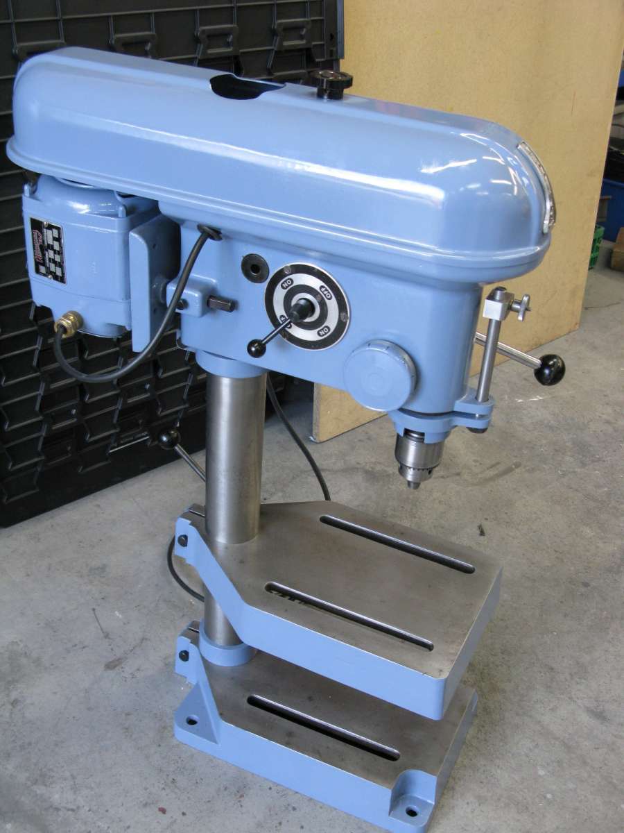

                                    Drill scruffyFinished rebuilding the Meddings drill I posted about the table repair a couple of weeks ago, photo at top is as bought but after table repair. Colour is quite a bit brighter than expected, probably through ordering from a tiny colour card swatch, grows on you. Very enjoyable job all round, had never dismantled a drill chuck before and after watching a sensible youtube video it turned out to be easy and worthwhile. Just got to tidy up and wipe the spray dust off everything and it’s back to the loco. But there is now a little Kennedy saw waiting in the wings….IMG_0588

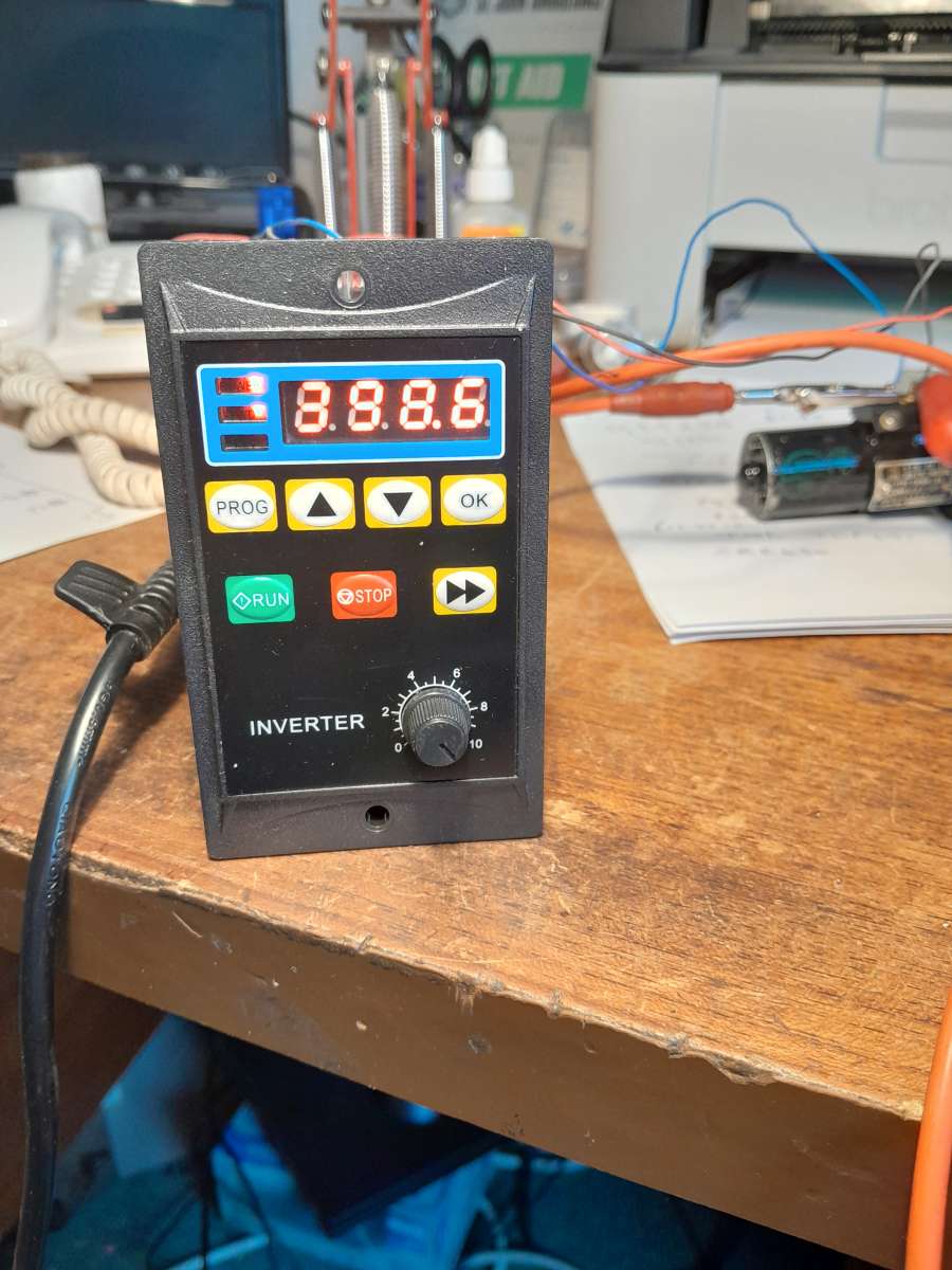

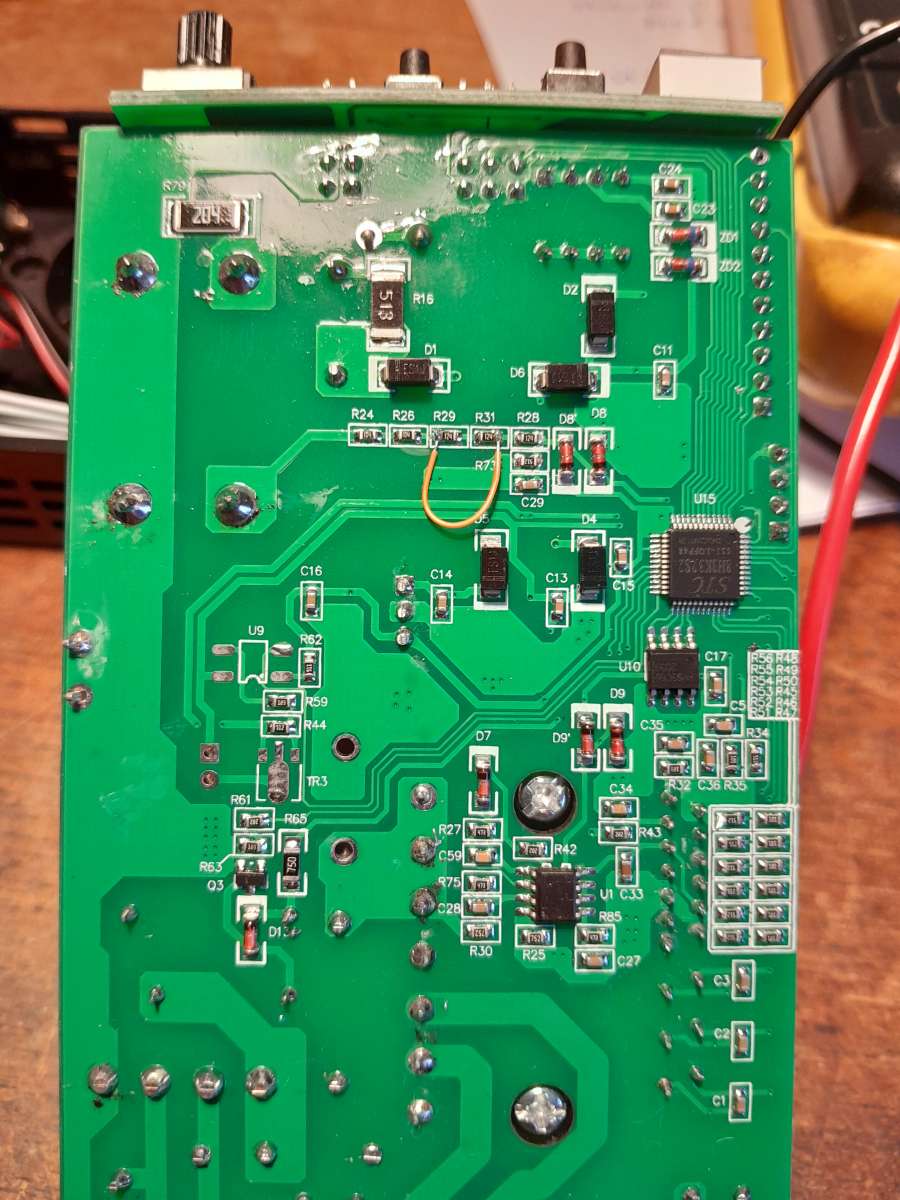

                                      Built a toolpost drill,  needed a motor.  Attempted to buy sewing machine motor – ebay deal failed.   My mind fell to using a 115 volt 400Hz motor I had handy – about 0.075Hp – it is a small driller!
                                      Bought a Chinese inverter UX-52-100 1.1Kw.  Yes it goes to 400Hz but only when outputting 240 volts.  A bit of fiddling with parameters revealed it would not limit the output voltage.  Running it on a variac showed it would throw a ‘low voltage’ error below about 150 volts.
                                      A look inside and a bit of thinking showed the internal supply chip SM7022C would be OK down to 85 volts and I found a suspicious looking resistor divider chain from the main internal DC which after a couple of diodes fed into an analogue input pin on the onboard 8051 microprocessor chip.  The chain was 56K into 5.1K made up of 5 resistors in series.  So I shorted 2 12K resistors,  closed the box up (I am scared of inverters) and voila it works if I run the input at 115 volts.
                                      The inverter cost £45 – far less than it would cost to build if you think of all the dead MOSFETs you would use up.
                                      Don’t try unless you have some idea what you are doing and don’t mess with live inverters.20240417_14324220240417_140810

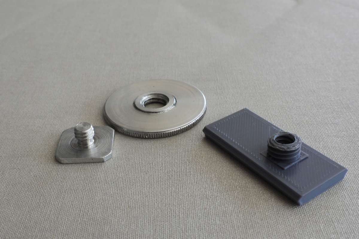

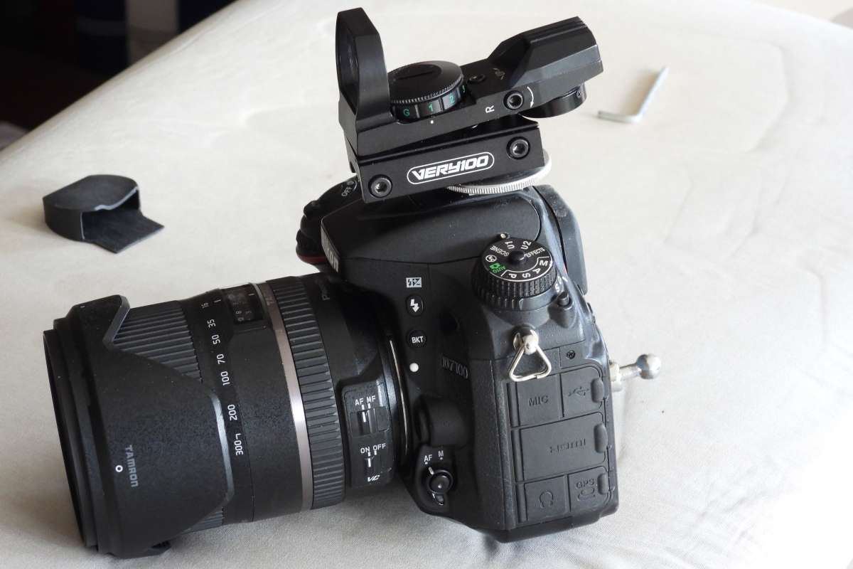

                                        Back in September 2021 peak4 showed a great photo of a dragonfly in flight.  He explained that he used a dot sight which fits in the camera hot shoe to help keep the quarry in view.  I’m afraid I’ve baulked at spending £100 from Olympus or £180 from Nikon but I found similar sights for airsoft and other rifles on ebay for c.£20.
                                        I had to do a little bit of machining and printing to adapt for use on a camera:
                                        spot finder 1
                                        spot finder 2
                                        Since my intended targets are likely to be at a range of 2-3m the sight needed to be angled down rather more than the built in adjustment allows so I printed the mounting threads at 3 degrees to the horizontal to give some tilt.  It took me quite some time to work out how to do that in Fusion 360 and I’m still not convinced that I struck on the most elegant solution.  If I manage any decent photos I will let you know!
                                        Rod

                                          Looks like a fantastic restoration Dave, just the sort of thing I enjoy doing

                                            Nice job, Dave.. ..Seems like a good opportunity to say “If anyone knows where there’s a top belt cover, I’d love to hear from you..”

                                              Beautifully restored drill, Dave!

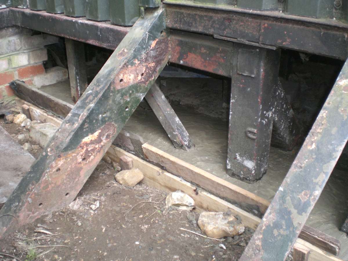

                                                I got on with may concreting job, which was to fill in a bit of flooring, where I have a bit of storage space, under my garage floor, which I’ve been meaning to do for quite some time, and then I can build a wall, up to the back end of the garage, which will stop all the leaves and dirt blowing in, and keep the cats etc. out. It was only about 500mm x 1800mm x 75mm, but it is in a bit of restricted space and with the steel holding the garage up, plus the two rails for the steps from the back door.
