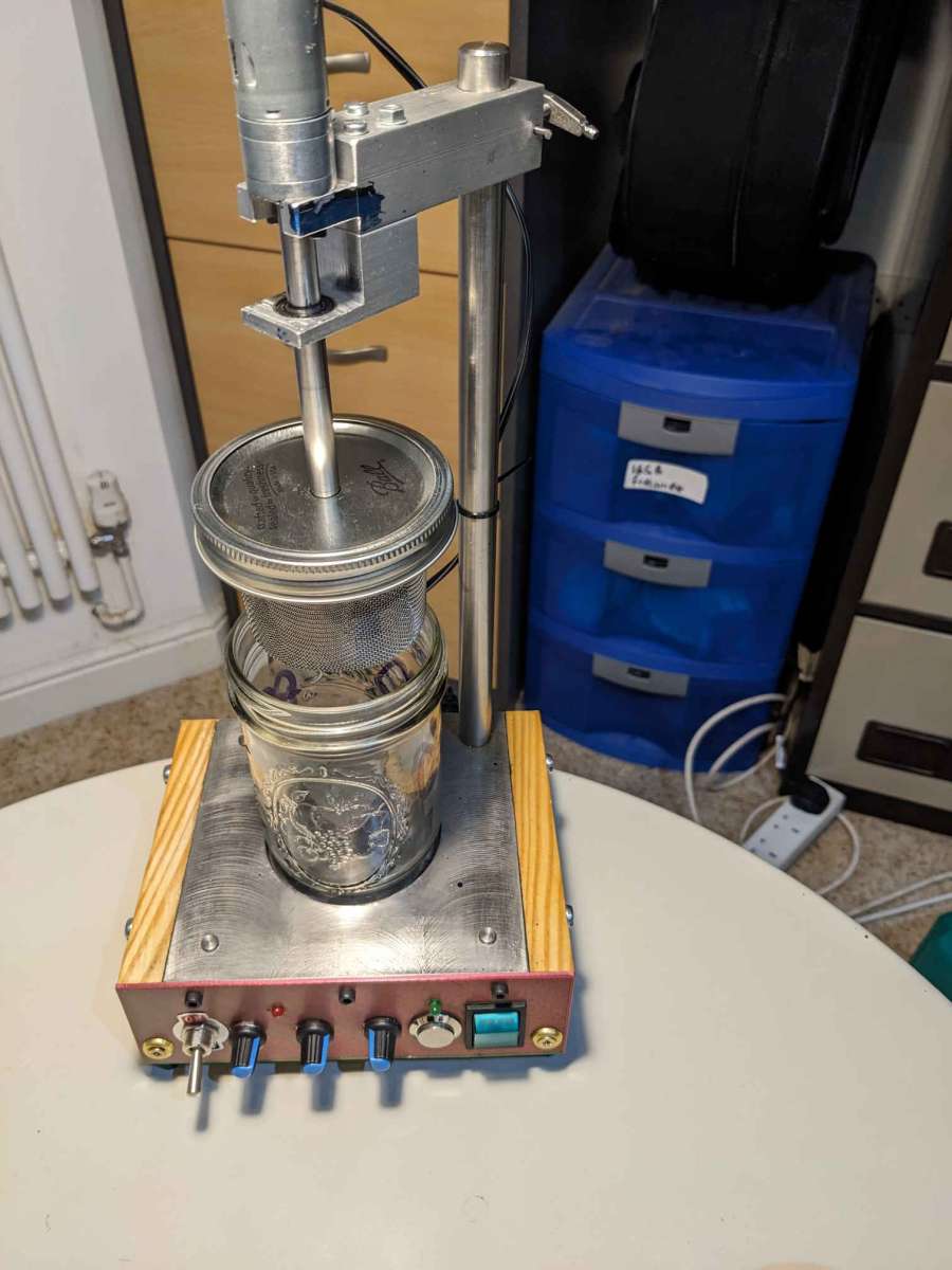

      Not quite today, I finished the (2nd edition of) my  washing machine.
      Not for mundane things such as shirts, but instead for watch parts.
      The first edition was semi-manual – a knob to control speed and a switch to set direction.  As one needs the direction to be changed fairly often (every few seconds), you can immediately see why version two was embarked on after only one attempted use!
      WatchWasherUp
      Above is beast in idle or drying mode.  The basket contains the parts (and indeed the basket contains baskets which  contain smaller parts, but thankfully the containment stops there).

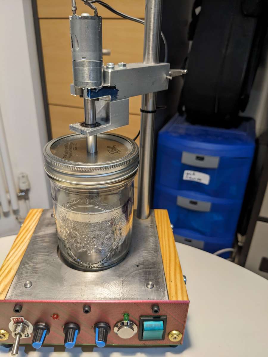

      Here is what it looks like immersed in the cleaning fluid
      PXL_20240224_145820377
      The jar is empty for photographic purposes.

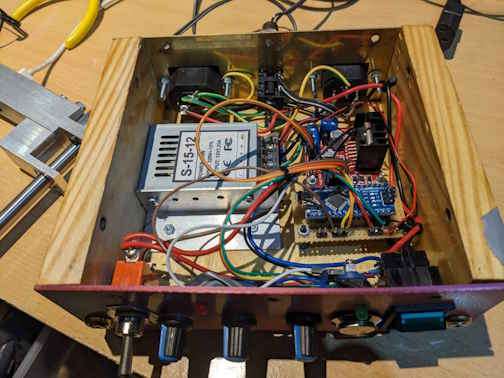

      And below is the rather unprofessionally laid out electronics.
      WatchWasher Inside tiny

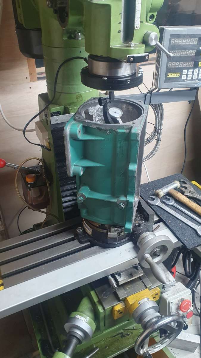

              20240229_212752
              Good job I fitted the riser block, the knee is fully down and I just have enough room to get the indicator in and will be able to mount a cutter directly in the spindle

                  Diogenes – In outline,  the motor swishes the basket clockwise then anticlockwise and repeats.  the knobs control the swish speed, the time in each direction and the overall time.  All controlled by an Arduino.
                  There are three phases.  The wash in which the washing fluid is lighter fluid and then one or more rinses which are in isopropyl alcohol.  The final phases is a drying in which the basket is raised and a tiny fan heater pointed at it (with the basket rotating).  The switch for the fan heater is on the right of the panel, but the fan heater not shown.
                  In each phase the basket can be lifted a little to be inside the jar but above the fluid and is run as a ‘spin dry’ cycle.
                  The main advantage of mine is that it is made almost entirely out of bits I had lying around which makes it several thousand pounds cheaper than a pro version!

                        Fine piece of work! Is the jar a Kilner jar?

                            Nigel.  I had terrible trouble finding a jar with straight enough sides (or rather where the mouth was nearly the same width as the insides).  These came from Lakeland, actually.  My motivation for straight sides was to minimise the amount of fluid used as zippo is not cheap.  In hindsight I would probably have taken a hit on the zippo as it took a while to find these.
                            The size of course was gated by the ‘jewellery cleaning basket’ into which the items are put.

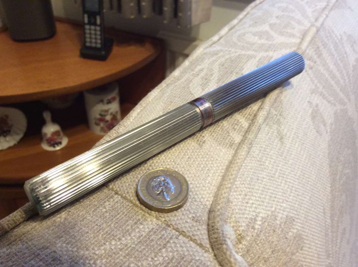

                                            85mm long straight knurls on 316, No Thanks but the shaper comes into it own once again!!!IMG_3483
