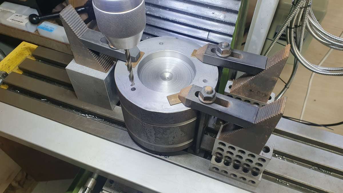

      Set the riser up on the mill to drill the holes. Most of the time was spent trying to get my head around the PCD function on the DRO. Once I had that sussed out I set to drilling. My plan is to through drill the entire block. I have drilled 1/4″ about 1.5″ deep and plan to follow that with a 12mm slot drill to correct any wander then use that to guide a 12mm drill to complete the hole. Hopefully this will ensure the holes remain straight.

        Are you planning to make an extra long Z-axis screw to accommodate the longer travel?  I’m assuming that’s my old Warco VMC in the picture.  The DRO Z-axis scale will need to be replaced with a longer one, too, I guess?

          Indeed it is your old mill. I had wondered if I would run out of Z axis travel but before I started the job I raised the table as far as I dared without winding the screw out of the nut (ill advised apparently) and the table came up surprisingly high, pretty close to the spindle nose infact. So considering that 95% of the time a vice will be on the table, as well as a collet holder in the spindle, I think I’m unlikely to run into trouble. Not forgetting the 75mm or so of quill travel too. The DRO scale is also fine.

            That’s good to know.  If you do decide a longer screw is required, John Mills (Doubleboost on YouTube) did a video or two on the subject for his Chester 626 mill.

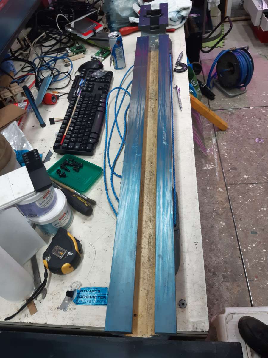

              After a day heat soaking the surface table and the ML7 bed I blued the table up and checked the lathe bed. After scraping off the raised ledges around a few long scratches from swarf caught in the carriage wipers and dents from things being dropped on the bed, I got a markup that shows that the bed is still pretty flat:-
              20240119_153121
              The blue on the surface table was freshly applied, so heavier than one would work down to when progressing through a series of scraping passes. Even so, the coverage is better than any of the machines that I’ve rebuilt so far. careful measurements of the thickness of the ways showed that the wear is actually 0.15 thou. This compares with the 0.12 thou that I measured when lapping and calibrating the surface table. Scraping the top of the bed would give little benefit.
              Careful measurement of the vertical sheers shows 0.8 thou of wear between the sheers on the front part of the bed. The sheers on the rear part of the bed show 1.5 thou of end-to-end variation. Which is confusing since the tailstock it the only thing that uses the rear, inside, vertical sheer. These measurements were repeatable.
              I think that the next step is to check and, if necessary, re-scrape my 48″ straight edge. Then use it as a reference to re-scrape the rear vertical sheer and use that as the standard to re-align the other three vertical sheers.

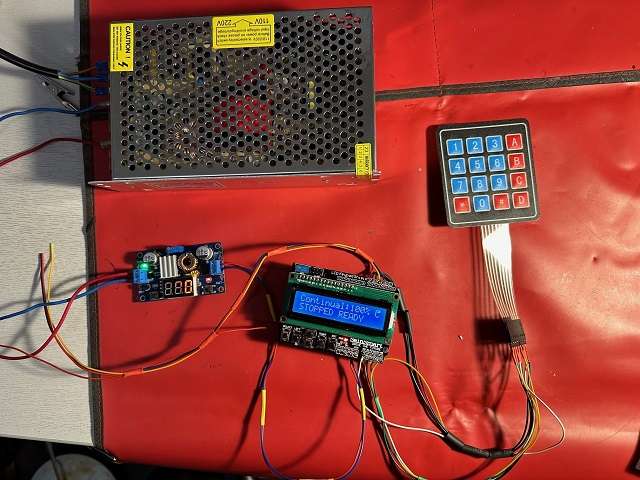

                    Last few days spent looking at Arduino Indexer.  I made the Steve Ward one several years but had also purchased the Arduino Uno R3 and Sainsmart LCD Keypad Shield.  Decided to try and finish the Arduino version.  Dave (SOD) has been very helpful and I am using his code rather than the Gary Liming or my original CFellows version.  I am still waiting for the Stepper Driver board but the membrane keyboard arrived today.  This was fun sorting out the pinouts.  I soldered it all up but the pinouts were back to front and upside down.  Eventually by referring to the code, the Arduino pinouts and my pinouts from the membrane keyboard I managed to get them all working.  I had a slight issue with the A0 pin as this is not brought out on the shield.  In end bit the bullet and soldered directly to the A0 on the shield where it is pinned from the Arduino.
                    IndexerWiringRes
                    Hopefully f the driver board arrives tomorrow I might get buzzing noises and meovemnet from the stepper motor.
                    Many thanks to Dave.

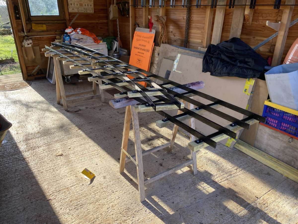

                      Treated 300 sleepers made from roofing battens by immersing in this stuff for 48 hours, let them ‘dry out’ for 7 days, then jig drilled pilot holes for the coach screws.
                      Lifetime wood treatment
                      You can see all sorts of comments for this stuff, but I treated my wooden garage in 2018 with it and there are no signs of mold or fungus etc.
                      Yesterday, I spent a busy afternoon screwing them to the track – that’s another 24meters of track done.

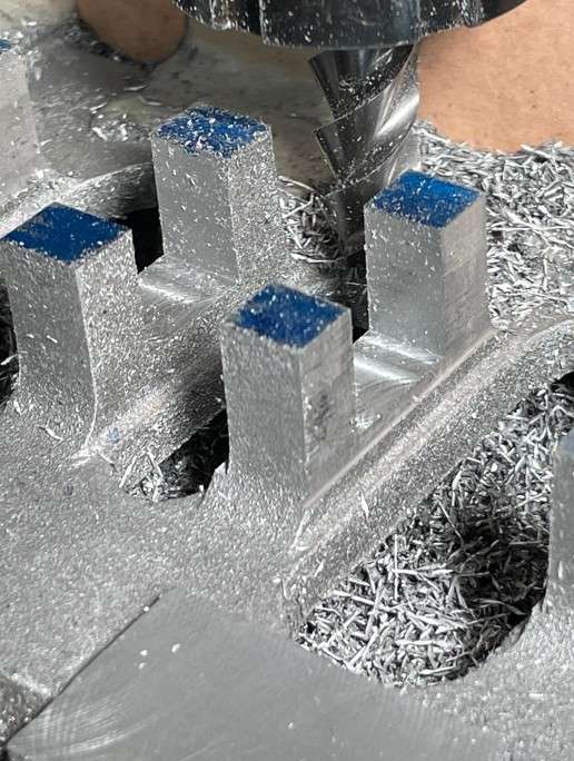

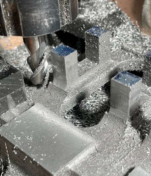

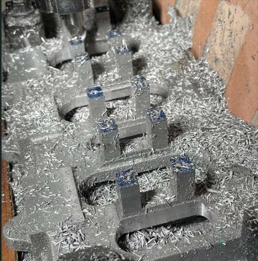

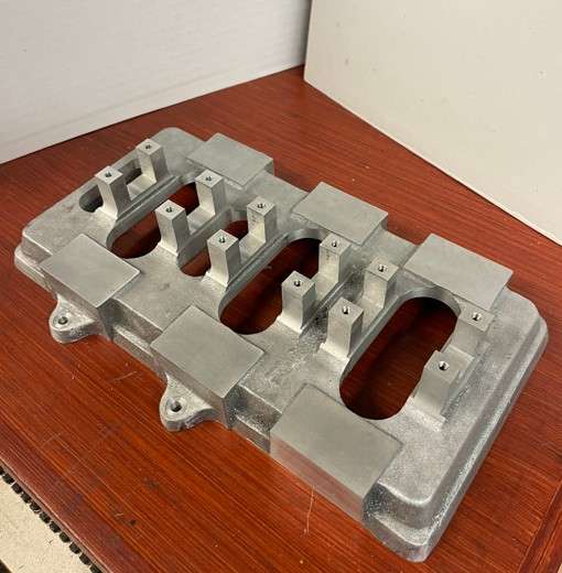

                        Not so much what I did today but an elapsed month. The OB Bolton Triple expansion engine bed plate emerges from lots of swarf despite being frequently vacuumed up at the end of each stage. The aperatures for the crankshaft and eccentics we milled both sides then I used a boring head to generate the radiused ends. Using a large normal HSS milling cutter would have caused a lot of chatter and inaccuracies with coincident faces (and my Tom Senior E Type only has an ER25 chuck and wont take a 15/16″ cutter anyway)
                        1 swarf
                        cuttting the back faces of the main bearing stands to .312″ wide
                        2 edge facing
                        Using a 10mm ballnose carbide to blend the machined faces to the casting line and to the edge of the main bearing reliefs
                        3 ball nose
                        Using the 3 flute carbide alloy cutters was almost silent when cutting and left almost no burrs, even so it will need some careful attention on those very sharp corners. Even with DRO precision, its best to measure a lot, the main difficulty being able to measure the width of the main bearing stands i.e. along the crankshaft centre line. Other than the end stands, you can’t get a normal micrometer in, so checked with my trusty digital callipers. If I did it again I would make some test gauges.

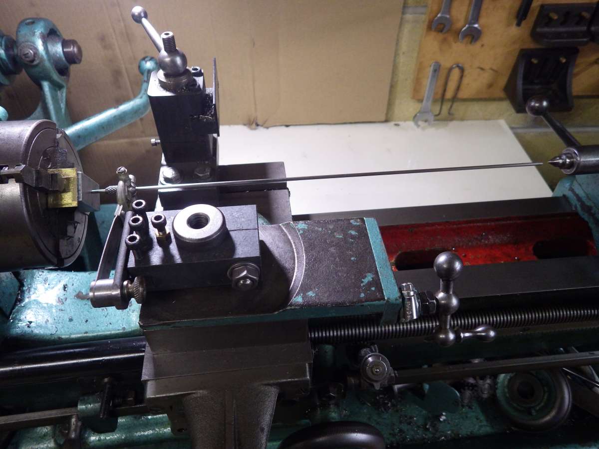

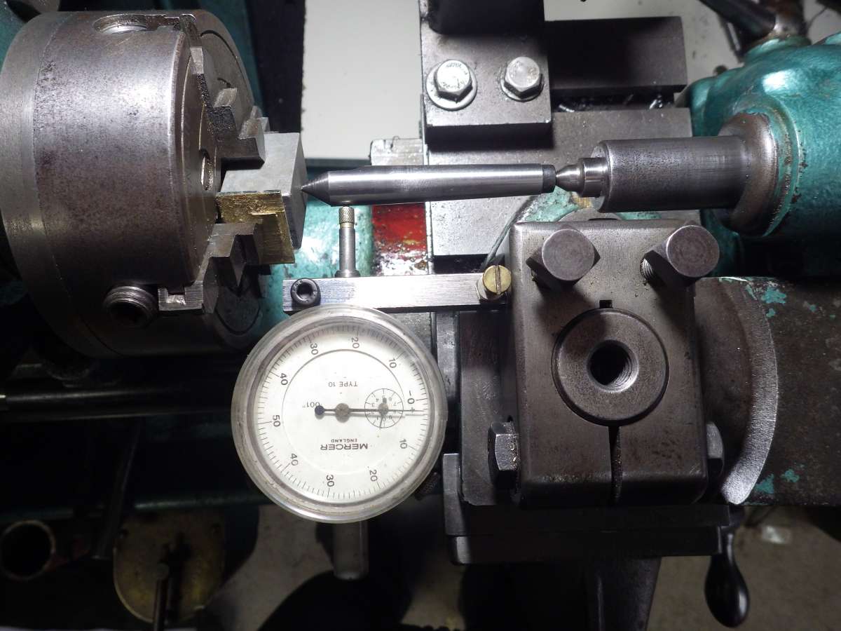

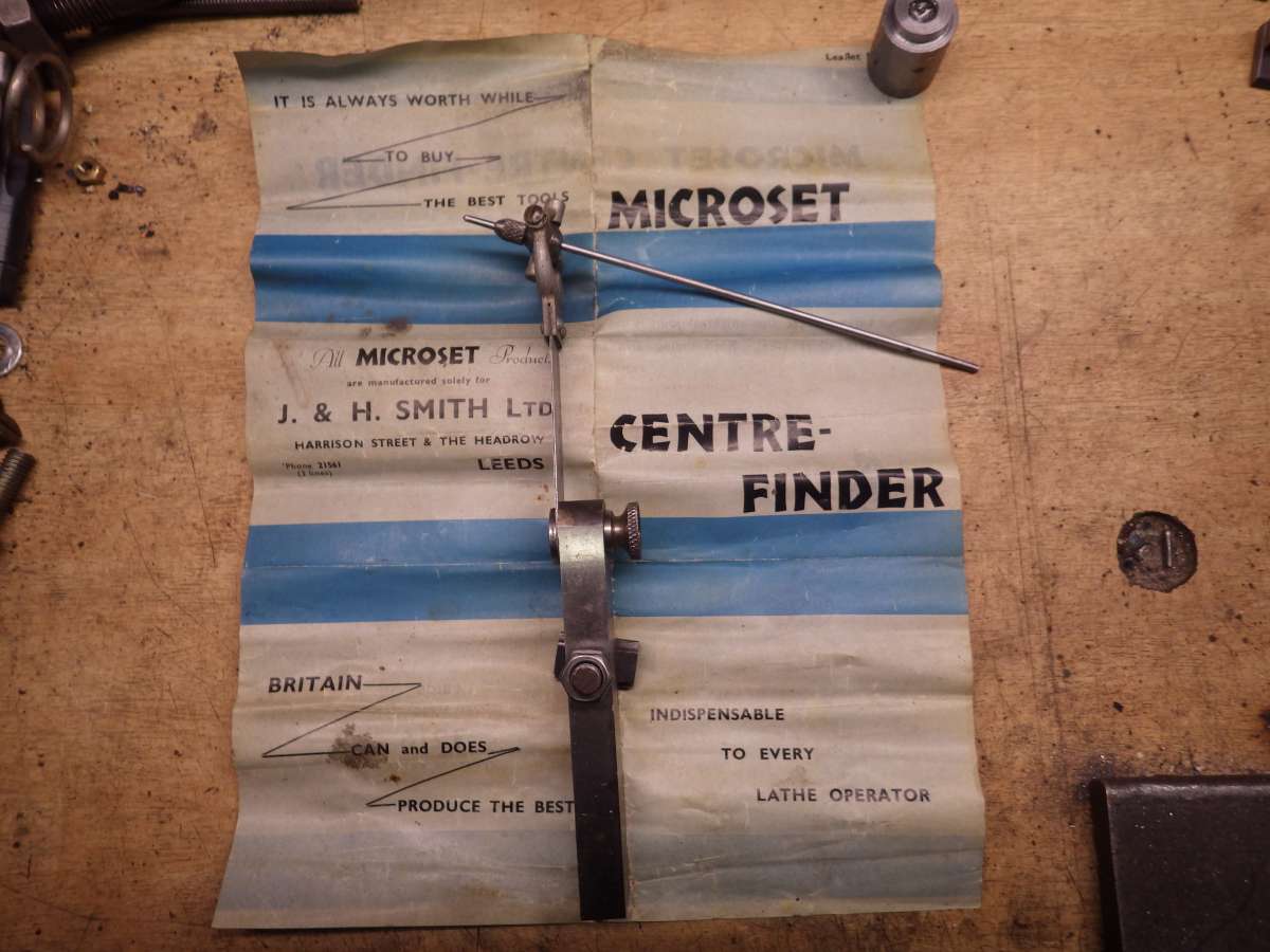

                                      Some considerable time ago I bought this centre finder from a car boot stall.
                                      IMGP1413
                                      It is designed to be held in the lathe tool holder with the point in a centre pop and you adjust the workpiece until the far end stops wobbling when the work is rotated. Unfortunately the stock is too large to fit the tool holder on my Myford M type. I’ve used it a few times, by bolting it to the cross slide, with some success despite the indicator arm missing the extension piece.
                                      I’ve now modified it to fit my newly made tool holders and fitted a longer indicator arm.
                                      IMGP1415
                                      I’ve just tried it out and checked the result using a dial indicator and centre, and it shows the centre pop within 0.002ins of being true. With a bit more fiddling I probably could have got it closer, but close enough for most purposes.
                                      IMGP1411
                                      J & H Smith iron mongers of The Headrow Leeds have long gone, replaced by less interesting shops. On the reverse of the leaflet it states the price as being 32/6. It also states that the spring leaf and gimbal are cadmium plated to resist corrosion. I’ll try not to handle it too much by those parts in future.

                                        I have one similar to that which was bought from a club sale and was told it was made from a kit in the 70’s
                                        #711252
                                        duncan webster 1
                                          @duncanwebster1
                                          I just have a long thin rod with a point on it. Grip one end in the tailstock chuck and apply the dial gauge near the job with the point lodged on the centre pop. Loctiting a bigger bit near the point end made it better. I’ll take a picture if it is of any interest.

                                            3rd attempt at posting this, previous 2 just disappeared. Not so much as what I did today, more like over the last month. The O. B. Bolton marine triple expansion engine bedplate casting slowly emerges from a pile of swarf, even if frequently cleaned up after each step.
                                            1 swarf
                                            Using a 10mm 3 flute ball nose carbide cutter to blend in the sides of the main bearing stands to the casting and level with the main bearing reliefs. These cutters are particularly sharp giving an almost silent cut.
                                            2 ball nose

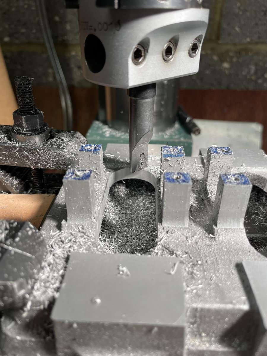

                                            My Tom Senior model E has a 2MT/ER25 collet adaptor fitted and it won’t take a 15/16” dia cutter to clean out the casting radii for the big end and eccentrics clearance. Even if it had, it would most likely caused a lot of chatter, so it was down to the boring head which worked out well.
                                            3 boring
                                            Except for the 2 extreme end stands you can only measure the longitudinal thickness of the middle 4 stands with digital callipers. Some deburring needed now then on to the 6 gunmetal main bearings.

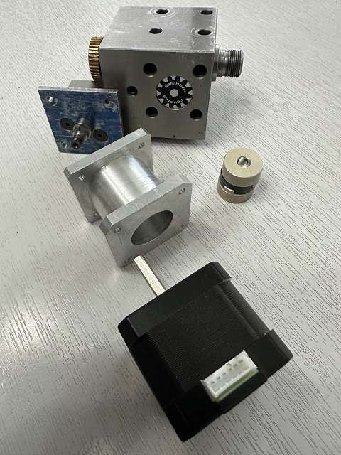

                                                      I posted the following to What Did you do Today on the 5th.  It appeared to completely vanish into thin air.  So tried again to repost today.

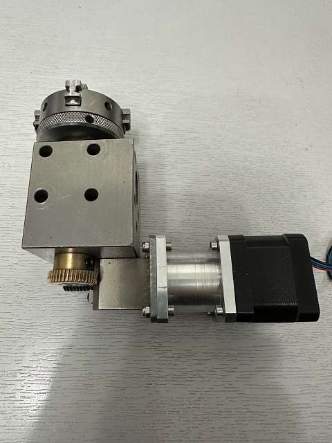

                                                      Machined adaptor spacer to join NEMA 17 stepper motor to Cowells Dividing Head.  Also made backplate cum thrust washer to fit on dividing head.  This was made form a piece of gauge plate.  This will take the wear (better than the aluminium of the spacer) of the spindle on the worm gear.  Next step is to to shorten the stepper spindle and add an 8mm dia bush.  Bore out the HUCO joiner to 8mm both sides.  Make an adaptor to convert the 6mm thread on the worm spindle to the 8mm bore of the HUCO.
                                                      Hopefully by the time all this is done I should have finished assembly of the Arduino Controller which uses Daves (SOD) stepper software.  Just waiting for some 2.5mm brass screws from supplier.
                                                      CowellsDividing Head Pt1Res
                                                      Yesterday finished all adaptors and assembled on the Cowells Dividing Head.  All appears to move freely enough.

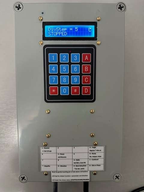

                                                      Finished assembling the Indexer Controller.  It all powered on okay.  Plugged stepper into controller and all works okay.  Main thing to remember is that the ratio of the Cowell Dividing Head is 40:1 not the relatively standard 90:1
                                                      AssembledStepperDividingHeadRes
                                                      AssembledIndexerRes
                                                      Just need to fit on mill and do a proper test.  Will borrow gear cutter of mate and see how I get on.
