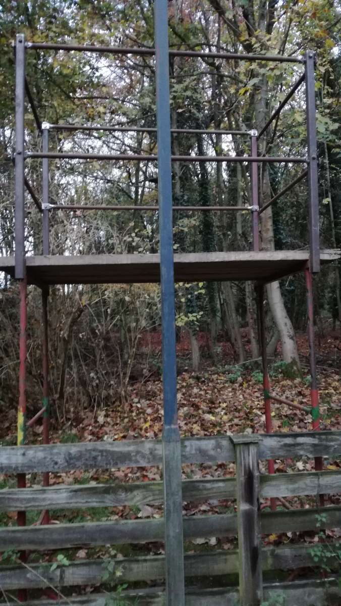

      Hi, finished making and erecting guard rails to two of my builders trestles, so I can replace my security lights safely.
      IMG_20241118_160109
      Regards Nick.

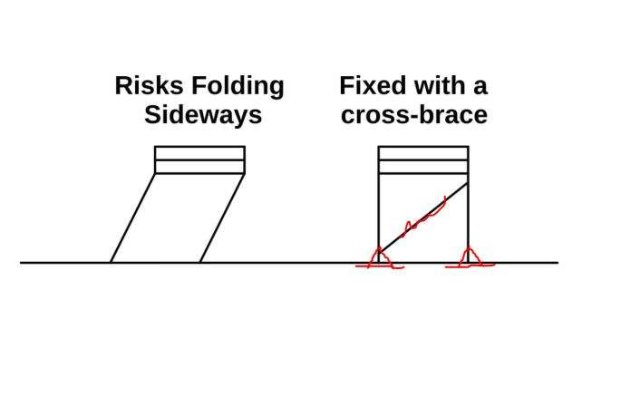

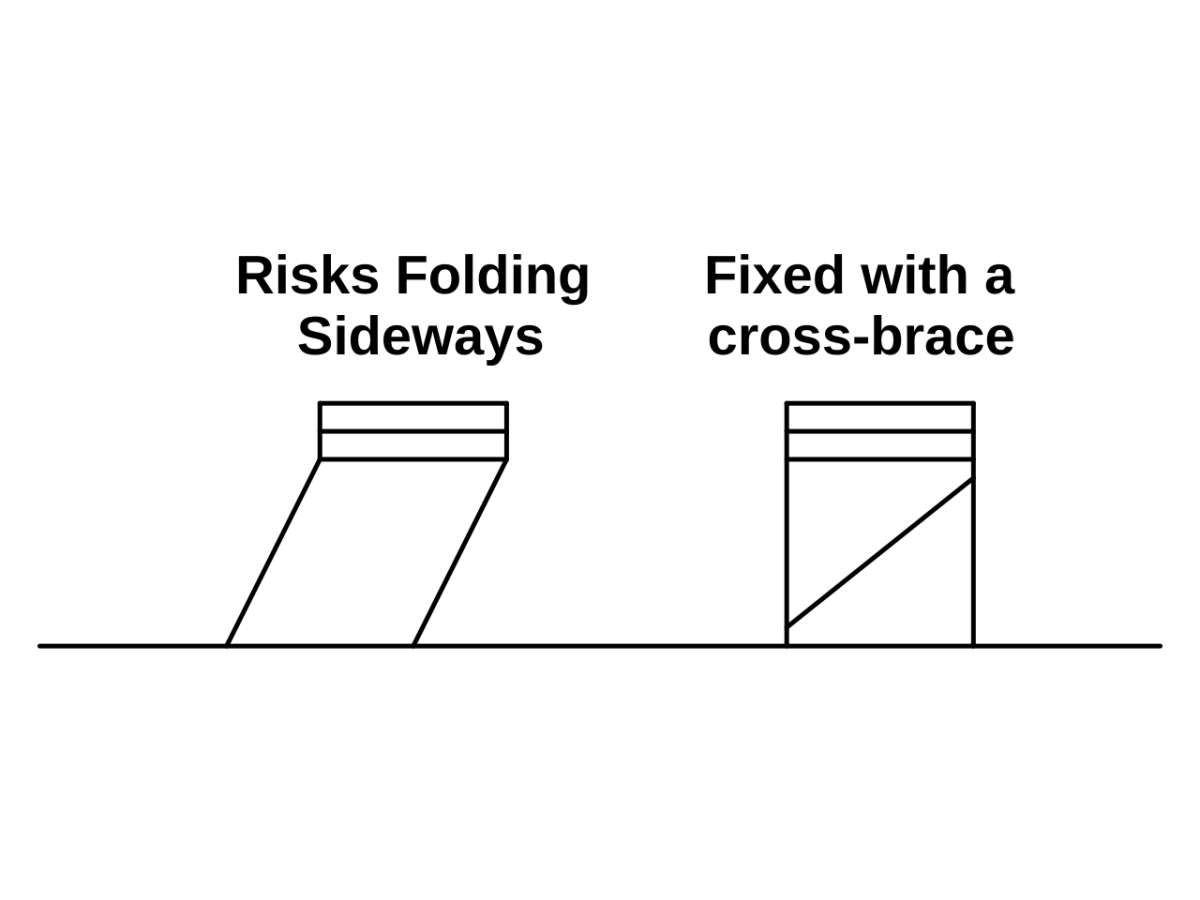

      Good job on the platform Nick, but I can’t see anything to stop the trestles folding in parallel and collapsing.  Perhaps hidden at the base? If not already addressed, easily fixed with a diagonal cross brace, or maybe two:
      crossbrace

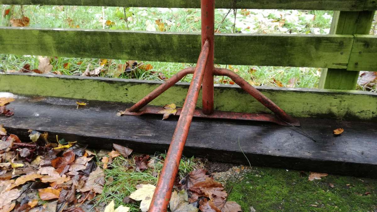

        Dave they look to be based on a pair of builders “bandstands” these have feet and two diagonal braces to each. Have been used for years on building sites without any issues.
        bandstand

          Hi Dave, well these types of trestles have been used for donkey’s years, Builders Trestles by builders, and others, and myself, and I’ve not, and I don’t know anybody else who have used this type, for them to have encountered or tendency for them to fold and collapse as you have shown, plus the ones shown, would have to shear off eight bots which are holding the corner posts onto the trestles.
          Regards Nick.

            Of course they have.  Problem is I can’t see any braces in Nick’s photo.  Are they hidden somehow?

              Hi Dave, they are the same as those in the link in my above post.
              IMG_20241118_155502#b
              The whole thing will be tied to the green post, while working on the platform, for extra security anyway, and that post is in the ground by about 1100mm or so.
              Regards Nick.

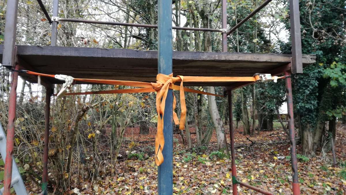

                I would strongly suggest not relying on just clamping or lashing that platform to the light pole. Fit a pair of diagonal braces from the outer corners of the platform itself, back to secure anchorages in the ground.
                I would also turn the two outer feet and their ground-pads through right-angles to put their thrust outwards.
                Those light trestles are indeed used by builders, but normally on level, solid ground; and even full scaffolding is given such external bracing wherever possible.

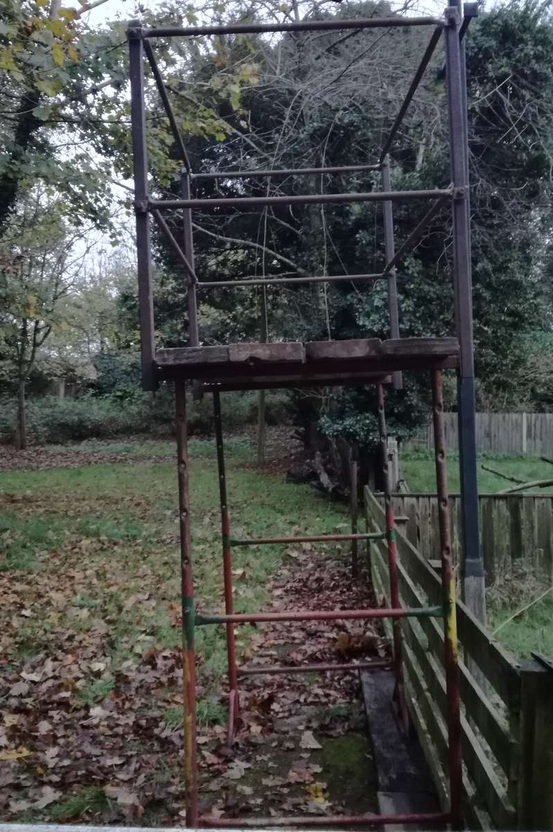

                  Hi, a couple of photos for the benefit of Dave (SOD)
                  IMG_20241119_132023#b
                  IMG_20241119_133340#b
                  Nigel, I’ve used ratchet straps, just as a precaution, should for any reason it falls away from the lamp post, but I think it will be highly unlikely to do so, it is actually on concreate, all be it on wooden timbers, which will prevent it sliding in all directions.
                  I’ve managed to get up onto the platform today, when the whether was better, and have succeeded in removing the old lamps from their brackets, but the bracket bolts don’t want to come undone, so a cutting disc in my mini grinder, will have to sort them out.
                  These trestles are rated at a 450kg load each by the way, so I don’t see any reason they should collapse, with just myself on them.
                  Regards Nick.

                    And yes you can see the tops of the braces in Nick’s original photo.
                    I really don’t see the need for any additional bracing but I’ve been in the construction industry and seen them used all my life without any other bracing or tieing in to the structure or outriggers as you see on the aluminium towers over a certain height which Nick’s bandstands are below as they look like No 3s.

                      Hi,  yes, way below some of the towers that I’ve put up and worked on.

                        The tower looks like a pair of trestles which are safe to use with boards and have been for many years. All that has been done is to add a guard rail system. If this did not have the feet, then yes, diagonal bracing would be required.
                        For all of 27 years in the tool hire trade I have not come across any problems with this design except those that choose not to use them correctly.

                          I wasn’t questioning the structure itself but the photo made it look as if standing a bit out-of-vertical, on boards, but those on a garden.

                              Hi Nigel, the trestles are near enough vertical according to my level, the leaning  look is probably due to the angles I was taking the photo at, on my phone.

                                Those trestles are ok ‘cos they are old. From experience don’t trust the welds on a new pair.

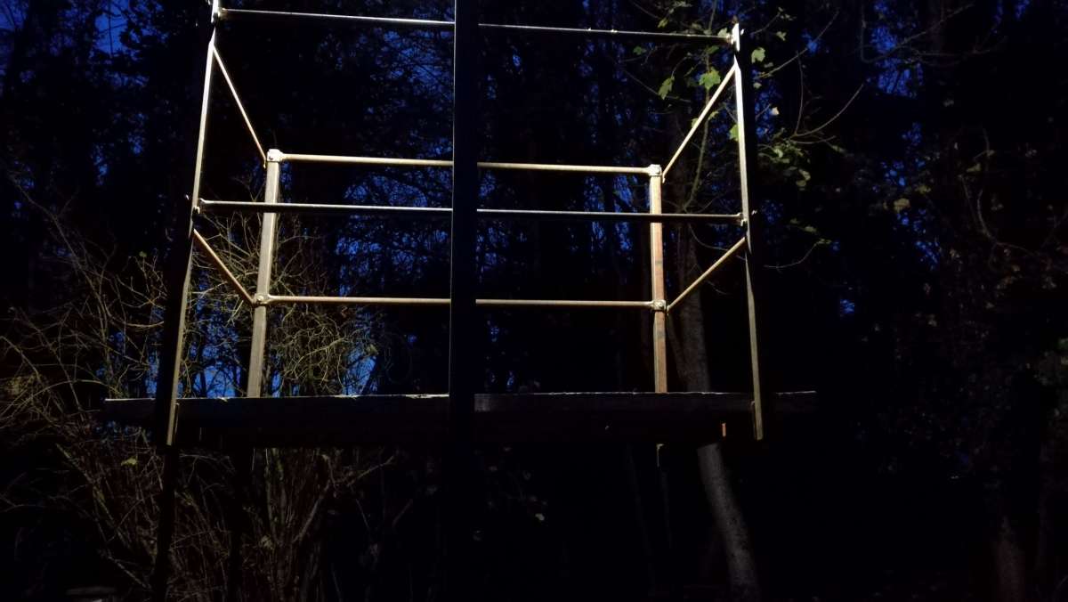

                                  Hi, let there be light, that’s to say my new security lights are now working, and my platform / trestles didn’t let me down,
                                  IMG_20241121_163437
                                  Regards Nick.

                                    You can even leave the trestles up for a machine gun post. 😀

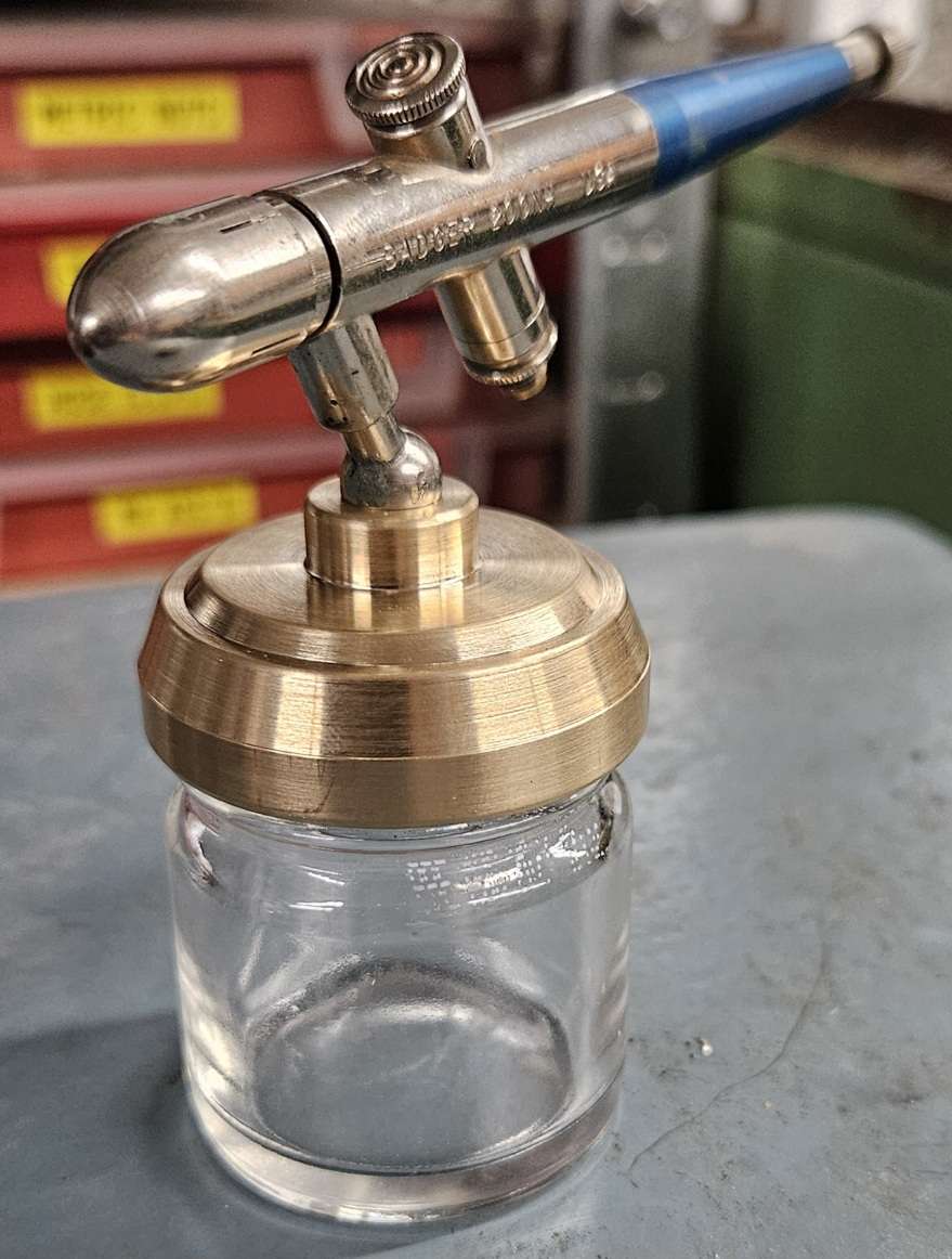

                                          I’ve had a Badger airbrush for many years, always been a fantastic tool.
                                          But the tin plate lid of the spray jar has seen better days and I can’t source a replacement.
                                          Having had a coffee and a scone at my local tea room I found they had a huge supply of empty miniature jam jars, about the right size for my air brush.
                                          I didn’t like the idea of trying to modify the flimsy steel lid by fitting a threaded insert into it for the paint pick up.
                                          So I set out to turn a whole new lid from brass complete with an integral threaded boss to take the pick up pipe.
                                          Turning was easy and a dremmel tool cut the material away to create the female “thread” to fit the jar.
                                          Looks good and works a treat.
                                          20241123_155802

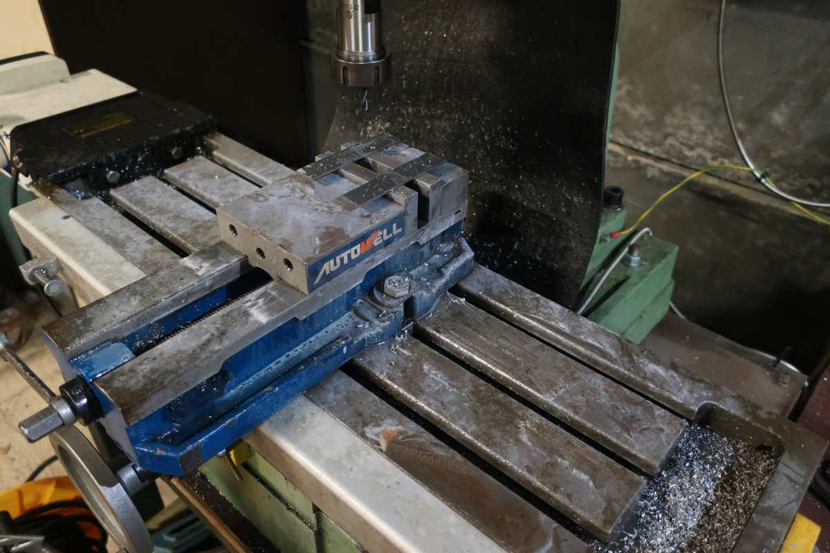

                                                  Yes, nothing like a good warm front.. ..But I did get some work done nonetheless and have only got a few bits and bobs to finish before seeing if I can get my engine to run..
                                                  Edit – not suds, just everything wringing wet..
                                                  IMG_2555
                                                  IMG_2556

                                                      These may not be metal tops but having a set means that if you are spraying different colours at the same sitting save cleaning out after each spray.
