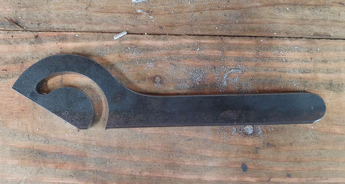

                          Meanwhile I started making a spanner for an ER40 chuck I recently acquired, yeah I could buy one for £15, but wheres the fun in that.
                          20240705_132024

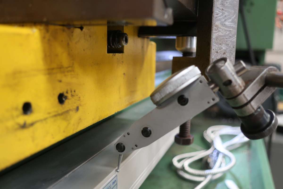

                            Took an old shirt to use for rags into the workshop yesterday, and after about 5 minutes ended up wearing it again.. 12 degrees. Too much head scratching to be cold
                            IMG_2488

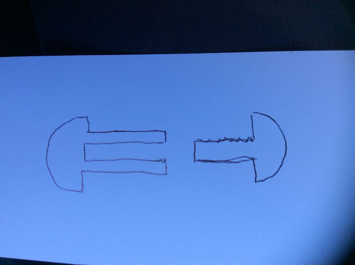

                                    If you want rivet heds both sides you might try this but not for the faint hearted, its a fair bit of machining time but they look goodIMG_3625

                                      How do you tighten a screw/nut with no flats and no slots? Let alone undoing after a few years even light corrosion.

                                          Bernard, please don’t think I was getting at your suggestion. I was expecting someone to explain a special rubber friction device or a screw slot on the inner end.

                                              Bernard, Bazyle –
                                              A good point. You do need some way to grip the fastenings but I found by experiment enough friction to tighten the nut sensibly.
                                              If you use the hollow-stem design you suggest, those inside the structure could be given a screwdriver slot.
