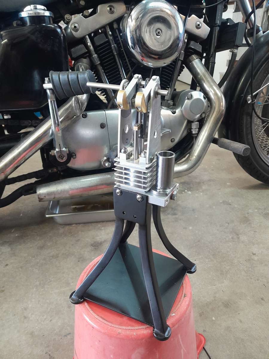

                Bit more progress on the Moriya II Stirling engine fan, after a hiatus to get my 1977 Harley started for the riding season. Tossing up which is the more modern engine, the 19th century concept Stirling with its aluminium cooling fins, or the 1977 Harley still baking its heads with cast iron.
                Got the Moriya legs painted and they came up looking good despite all the ironmongering involved in bending that angle iron in the vice and the pigeons that roost in my workshop every time I get the welder out.
                And got the displacer, connecting rod and cross-head assemblies all done. Needs a bit of fettling to get absolute friction free running, but onward through the fog. And now on to turning the 1″ diameter round “cold end” from a bit of 1.5 inch square steel bar so it can have a nice integral square flange on the mounting end. More chips than job by the time the 1″ round bit is bored out to .950″. The trickiest but most satisfying bit of machining in the project. I hope! We’ll see tomorrow.

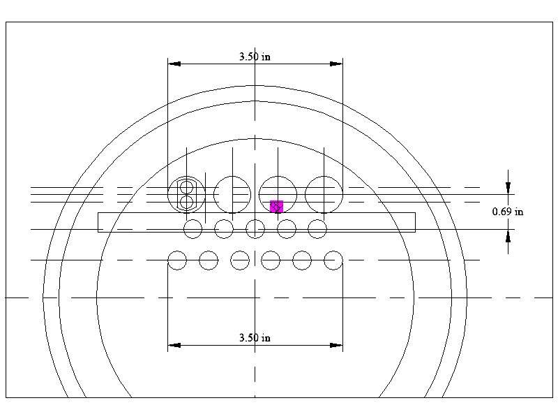

                  Realised I’d “designed” myself into a corner… of a cramped smokebox.
                  Taking a lot of advice on this forum I started to design the superheater for my steam-wagon… then realised it cannot be installed or removed!
                  Not without potentially a lot of modifying of the existing smokebox.
                  One reason for the lack of space is that unlike in a conventional locomotive-type boiler the superheater flues are close to the top of the barrel, not something like a third to half way down.
                  Another is the smokebox is quite short with the chimney entry occupying most of the length.
                  The simplest, I have decided, is to make the door ring removable, by replacing all 24 of the 3/16″ rivets that hold the door ring with slot-less round-head screws and nuts; and this evening, experimentally replacing just one proved hopeful.
                  Eeh, it’s not one thing it’s another!
                  The partial drawing shows the problem. The two outer concentric circles are the smokebox shell, the inner one represents the door opening and boiler barrel (same diameter). The pipe entries not shown are through the intervening ring, on the left, roughly where the tube centre-lines cross it.
                  So the superheater assembly could not be inserted or removed through the door aperture. It might have to be built on the rear ring of the box, then that lot put on the boiler and the barrel assembled onto it: a difficult and delicate process risking serious damage to the elements.
                  The rectangle was a trial location for one of the headers, and it does show the snag.
                  Ignore the strange purple square too: I have no idea what it means, and it cannot be deleted, but I think was due to my inadvertently selecting some tool (in TurboCAD) unknown to me!
                  Superheater Layout

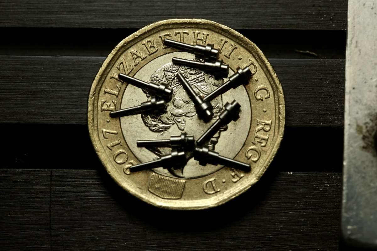

                              Interesting LITTLE turning job today.S11A7146

                                  Bernard, what are those?

                                      They are parts for Smiths Chronometric Speedos/Rev counters. I rivet them to a gear wheel and the pin then transmits movement to another train. The largest dia is 0.079″and the smallest is 0.027″
                                      #739248
                                      Ian P
                                        @ianp
                                        Those parts are impressive Bernard. What lathe do you use for parts that small and how do you grind the toolbits?
                                        Ian P
                                        #739261
                                        bernard towers
                                          @bernardtowers37738
                                          I have a couple of Peatols with various mods to make life easier, they have quite high spindle speeds available (9000) which gives a good finish on small dia’s with a mixture of digital readouts and strategically placed dial gauges. Tool bits are a mixture of hand ground and t&c ground but polished up by hand. They are nothing fancy just the old fashioned LH/RH, V ,Parting and boring. I do have a boring tool that will go into a 1.5mm hole thats when it gets exciting. It really is standard turning but a bit smaller and you of course need a good pair of magnifiers which changes everything as then everything then looks the right size!!

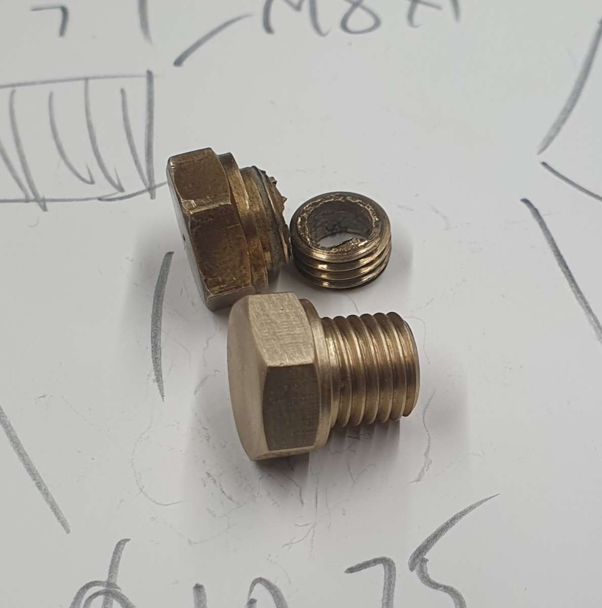

                                              This evening I have made a new bolt that retains the float bowl on the carburetor of my dad’s lawn mower. I have omitted the hole as I can’t see a reason for it to be there and it played a part in the failure of the original. If for some reason it gives problems it can be added later.
                                              The M8 x 1mm thread was screwcut for lack of a die.
                                              20240703_213254
                                              #739366
                                              Diogenes
                                                @diogenes
                                                Nice job.
                                                In a lot of similar carburettors the recess is usually there because the main jet is located immediately above it in the same vertical gallery.
                                                #739382
                                                Craig Brown
                                                  @craigbrown60096
                                                  The bolt does indeed share the hole with a jet and like I said to my dad, I can’t imagine Dellorto would have put the hole in the bolt if it didn’t need to be there, but we will try it later and see
