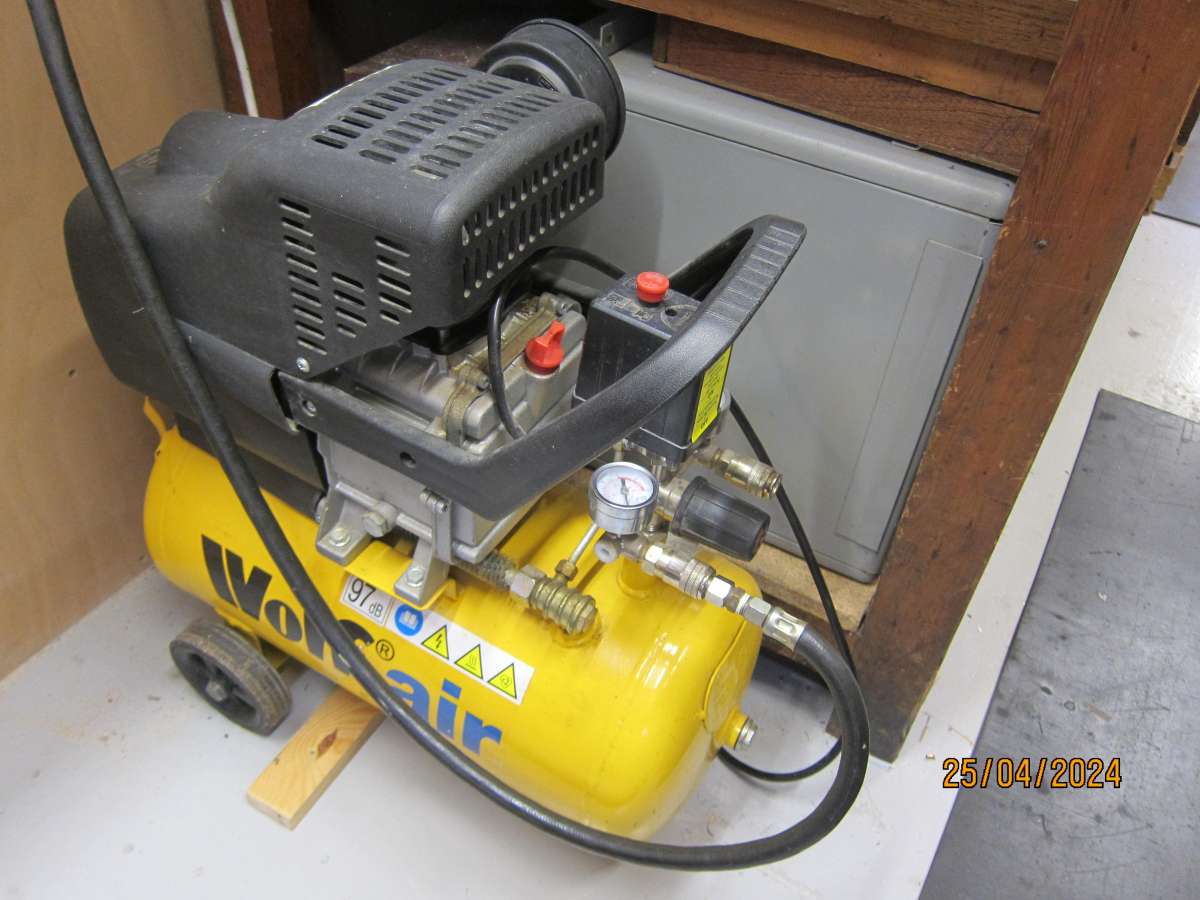

          I picked up a Wolf type Sioux 25 (litres) unit some years ago and have been very happy with it although as Jason has said, it does tend to make you jump when the motor kicks in. I think the current Sioux models are 50 litres in capacity. They are very well made and come with two outputs, one of which is regulated, the other being at reservoir pressure.
          #727567
          Greensands
            @greensands
            IMG_0791

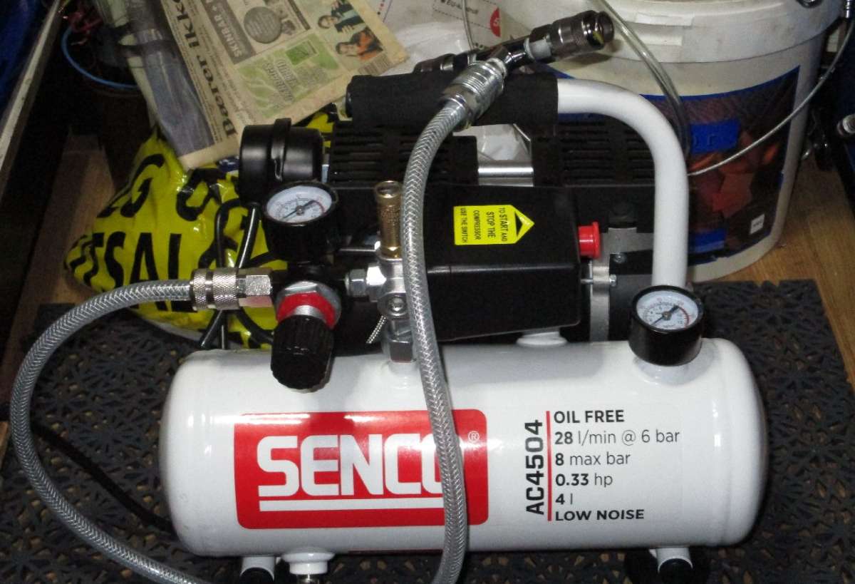

                            I am now using this compressor to run my small model steam engines:
                            Nyervervelse_01s
                            It is easily portable and low noise and provide enough volume of air to run my small models. Earlier I used an air-brush compressor but it struggled with my largest models.
