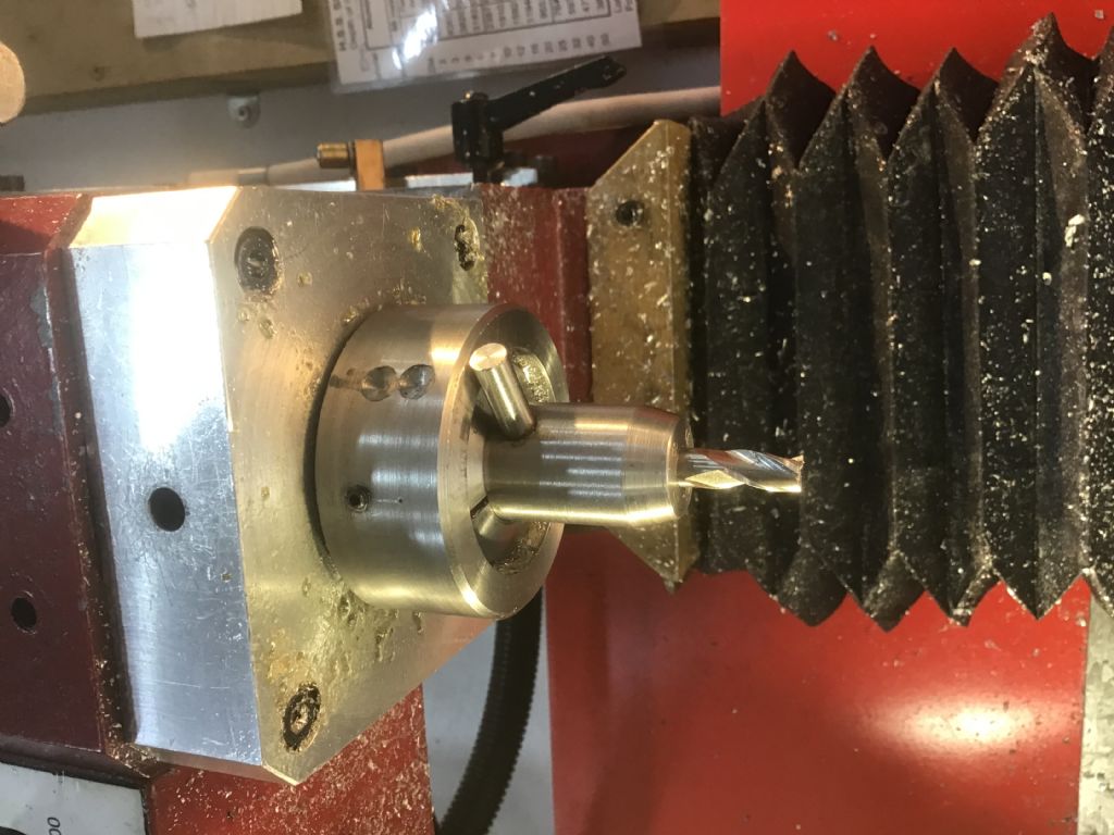

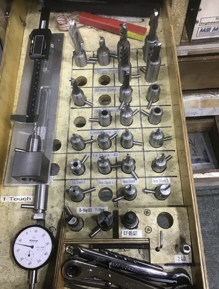

        For my sx2 p cnc conversion I used the R8 spindle this was used with a 3/4 collet and the cutters are mounted in 3/4” silver steel chullets. They are very very carefully clocked in the 4 jaw then drilled, bored and reamed for the cutters held in place with 2×2 ba grubs. Height location is with a 5/32 silver steel bar registering against a machined ring ( in situ) on the end of the spindle. Photo 2, offsets are set off machine in a dedicated setting device seen in photo 1 . It’s highly accurate and the silver steel cost little from a specialist supplier near Harrogate
        The advantage of this system is it is ridiculously cheap and has a very very small extension unlike many er chucks , and as Ketamine says, the sx2 is a mini mill and thus the more we can help it the better

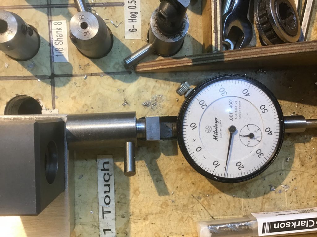

        The height is set with the dti device in photo 3 it has a length of 115 mm when the clock reads zero when in contact with the work

        once the cutters are fixed in their holders the size is recorded from the setting jig in the Mach 3 tool table, and in addition into Fusion 360 which I ciponstantly use for 3D cad and cam code production.
