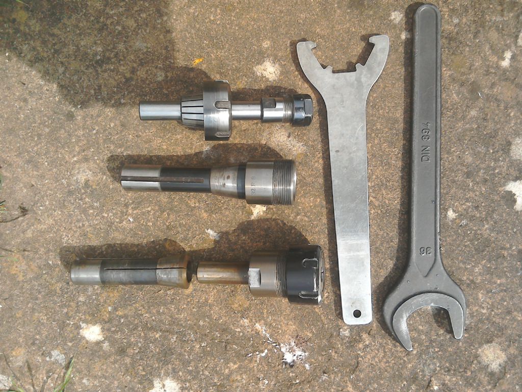

        Hello,
        I plan to buy a Sieg SX2 mill, but normally i comes with a drill chuck, and it is not good for milling, i heard
        Therefore i would like to buy a Collet chuck instead, with a selection of collets, ea 4 mm to 12 mm, or something like that.
        In the meantime i am in doubt over all the different numbers used to specify dimentions on the chucks, so it fit the spindle on the Sieg SX2.
        Therefore, can anyone tell me what collet type (dimentions, numbers, ect) i shall look for so it will fit the spindle in the SX2?
        Also, have anybody recomendations to a good set with such a Sieg SX2 compatible collec chuck, with a selection of chucks, from ea Banggood, or Aliexpress……or shall i not buy such tool there…..on the other hand, this is only for hobby use, and i am a beginner….?
        Thanks for all advices.

          If it is a new SX2 and you are in heh UK then that will be coming form Axminster and comes with a No3 Morse Taper spindle. If it is the SX2P (Plus) you are thinking of from ARC Eurotrade then they have an R8 Taper.
          In either case you have tow options for collets.
          1. Direct fit finger collets that fit straight into the spindle taper, these give a bit more head room as they do not really protrude beyond the end of the spindle but you need one size for each diameter you intend to hold.
          2. Use a collet chuck that has a shank to fit within the respective spindle taper and then get a range of collets to suit that, The ER type collets would be the usual choice and on that size machine ER20 if just being used for tool holding or the larger ER25 or ER 32 if you also want to use them for work holding in the future. Each of these collets will hold a small range of sizes so you could also hold a drill bit or imperial cutter in the right size collet for example 9.8mm drill or 3/8" cutter will fit a nominal 10-9mm ER collet.
          Source I would say go to a known hobby supplier as direct from China can be a gamble and easier to deal with if you have any problems. A typical ER25 starter set, you can add more collets as needed and the equivalent MT3 shanked one.

                        MT is Morse Taper. It has been around for a long time and is often found on larger drills. It comes in different sizes from MT0 (small) to MT7 (large). It is good for drills but not so good for milling. As a result when Morse Tapers are used for milling they require a drawbar. This is like a long bolt that pulls the tooling into the spindle to act against milling forces that loosen a standard Morse Taper. The problem with Morse tapers is that they can cause problems when trying to remove them from their socket. There are a number of threads on this forum regarding stuck tapers.
                        The Bridgeport Company wanted something to replace Morse Tapers so they designed the R8 taper. This still uses a drawbar to pull the tooling into the spindle but is easier to release than Morse tapers.
                        There are many other tapers available due to limitations with R8 as well such as ISO30.
                        Morse Taper and R8 finger collets are made with slots in them that allow the collet to close onto a parallel shank of a tool and grip it when the drawbar pulls them into the spindle. The fingers are fixed at one end so the grip inside the collet is not as high as it is at the end where the fingers can move. This means that these collets need to be closely matched to the diameter they have to hold. A 1/2" collet (Ø12.7mm) will not grip a Ø12mm tool as well as a 12mm collet. The result is you may end up with a lot of collets for each size required.
                        ER collets are split from both ends in alternating positions and have two angles for the holder and the closing nut. This gives a more parallel squeeze and so the ER collets can hold a range of sizes. For instance you can get an ER32 collet that will hold tools from Ø13mm down to Ø12mm. Smaller ER collets such as ER11 have a smaller size range. The size for an ER32 is nominally the outside diameter of part of the collet, not the size of tooling it can hold. ER32 typically holds up Ø20mm for example.
                        To use an ER32 collet (for example) in a mill with MT or R8 spindles you need an MT to ER32 collet chuck or an R8 to ER collet chuck and ER collets to go into the ER collet chuck. You only need to buy the collet chuck that suits the spindle of the machine you end up with.
                        You can also buy an ER collet chuck with a parallel shank and fit it into a finger collet that suits your spindle. Here are some typical examples of ER11 on a parallel shank that can be fitted into a larger ER collet or finger collets. An R8 to ER32 collet chuck. An R8 finger collet with a parallel shank ER32 collet chuck.
                        Hope this helps.

                                                  I opted for er25, it goes up to 16mm. If you intend to use er collets on the lathe with a mounting plate as well as on the mill, then er32 would be a better choice for both machines to share.

                                                    The SX2 spindle is usually MT3 or R8.
                                                    So, depending on which version you buy/get from Globaltools.dk, consider:
                                                    MT3 – ER25 chuck system or
                                                    R8 – ER25 chuck system
                                                    If you want to buy variable quality of such collet systems – consider the Banggood route. You will not get any links on here as this has been kept off discussion – read Code of Conduct link
                                                    Generally, for re-sell value, SX2s with R8 spindles are better, and also considered better for cnc conversions. To understand, read a book, or do some research.
