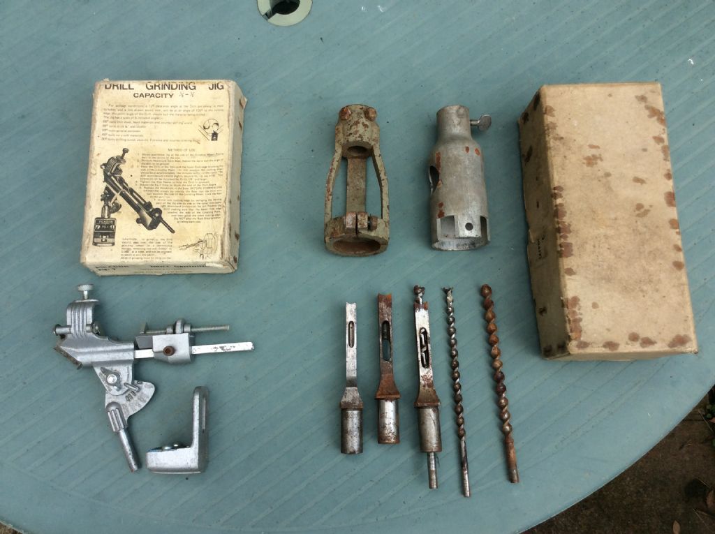

      Hi
      Just clearing out old tools and there’s a couple of boxed items, one of which I don’t have a clue what it is (right of pic).

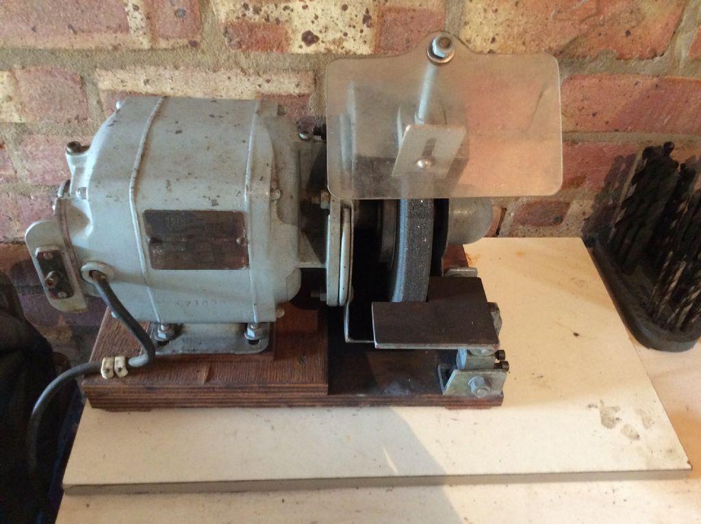

      Not sure if I need the drill jig on the left. I have a grinder but don’t know how to fit this on or if it would be any use.
      Just thought I’d check before throwing out.
      Any help appreciated.

          Hello,
          Bottom right are mortise chisels and bits, for making mortises in timber, not cheap for quality ones.
          The two items above them, are yokes/adapters, to fit the chisels to a pillar drill.
          Mark.

            Cannot see a makers name on the drill grinding jig but it looks similar the General or Draper or Picador ones and very useful if you have never been shown how to grind drills using the freehand method.
            The other items are for making mortices in woodwork. The drill removes the bulk of the wood and the square part acts as a chisel to produce a square hole which can be elongated to produce a mortice.
            Neither are worth a fortune but I'm sure that an entry in the classifieds on here will produce a small profit.

              Dan
              Tools on the right are a mortice chisel set to use with a pillar drill. Drills go down the middle of the hollow square chisel which follows the drill down taking out the extra to make the round, drilled, holes square. Two adapters provided to hold the mortice chisels, presumablt different sizes to fit different drill quill diameters.
              Drill grinder is an original Picador which works well once you have got the knack of setting drill angle and projection as per the instructions. Follow the book don't be tempted by different advice all over the internet, You Tube and forums which pertains to poorly made copies of the General / Spiralux design whose geometry is different due to the pivot spindle being at an angle rather than vertical as in the Picador.
              The jig is fitted to the bench on which the grinder stands pointing at the side of the wheel as per the sketch in bottom right corner of the instructions. The slot in the foot is provided so distance between grinder and drill point to be adjusted as needed. Needs a wing nut or similar easily operated clamping device.
              The jig was very much made down to an affordable price so certain things are not as good as they mich be. The foot mount could definately satns some improvement. Needs some sort of guide so you can slide it straight in and out. I made as separate carrier for mine with a 3/8" thick steel base and 14 gauge side plates to rigidly guide it. Should have put a screw on to for accurate positioning. But I managed well enough for 30 years or so.

                Thanks for the replies. Yes the jig is Picador.
                I have a home made grinder so could try and figure out how to fix it on.
                I need to get a drill of some kind whether it’s floor standing pillar, bench mounted pillar or hobby mill. I don’t think I’d be doing much joinery though so might sell the mortise stuff.

                  I used to have one of those drill grinding attachments fitted to the bench just to the left of the grinder. The grinder in the picture, being right handed and not double ended would have difficulties mounting. When I sold my house, I left the grinder, drill sharpener and a 4" Paramo vise bolted to the bench. I miss the vise.
