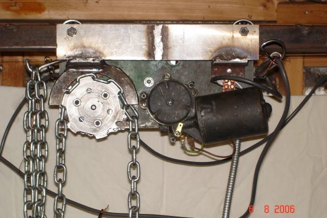

                                              The old (1960/70) Lucas motors seem quite happy in either direction, these ones also have wound stators instead of the modern ones with permanent magnets. Another motor that I run is from a garage door opener, it's a 36 volt type, it is the motor on the hoist above my lathe.
