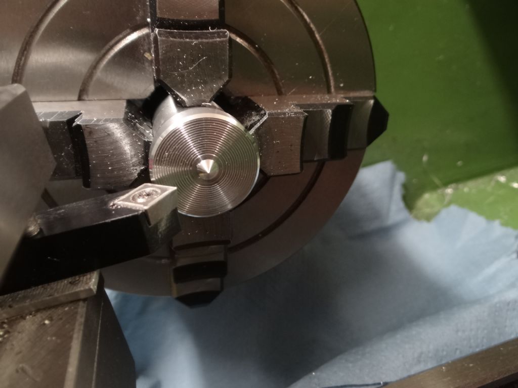

      Today I have made a 6 degree internal tapered cone in mild steel. 1.4" at wide end of throat. The finish is rubbish. The boring bar is only a small 12mm one that came with the lathe, but I have fitted a new tip & that is in good nick. Not sure if I set it right.
      The tool tilts down to the left. At the tip point, is this the centre of my work or not. I tried various speeds ranging from around 250 right up to 850. At about 400 it chip broke pretty good so left it at that. I tried taking it in very slow & must have been too slow at one point because it started to rub.
      I took 10 thou per cut. Tried 5 but same. Anyway see pictures & if anyone can help. Much appreciated.

                #456519
                  Posted by Steviegtr on 10/03/2020 19:05:41:
                  … The finish is rubbish. … Not sure if I set it right.
                  The tool tilts down to the left. At the tip point, is this the centre of my work or not. …
                  Good to eliminate problems one at a time!
                  I set the tool height using either a length of rod faced carefully to centre height as a gauge or the steel strip method as per photo. Sorry it's sideways!
                  The steel strip is pinched between the tool tip and a rod. If the tool is too high, the top of the strip moves away from the operator. If too low, it tilts towards the operator. The tool is centred correctly when the strip is vertical.
                  When facing, adjust tool height until there's no pip, or deliberately make one so the point can be compared with a centre in the tailstock:
                  If still not cutting reasonably with the centre-height correct, it might be the material: ordinary mild-steel isn't wonderful. En1a-Pb machines much better.
                  Other possibles, 850 rpm is too slow, the bar tends to chatter because it's on the slim side, and/or a sharper insert is needed.
                  I think I mentioned in another post that running before one can walk isn't the best way for a beginner to start! In this case, boring an internal taper is harder than boring parallel. Once boring parallel is mastered, it's easier to spot what might be going wrong with a taper. And one shouldn't be boring until plain turning is mastered.  When still at the unsure about tool-height stage, keep it simple. Only move to trickier jobs once reasonable results are achieved with the basics.
                  Edited By SillyOldDuffer on 10/03/2020 20:38:28

                  Mick B1
                    @mickb1
                    The wall thickness at the mouth is low, so it won't support much depth of cut without chatter. If the insert can do it, I'd try a very shallow cut of only a couple of thou or so. When you hand-feed with the compound slide, use the other hand to brake the handwheel so as as to keep up an even feed, and swop hands when you have to without actually stopping.
                    Me, I'd use a dead-sharp 1/8" or 3/16" HSS toollbit in a 1/2" boring bar, but I guess we all have our favourite ways of doing things.
                    Ah, one other thing – you've probably checked this, but is the compound slide gib properly adjusted to minimise play without binding?
                    Edited By Mick B1 on 10/03/2020 20:46:21

                    Dave Halford
                      @davehalford22513
                      Tip radius looks big, if the last two numbers of the six on the box that begins TPMR or TNMG etc are 08 it's a roughing tool. You need 04 or 02 for finishing

                      Anonymous
                        Three things:
                        1. The insert may be new, but where did it actually come from?
                        2. The screw holdng the insert looks odd; they're normally Torx rather than slotted, and the countersink is not standard so an ordinary screw won't work
                        3. I adjust the gib on the compound to be slightly loose if anything, so there is no hesitation when feeding
                        Andrew

                        Ian P
                          @ianp
                          My introduction to lathe tools with carbide inserts was about 15 years ago when I bought a toolholder with 10 tips at a local steam rally, I was instantly converted!
                          I then bought a set of five tools with inserts from a well know supplier. The tip were pure rubbish, if the purchase had been my first introduction to indexable tooling then without doubt I would have been put off for life.
                          Point of me mentioning this is that the tip in Steve's picture looks to be identical to the ones supplied in the set I mentioned, they have the same dull grey look and the same parallel 'gutter' around the perimeter.
                          Ian P
                          PS, I did not know much about tips when I made my steam rally purchase but I now know they were the fine grained polished type for machining aluminium and plastic. (which I now use for 90% of all my turning)

                          Steviegtr
                            @steviegtr
                            Thanks for all the replies. I will check that insert tomorrow. It came with the lathe???. I have some more that a friend got from an engineering company when it closed down, so they may be better. They are gold coloured.
                            I did adjust the gib when I started, as I was going to do a 3" pass so needed full travel. It was a tad loose, but I tightened it up a bit. I do need to make a variable speed feed drive for it. List of many things to do. + 1 for the Y axis on the milling machine once I get it home. Strangely 2 weeks ago I made a coin ring self centering punch, which entailed turning an inside taper in stainless. See picture. It worked out great. Unfortunately as advised, most of the projects I have on the go are turning internal tapers. Mainly in stainless steel.
                            The hand wheel smooth operation I have sort of got but by the end my fingers were aching. So from feedback some of the things I need to do is speed up the machine as 800 is too slow.
                            Check the insert or get a bigger boring bar asap.
                            Check I am on centre.
                            The tool height bit I always check against a centre in the tail stock. But the reason I asked was the boring bar has a tilt on the end, confused me as to which part had to be centre.
                            Slow down, try harder.
                            Thanks again for all the help. I will go through everything again tomorrow. Here are the ones I have if anyone can identify them for me. Regards. Steve.new punch round.jpgnew punch.jpginserts.jpginserts 2.jpg

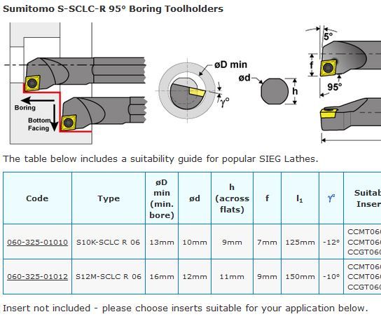

                                          Ketan Swali
                                            @ketanswali79440
                                            Steve,
                                            Before you consider buying a new boring bar, you may wish to consider some of the suggestions already mentioned earlier, in particular about increasing the lathe speed, and cut smaller depths of cut, keeping a positive steady feed.
                                            Also, you need to be aware that:
                                            • the cheaper boring bars, regardless of from where you buy, are subject to flexing, resulting in a tapper in boring operations involving a deeper hole. The more expensive bars – such as those made by Sumitomo – used for more regular industrial repeat operations are less likely to flex. We have a musical instrument restorer working near buy, who has tested both types for us, on his Myford Super 7, and these comments are based on his and others findings. He uses the Sumitomo 10mm and 12mm boring bars.
                                            • The more the bar is held outside the body of the holder (for deeper hole boring), the greater the chance of chatter, based on a variety of factors, so locking down non-moving components/axis, can help – as explained by Jason.
                                            • If you are considering the 16mm diameter bar, on the one hand it may reduce the chance of flexing, but you will need to check/figure out if it can be held securely in your tool holder/tool-post, with the cutting tip height locating centre to the work, as suggested by others. Do consider the type which are flat on the top and bottom of the bar. Is the bar you are using ‘fully round’ or is it flat on the top and bottom?
                                            Looking at the picture, it appears to be flat on the top and bottom. So the round area of the bar does not locate in the locking area of the tool post/holder. That round area would make the whole diameter of the 12mm boring bar you are using to be between 15~16mm – at the cutting head.
                                            If you are considering a 16mm boring bar, where the flats may be 16mm, if it fits in your tool holder/tool post, the cutting tip of the insert may not be able to be adjusted in height to the center line of the material you are boring. Have a look at this snip it picture below from this page link , which may help you to understand:
                                            Ketan at ARC.
