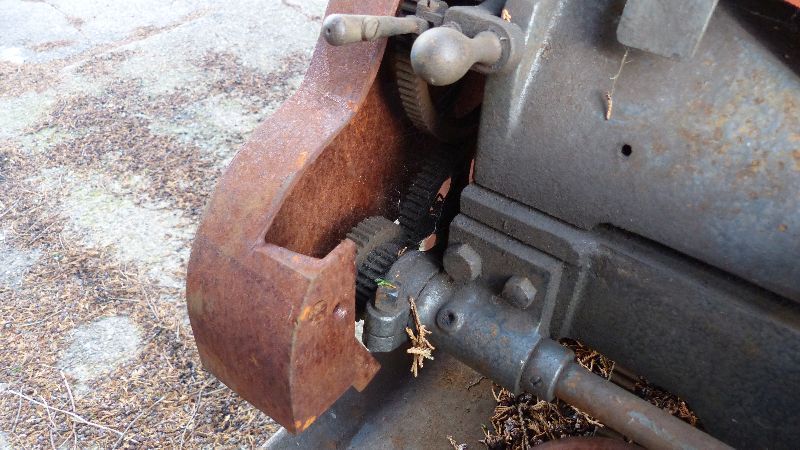

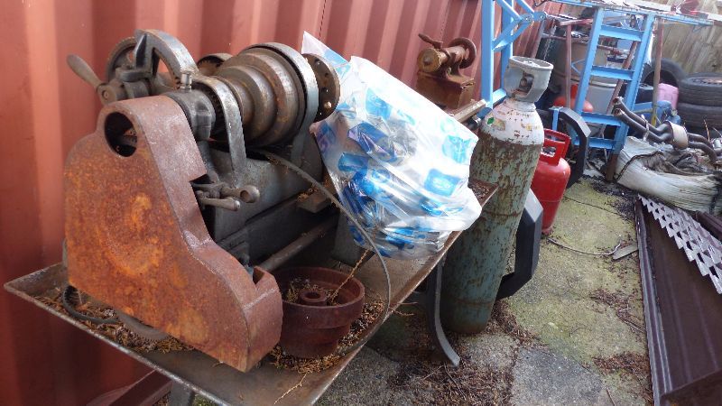

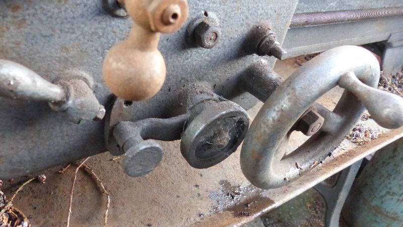

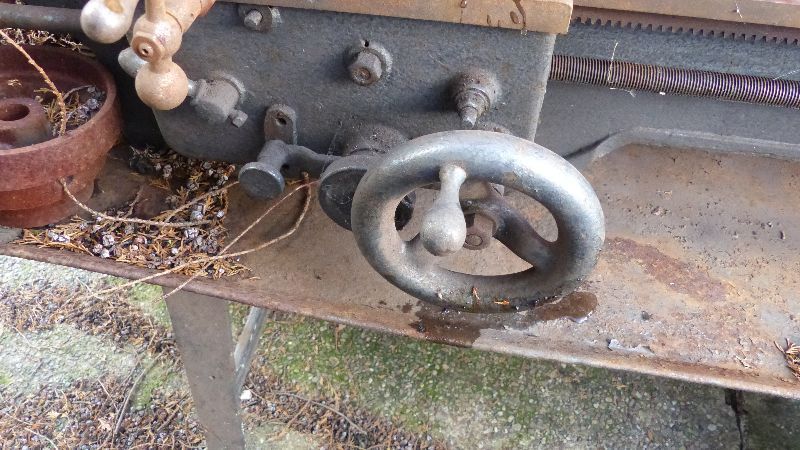

      Spotted this Lathe at a Friends yard the other day, can Anyone help Us identifying
      it's Make/age?
      Many thanks Morty

          Southbend maybe?

            It certainly has the look of the Southbend, apart from the apron layout and tailstock design.
            A good starting point, many thanks!

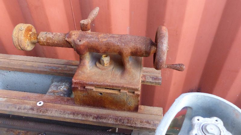

              Definitely not a South Bend. Even their first lathes had the half nut lever on the right and I can't think of any South Bend that didn't have double vee-ways for the apron. Plus the saddle would be much nicer rounded corners and matching the contours of the apron.

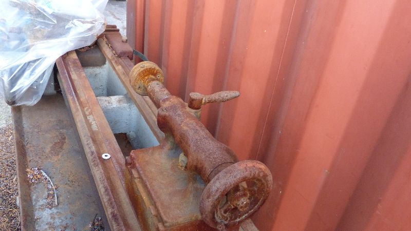

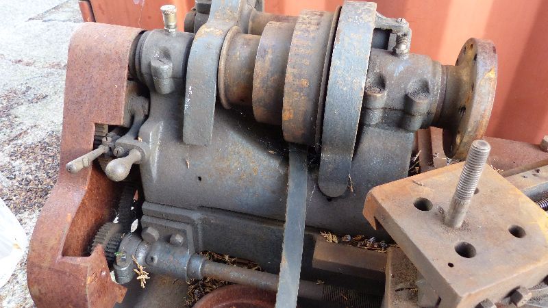

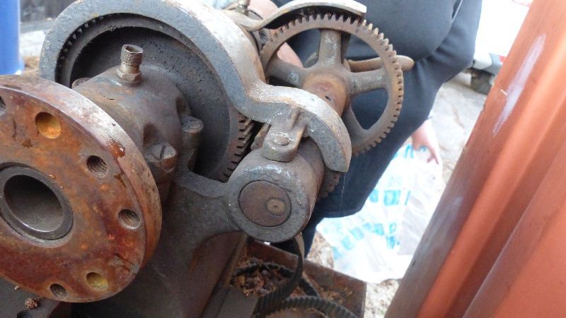

                Might be a high end wood lathe, funny headstock with cheese head screws for the bearing caps on BOTH sides (which is not very strong) and a huge bore
                weedy tailstock
                Flat belt drive 20s 30
                edit: Must be a 1890 to 1920 type of metal lathe, in which case it's in nice nick for its age
                Seems to be the conventional type of build they used back then

                  Maybe some measurements would help. It is a bit difficult to judge scale from the photos. If you can remove the backplate from the spindle, the spindle thread would narrow down the list of possibilities.

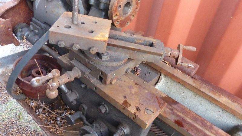

                    The lead screw pitch looks, to me, as though it is very fine 10tpi (or even 12?)? Doesn’t look ACME, either.
                    Tailstock looks out of place. Unless that tiny hole on the side is for lateral adjustment?
                    Could it be a pre-cursor to the V bed?
                    I would think very early in the last century, at the latest. No idea on a name.

                          FWIW some of the features (the bed,(edit -or maybe not)  the tailstock, the apron) look passingly 'Britannia'-ish…

                            I once owned and used a very similar machine, some 60 years age, still an apprentice and bought from a the local scrap dealer. Had it running in my dads garage from a lineshaft. Eventually gave to a pals pal ! NDY is spot on with the date IMO
                            Defiantly not a wood lathe, it has a tumbler reverse for the change wheels, half nuts on the carriage, left hand side lever and the central lever with two holes is most probably power feed to the lead screw or cross slide. From memory mine was a 10 TPI lead screw. Make — no idea but it did have a plate on it with reference to WW1 and may have been American origin ? i’ll Ask my pal if it’s still around

                              If the thread of the spindle nose could be measured, it would be a valuble clue.

                                the apron central control in the first pic, which I assume changes the feed from sliding to surfacing has an offset arm leading to a pull out knurled pin which slides between two positions. this is very similar, indeed almost identical to the detents on my Holbrook B9, and also the back gear handle in the same location and same shape, could it be an earlier (circa 1900) Holbrook?
