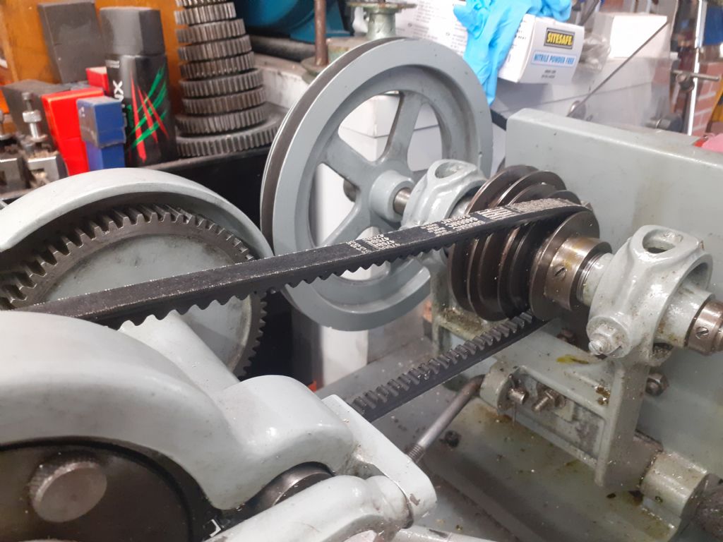

      The top speed of my Myford M type is meant to be 840 RPM. I tested it today and found it is 600 RPM.
      The motor plate states 1425 RPM.
      I do not wish to change the large countershaft pulley which is 8.25" dia.
      So I'm thinking I can increase the motor pulley which is currently 1.75" dia.
      Having looked on line at cast iron pulleys (I don't want Ali) I currently have two pulley options for the motor. One is 2.25" dia, the other 3.25" dia.
      As my arithmetic abilities are less than great, could someone please advise which is likely to be my better option to increase the top speed by around 240RPM?
      Chris.

            As Hollowpoint says, 2.25 is the better option on the face of it. The arithmetic says 2.45 ins PCD is needed, so 3.25 is a step too far.
            The arithmetic is simple enough – new pulley dia = 1.75 x 840/600 = 2.45
            But I'm profoundly suspicious that all is not that simple for the speed to be that far off the mark. Lathes.co.uk says 874 rpm is the top speed, and 600 rpm is the next speed down. Seems a bit basic, but are we missing a trick here?

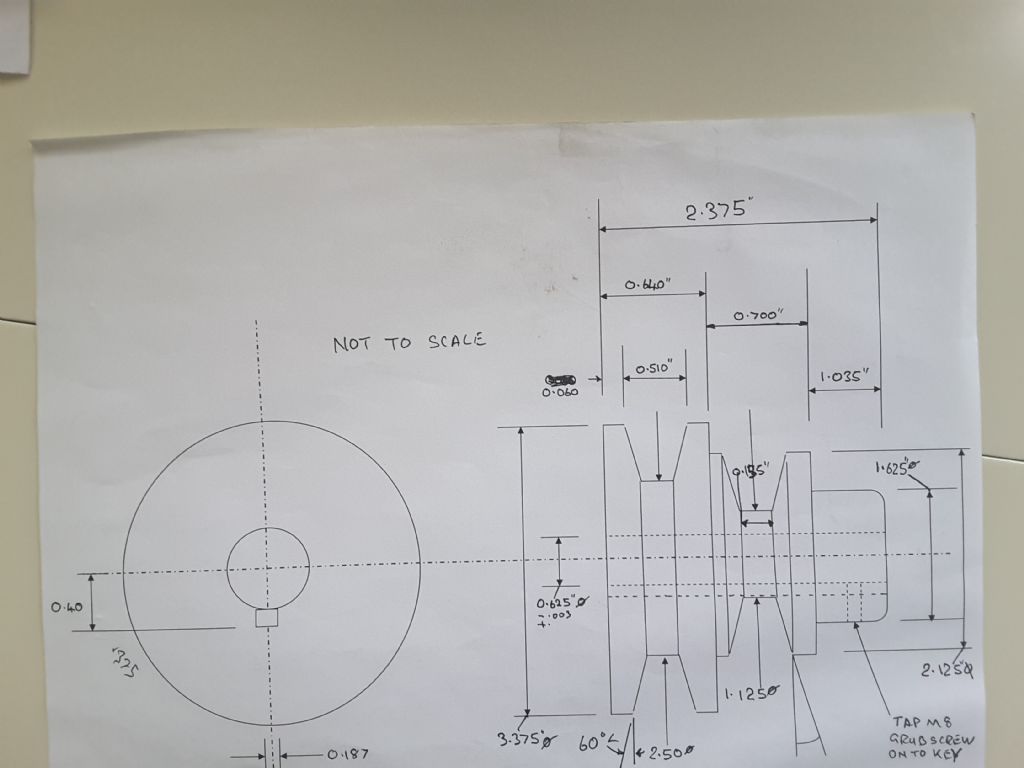

                              David George 1
                                @davidgeorge1
                                The original pully sizes are motor pully 3 3/8" and 2 1/8"
                                Intermediate pully 8" and 9"
                                This is the pully drawing for the motor I made.
                                David
                                #527223
                                Chris V
                                  @chrisv
                                  Ah thank you David, that's good to know for reference!

                                      #530045
                                      Chris V
                                        @chrisv
                                        Feedback! (-: Success!
                                        Once the supplier re sent the correct size pulley that I'd ordered ie 2.5" I bored it out this morning and fitted the new belt. Checked the top spindle speed and its 860 RPM, quite noticeably faster, so job done.
