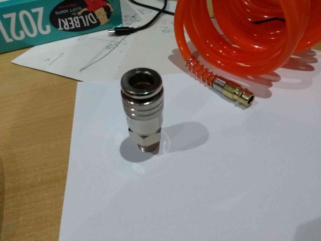

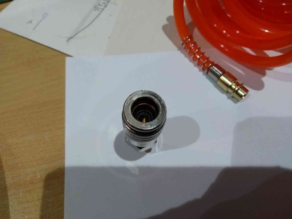

                            #515650
                            Iain Downs
                              @iaindowns78295
                              I thought I'd posted an update before this, but it would appear not.
                              In the end I have bought both. An 8 inch rotary table from a forum member (and very nice it is, too) and the KIEI compressor mentioned in an early post.
                              The compressor ended up being on sale for 30% off on 'Black Friday' coming in at around £180 which I thought was a decent price – especially if it delivers to the specs.
                              But right now, I don't know. Why not? because utterly NOT to my surprise, the compressor comes with an outlet connector which doesn't match the input connectors on the kit I bought at the same time!
                              Here's what I've got.
                              The compressor connector thread appears to be 1/2" BSP. Which is to say that a die with that stamped on it screws most of the way in (and similarly on the female thread -and the diameter of the thread is about half an inch). However, the thread appears to be tapered in some way in that i can only screw it about 2/3rds of the way in (and it appears slightly conical to the naked eye).
                              I don't know if I should try and buy replacement connectors for the compressor (to fit the tools) or if I should try and buy adapters (the compressor is dual outlet).
                              I have spent a bit of time asking the internet and haven't really ended up with a clear answer. I've also spent a bit of time in Screwfix with a young man who wanted to help but had no idea at all!
                              I'm clearly expecting much better things from the forum than the internet!

                                Oh – and the compressor comes with almost incomprehensible (and badly spelt – even by chinglese standards) instructions, which don't even bother to tell you how to put it together. I've probably done it wrong.
                                I will let you know if it compresses!
                                Iain
                                #515653
                                Iain Downs
                                  @iaindowns78295
                                  Further investigation reveals that the BSP with a diameter of around half an inch is a quarter inch BSP. Clearly I had a reality jolt when I read the die.
                                  I also find that BSP Tapered is a thing, so my guess is that this is what I have on the compressor
                                  Iain
                                  #515654
                                  Nick Wheeler
                                    @nickwheeler
                                    Bin the fittings it came with and replace them with standard PCL ones that are available anywhere
                                    #515658
                                    Steviegtr
                                      @steviegtr
                                      Iain, BSP threads come in 2 types. Parallel or tapered.
                                      As above the PCL fittings are a pretty much industry standard & reasonably reliable.
                                      Steve.
                                      P.S. As NDIY says male only.
                                      Steve.
                                      Edited By Steviegtr on 27/12/2020 13:41:51
                                      #515662
                                      not done it yet
                                        @notdoneityet
                                        All female BSP are parallel. The male threads could be either. Low pressure is often taper (fitted with a filler and jointing compound or with PTFE tape. High pressure installations usually include a rubber inserted washer as the seal (Dowty washer).
                                        #515665
                                        Clive Foster
                                          @clivefoster55965
                                          Either PCL or Euro type will do just fine and are easily obtained. Yours look as if they should be Euro.
                                          If you are a LiDL shopper an advantage of the Euro type is that they periodically do air tools, accessory kits, airlines and sets of connectors of very acceptable quality at economical prices usuing Euro connectors. Good way to get extra equipment. Especially as the prices make "I will only use it a few times." purchases viable.
                                          LiDL prices mean I'm slowly switching from PCL to Euro. Too much invested in PCL to be worth the switch at proper trade supplier prices but its viable at LiDL ones.
                                          The Euro style ones have a larger through bore than PCL so theoretically pass more air at a lower pressure drop. Which may be important for blasting and similar. Must get round to changing the connectors on my blaster to see.
                                          Chinese air connector threads can be obscure, crazy or both. I found one that measured as being Admiralty (obscure) but I suspect it was supposed to be American and the copier cocked up (crazy).
                                          Clive

                                              #515676
                                              Dave Halford
                                                @davehalford22513
                                                Ian,
                                                Most air fittings are straight, use PTFE tape. The coiled hose will drive you mad and restrict your flow as well.
                                                Don't forget to fit a filter regulator to replace the joke one and a decent on/off tap.
                                                You can get BSP black iron fittings at your local plumbers merchant

                                                  #515686
                                                  old mart
                                                    @oldmart
                                                    Loctite make an excellent pipe joint product, 577, where PTFE tape is difficult to apply.
