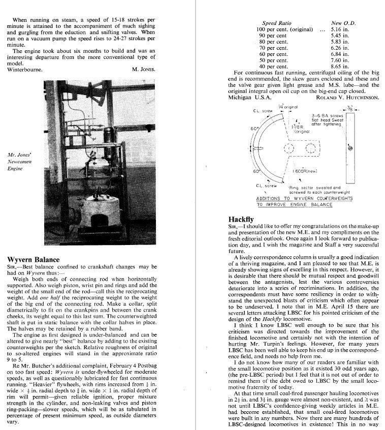

                        Early this year I bought a part completed Wyvern engine and I have now got around to finishing it off.It came with a set of plans and the Westbury ME construction articles apart from 1st May 1963 page 16, can anyone help with this missing page?
                        I have the ME magazines with Peter Rawlinson's build articles in which he mentions a letter in ME 3300 1st July 1966 which he recommends reading,can any one help with this as well?
                        In John Purdy's list of drawing errors he says the timing drawing should be revered to give CCW rotation, is this the normal direction as I have seen videos showing CCW and CW rotation?

                        #364572
                          I can dig out the 1963 if no one else can easily lay their hands on it.
                          This is the 1966 letter, click to enlarge
                          Most open crank engines have the top of the flywheels moving away from the cylinder, makes it easier to start by flicking the flywheel over by hand.
                          camshaft is just 1/4" dia, PGMS or Silver steel.
                          Edited By JasonB on 29/07/2018 19:51:19
