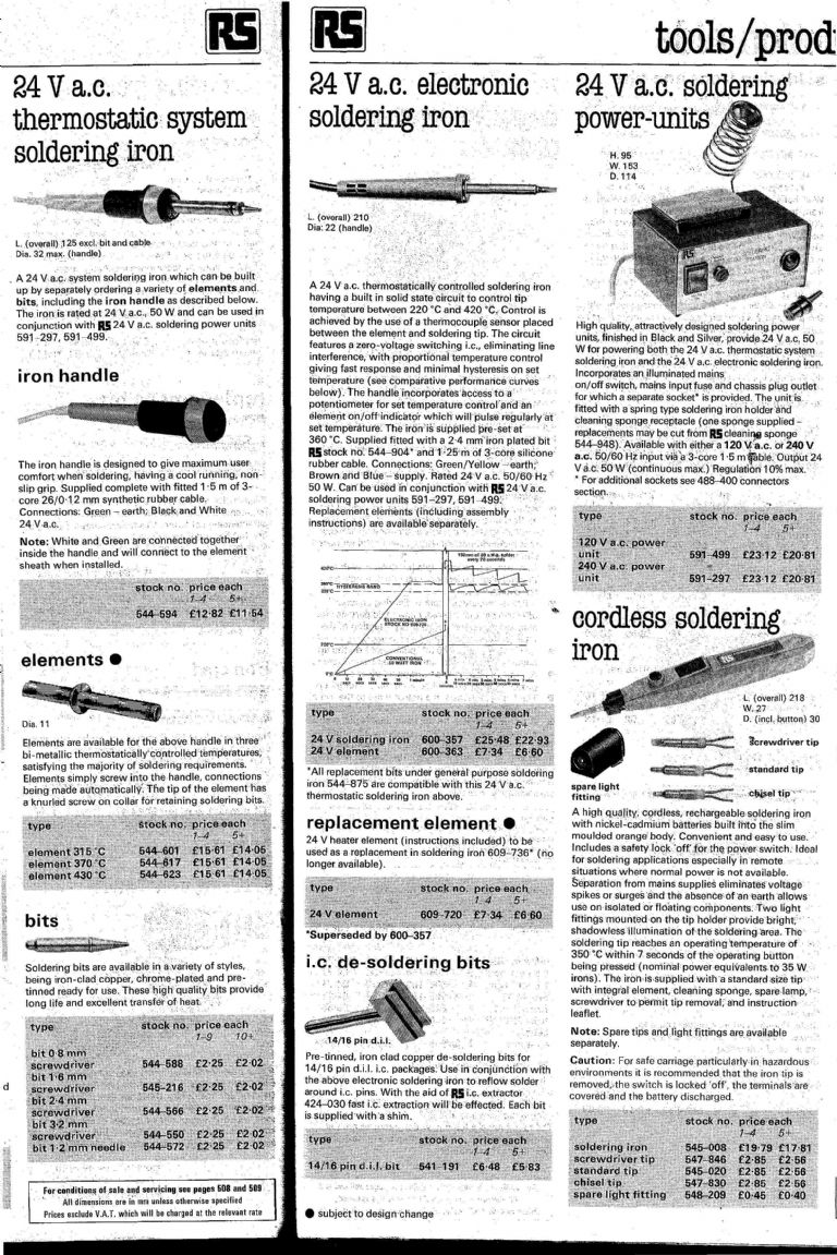

                                  Like Robert, I have a couple of older RS single volume catalogues, from 1984 & 5 in my case.
                                  They also show the item codes as above, and also list all item codes in a purely numerical index at the rear, which sent you to the page number.
                                  I seem to recall that in later catalogues, or maybe the CD versions, there was a second numerical item code index, which listed the manufacturer.
                                  If anyone has a copy of a later catalogue, or is able to read the CD, they might be able to come up with a maker.
                                  As far as I can tell, it's a plain iron coated bit, but with a little hemispherical bobble on the inner end, unlike Weller Magnastat, or some of the Antex temperature controlled ones.
                                  The other good place to ask might be Vintage Radio Forum, who have a number of old school and helpful members. https://www.vintage-radio.net/forum/
                                  Not the best of scans, but this is the relevant page from the 1985 catalogue;

                                        By 2004, the iron had dropped out of the 7 volume RS catalogue, but there were a couple of Ersa items listed with a similar colour.
                                        It doesn't feature in the 2001 CPC paper catalogue either.
                                        It would appear to take plain iron/chrome coated copper bits, so other manufacturers' ones might be adapted, depending on the size.

                                          I have a Weller soldering station and one by RS as shown by Bill peak4 above, On my RS one, its says some where made in US, same on the replacement tips. I've been using the RS type this morning, fixing Christmas tree lights Since RS stopped supplying them, I've got my spare tips via Ebay. Certainly Vintage Radio Forum will know but they advocate a much more costly soldering station. John
