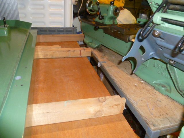

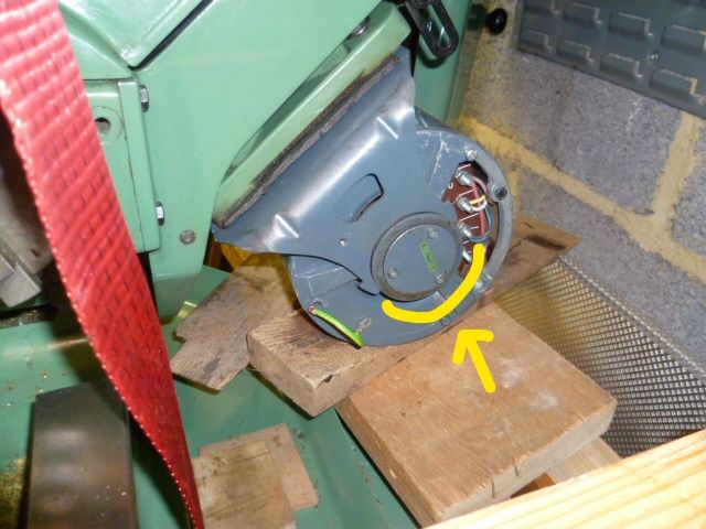

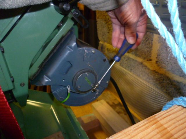

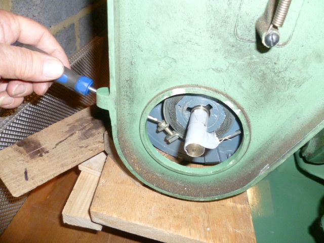

                      I hope this is a sensible place to post this. As already pointed out handling/moving an inherently unbalanced Myford with the motor still attached is asking for trouble. Adjusting or removing a motor unit with the lathe up against a wall is a total pain.
                      If the motor is the usual B56 resilient mount type it is possible to remove the mount clamp arms at each end after supporting the motor casing on packing boards/folding wedges and then drop and slide the motor out to the right, in the tailstock direction, with relative ease. The clamp arm pairs at each end are secured with a single machine screw and semi-captive nut. (This procedure assumes the motor pulley is not in place.) Removing the motor this way rather than removing the frame securing bolts retains the frame alignment and belt tension set up on the motorising board.
                      The pictures show an S7B on a transport trolley alongside the new bench location waiting to be slid across on to the timber bearers. This is up against the workshop wall. The empty B56 mount arms are at the top of the pic. The subsequent pictures show the motor casing packed up with timber boards into the waiting frame arms. Lifting the motor up into the arms while slipping the boards underneath is the hardest part. Folding wedges applied in opposing directions help here. The motor retaining clamp arms are then hooked over the frame hooks and clamped together with the screw/nut before finally removing the packing boards.
                      If the electrical cables are long enough they can naturally be left in place whether fitting or removing the motor. Apologies for the pictures being a little posed and “Haynes Manual” style. Simply a shortage of hands to hold the camera comfortably! The intention is to show there is easy access to re-assemble and tighten up the clamp arms at both ends of the motor.
                      Peter

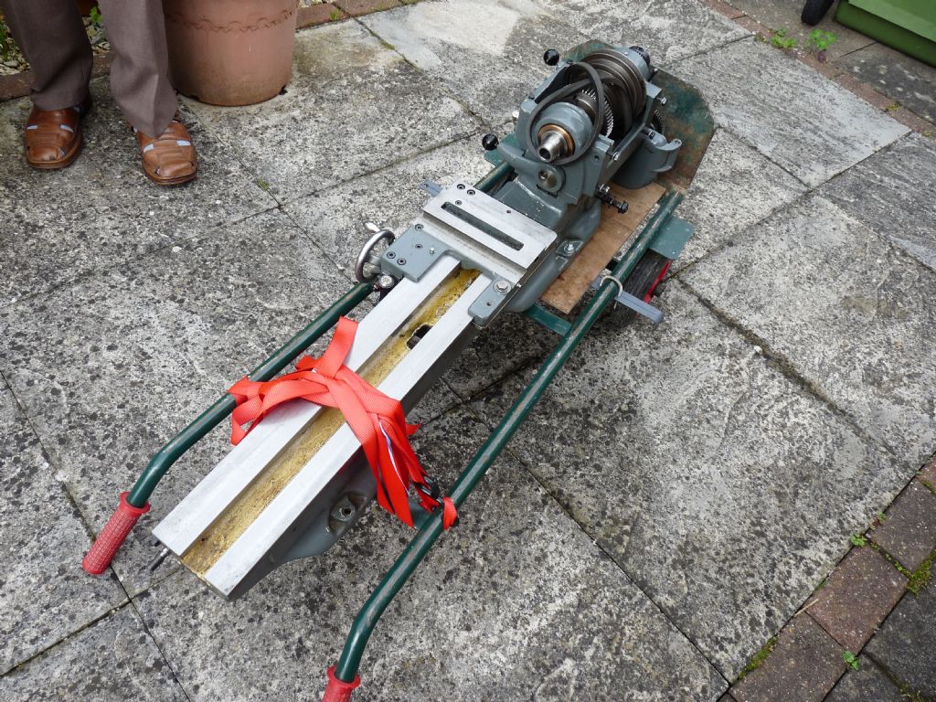

                        It is way beyond a door stop Nick but it can be handled by one person.
                        I bolted mine to some 2m long wooden beams with a castor at each end (about 5"x 2" section). I used the beams to 'lever' the lathe out of the car and onto its stand.
                        I won't do that again because it was mad but it can be done. The main snag seems to be its relatively fragile belt guards and its awkward shape.
                        Phil H
