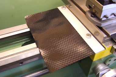

      Some while ago, I looked for and bought some 'accordion' strip to cover my mini lathe ways. It has never been satisfactory because it is too stiff and too light so it will not stretch / compress enough, whatever length I choose for it. It just rides up and the chuck hits it.
      I have read that some people are over the moon with what they have bought and I need to source 'what they're having'. There's a lot of stuff available from China at a reasonable price but, from the images, it seems to be the same woven structure that I have already. If it is a bit flimsy, that doesn't matter as I can replace it every so often.
      I'm sure some ME members must have the right stuff. Where did you all get it?

          I have tried a lot of stuff on my lathes.
          On my mini lathe I use some old (new once are to stiff) jeans cloth bolted to the carriage and magnets on the head stock.
          On my bigger lathe I have a piece of wood under the chuck mounted to the carriage using magnets. The cross slide is also covered by jeans bolted to the cross slide on one side and magnets on the other side.

            The equivalent on my Myford vertical mill is just a sheet of butyl-rubber pond-liner, an offcut from making the pond.
            It's held by aluminium strips and screws using the tapped holes that presumably once held the original shields. (The machine is second-hand.)

                      I just have a length of plastic DPC material on my WM250. It just bows up a bit if working very close to the headstock. Makes it a little easier cleaning up and stops most of the swarf getting under the saddle.
                      The bolts also serve to prevent swarf getting into the threaded holes for the travelling steady.

                        That's basically what I've ended up with – a short length of the concertina on the cross-slide. It's always in the best place to catch most ofd the swarf. I reckon it's definitely better than nothing so I'll stick with it.
